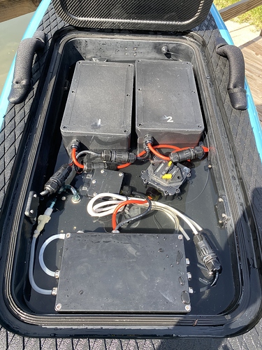

Now I use two Polycase DC-96F cases. I basically just entombed my battery packs inside (and sealed since they weren’t IP6x certified) and have a positive and negative lead coming out cable glands. But it fits PERFECT inside the Lift board. Only thing I wish was I only had one case to contend with rather than two. So I end up having to have two small junction boxes to combine the two positive wires and the two negative wires.
FINAL RESULT:
@Flightjunkie this is what I ended up with. Works well.

Nice clean design! Great job!
Is your Lift board compartment 100% waterproof? Mine is now with the 3M VHB tape on the hatch side. Haven’t had a drop of water in the last several rides, playing in the surf and everything.
No! It looked like this after 30 minutes of riding (but I didn’t fall so I think it was just in there from initially being under water):
