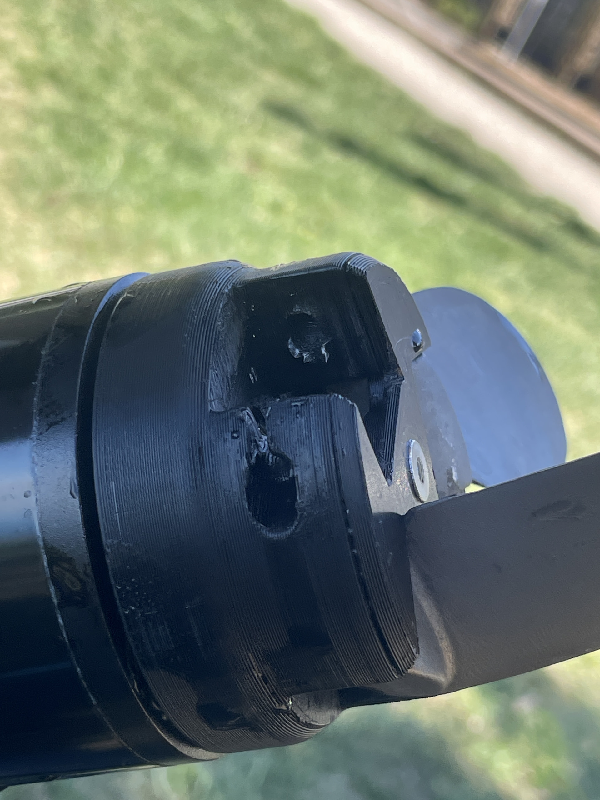

Looks very under extruded. Nozzles are cheap I would change. Also try nozzle temp at max for that filament. Also possible the flow calibration is off but in my expeience thats becaue the nozzle has a partial clog.

Break shows the same issue as the other one above. There is almost no layer bonding and clear underextrusion.
If it separates like this, you will be far better off with a more simple filament that has proper layer bonding.

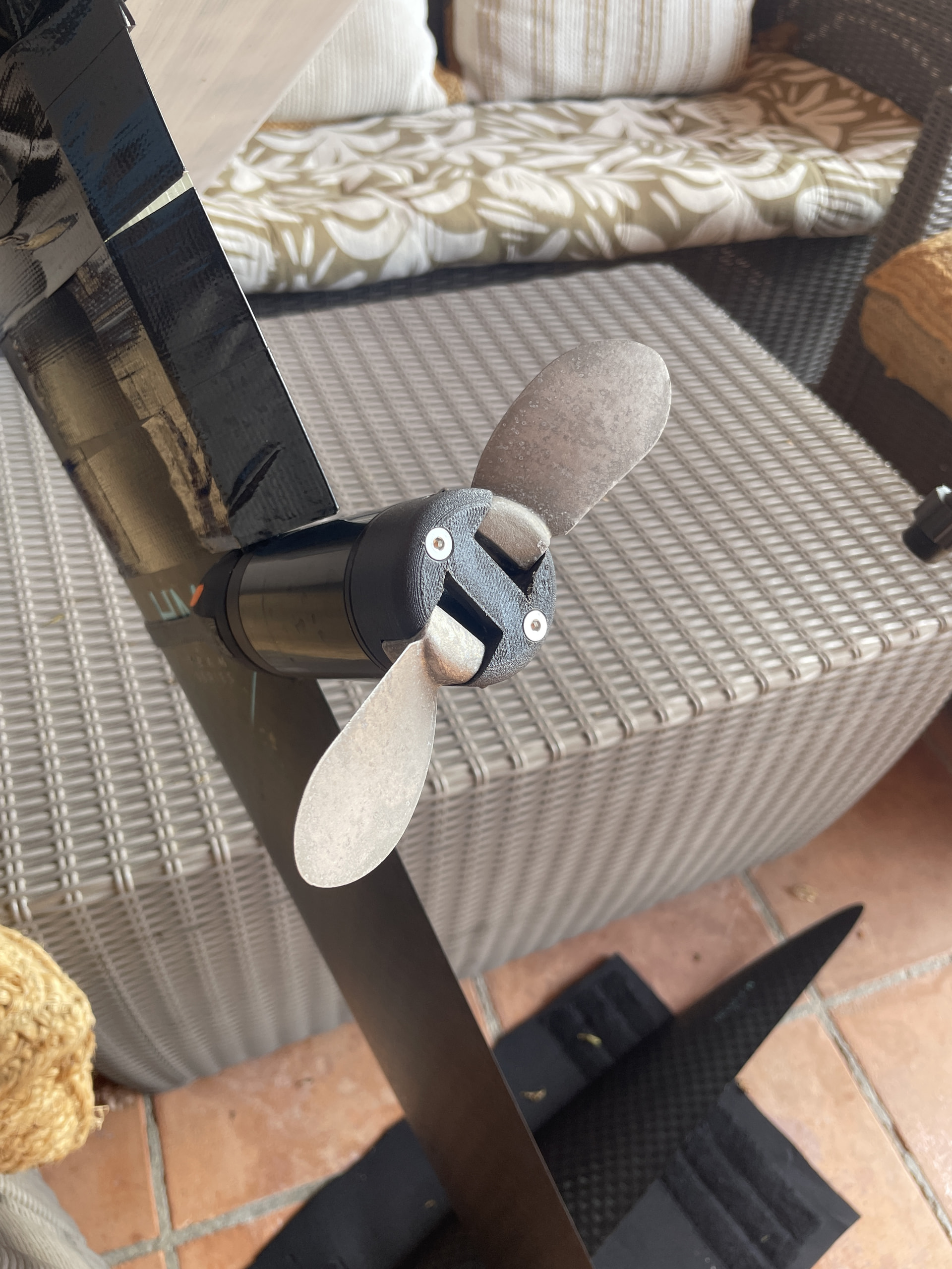

Tried it in the sea, the sleeves seem to work, the blades still move 2 days after the session, no galvanic corrosion between the screws and the blades.
