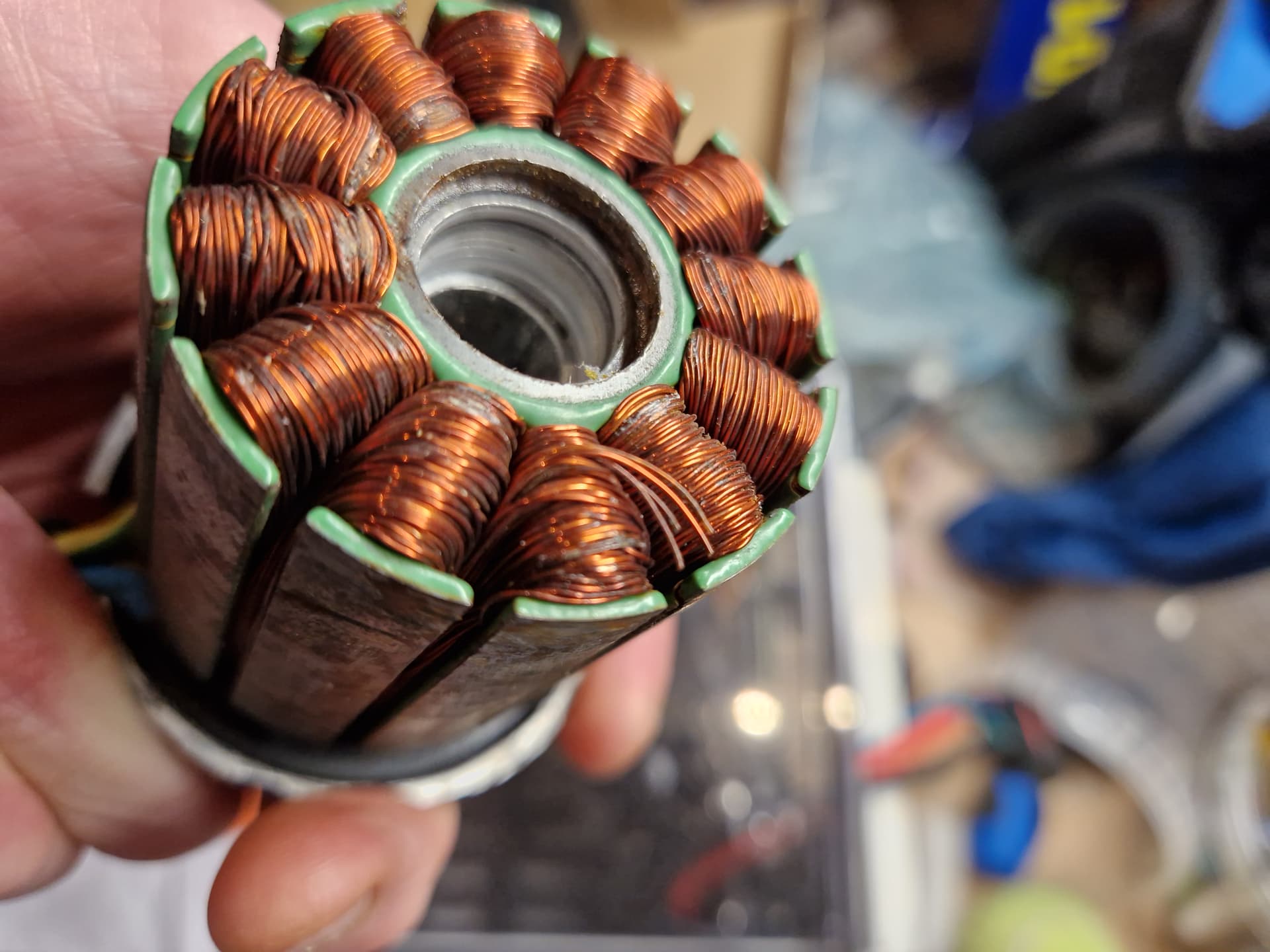

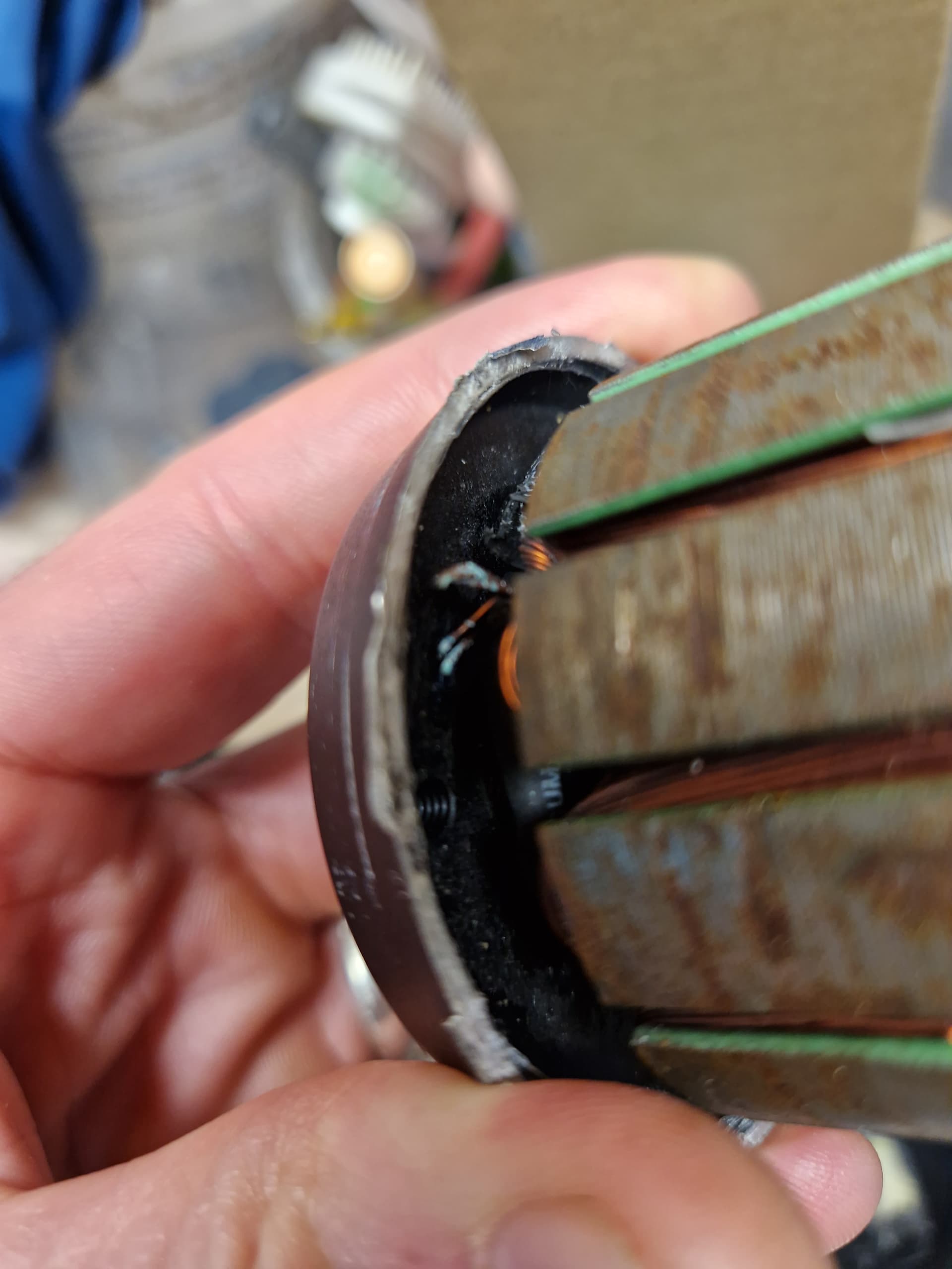

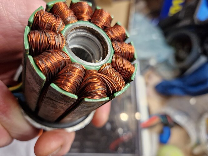

V1 has met its end. Running motor on broken ceramic bearings was a bad idea. Broke motor windings and eventually wore stator base. Gradual breakage of motor windings likely causing reduced power.
Parts odered for V2.
Similar cheap 6384 motor but stainless bearings.

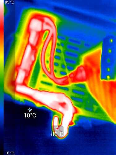

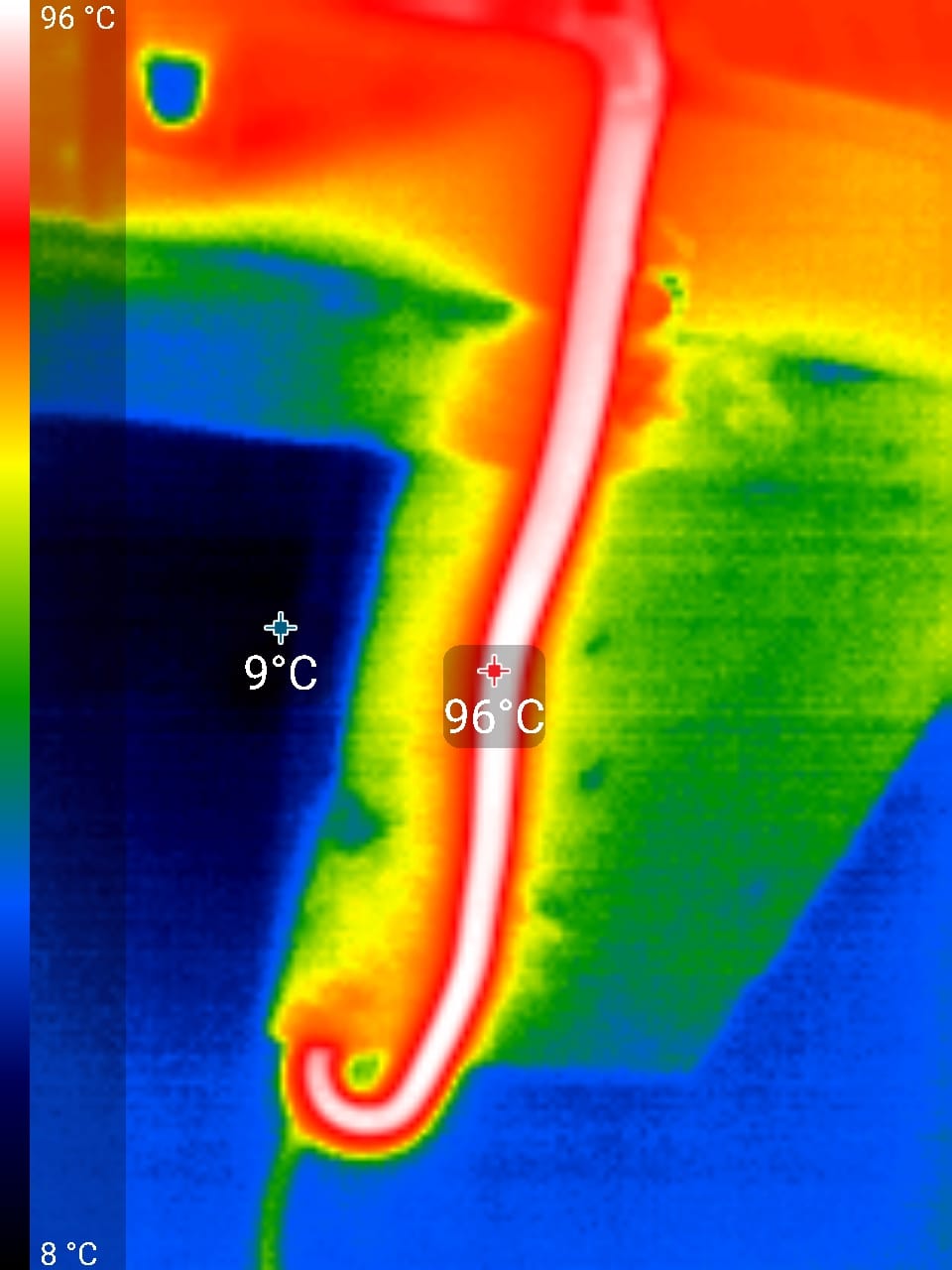

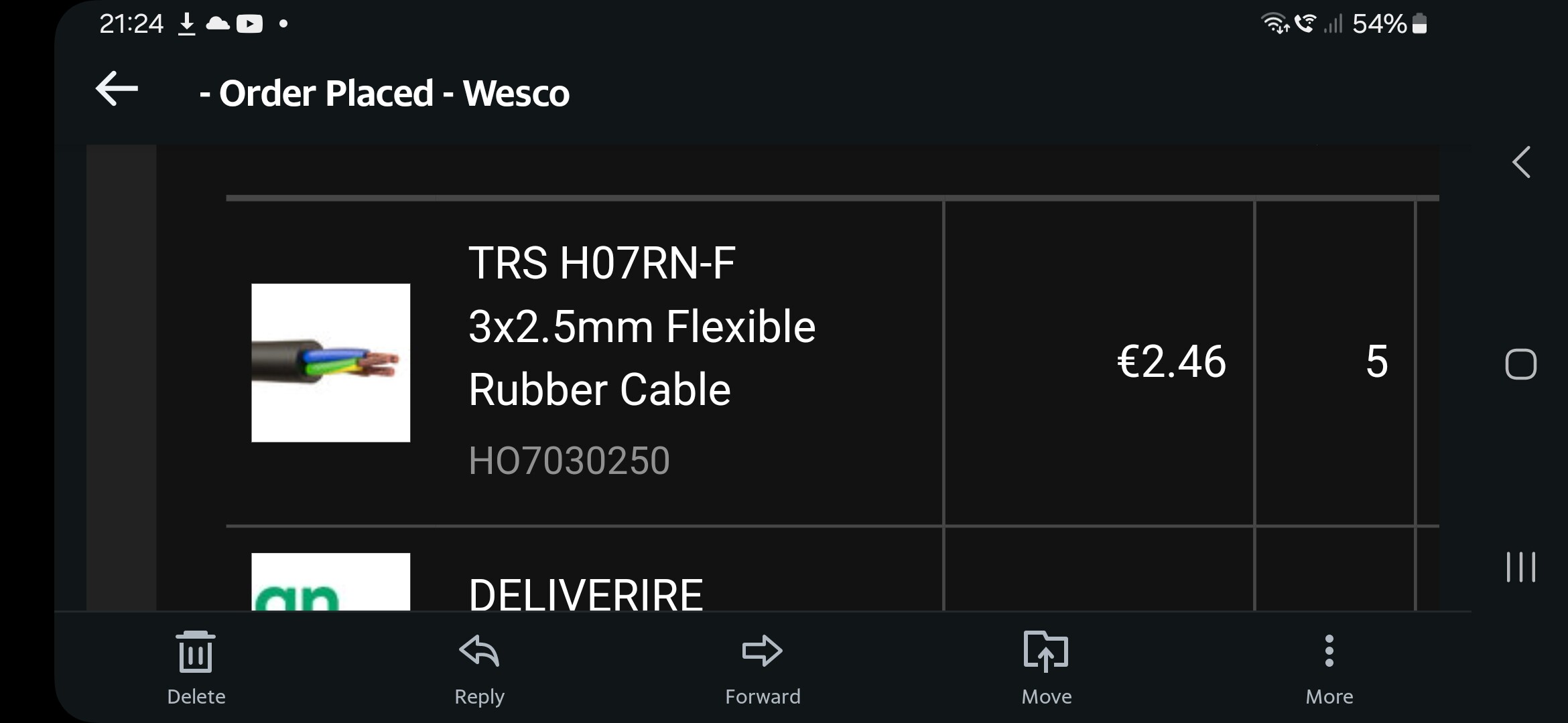

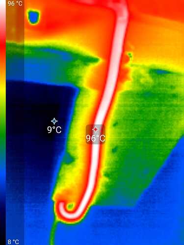

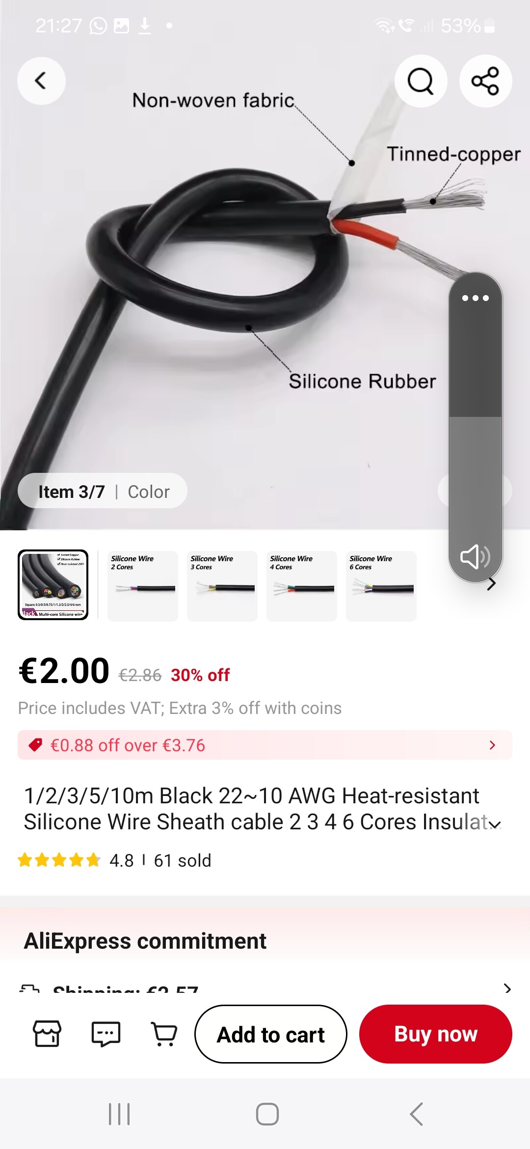

Testing showed excessive heat build up in motor cable. Looks like 3 x 2.5 copper cable not sufficie nt.
