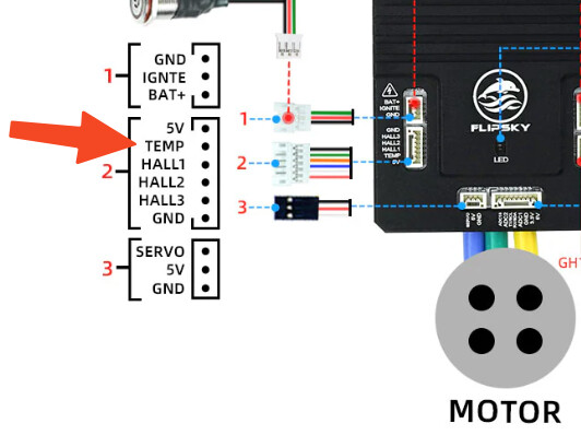

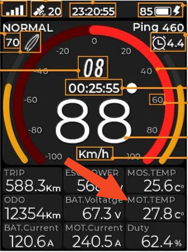

Another idea: What if I connect the ultrasonic sensor to motor temp pin on the VESC? This way I could see the height on the remote as “Motor temp”. Need to figure out a way to “output resistance” to the vesc from arduino… Or is there some way to read it in a digital format without custom vesc firmware?
