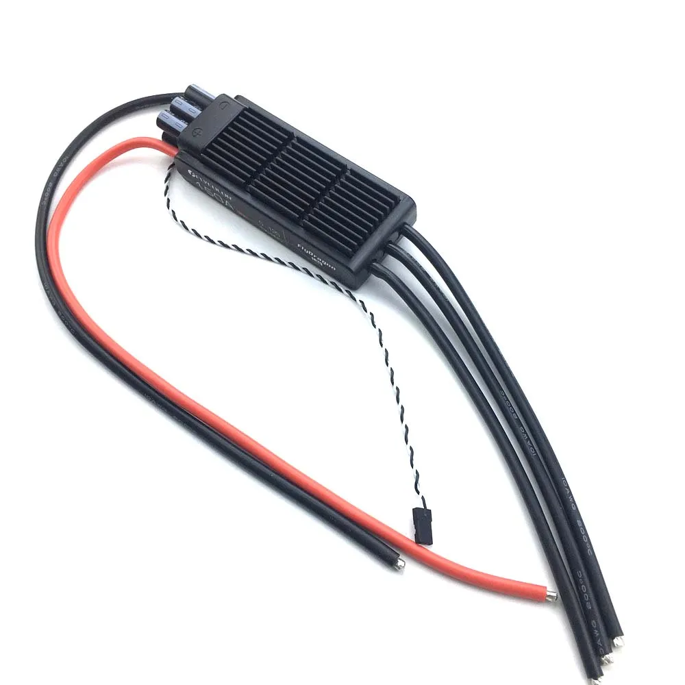

The 63100 outrunner on 12 s will lift your fat ass out of the water without any problems.
Get a Flycolor HV 150A esc it will be around 90us$ and go.
I run this combo with a gong curve L wing for 2 years without any problems.
I am 80 kg and got on wing with 60% of max power.
Do you have any link for motor your mention?
