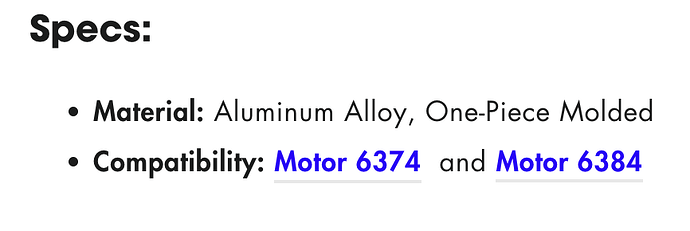

Ok, I got the flipsky folding prop(2 actually) and it is for sure aluminum for $40. It is machined, not cast, and appears to be identical to their previous plastic one except for a few very minor changes. The captive nut is a size smaller, other than that I can’t see any difference. They probably could have made the foil section smaller but they didn’t. I’ll probably take it for a ride today and see how it does.
Talking about it being molded, I was basing that on their page. But if you say it’s machined, that’s great!
I’m eager to hear if it has any issues, like vibrations, and whether you get longer run time…
Maybe they meant that only the hub is molded…
You can also test it in the air by holding the mount and running the motor. When I tried this with their plastic prop, I noticed two circles in the air instead of one.
Took it for a ride and I can’t tell the difference between the plastic and this one. I see machining lines along the blades, so I’m pretty sure it’s not molded, although, perhaps those are machining lines from the mold? That would be pretty sloppy to go through the effort of making a mold and then not polishing out the machining lines.
Anyway, seems to work great, balance seems good.
