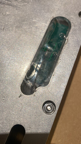

The most sensible way to open it would be to use a heat gun and soften the bond between top and bottom. Once opened, even if you trash what’s inside the new parts are cheap to replace.
Thanks for your response. If a heat gun can work, maybe I can heat up a thin knife to keep the heat local, without destroying the internal electronics.

Did you use heat to soften the adhesive before separating the Foil Drive Max enclosure with the screw-type tool shown in your photograph? And have you successfully resealed one afterward?”
As mentioned above i boiled the unit in a pan of water to soften the epoxy then you can separate the parts most likely they will be destroyed in the process.

I used sika cannot remember the number to reseal the joint and epoxy filled the end like before
Make sure all the screws are out and the blue splits
