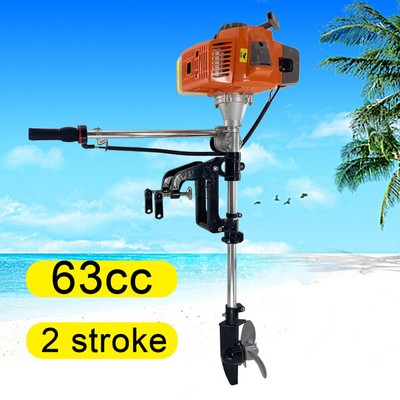

Interesting Chinese gas jetsurf brand :
Hahaha that is amazing. Looks more like a weed eater/edge trimmer.

Do you know the rpm and motor power ? We have plenty of propeller models (FR, P-King, Flite, Manta, …) to improve this but if the rpm is halved, we cannot increase the prop diameter that much …
It could be this, it seems to be the biggest 2 stroke version at 63cc
It gives a motor RPM but we would need to know the gearbox ratio
Specifications:
Engine type: Single cylinder
Stroke: 2 stroke
Cooling System : air-cooled
Engine model: 1E48F
Displacement : 63cc
Max. Power: 2.3kw/8000rpm
Start system: Recoil start(manual start)
Ignition system: CDI
Mixing ratio(Gasoline:oil) : 25:1
Gasoline tank capacity: 1.2L
Idle speed: 3000rpm
Gear ratio: 2.08(27/13)
Propeller diameter: 18cm
Propeller options: 7-1/4*5-A inch
Running speed: 15–18km/h
It is given at 20.8 (27/13), normally it is output over input but cannot confirm. This would mean the output (the prop) turns at twice the motor rpm
