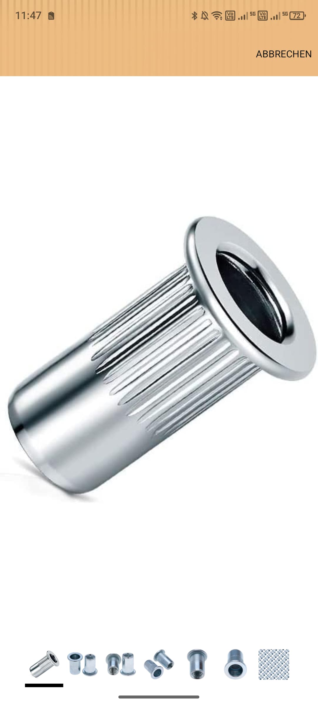

I used those (Blindnietmutter M8x29mm, stainless) and pressed in into the Alu plate
Hold solid, replaceable if the threads break, waterproof
(You need the version that’s closed on the end, the image is open)
Like this maybe
https://www.ebay.de/itm/394019153321
I still have many left and can send you a few within EU
