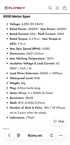

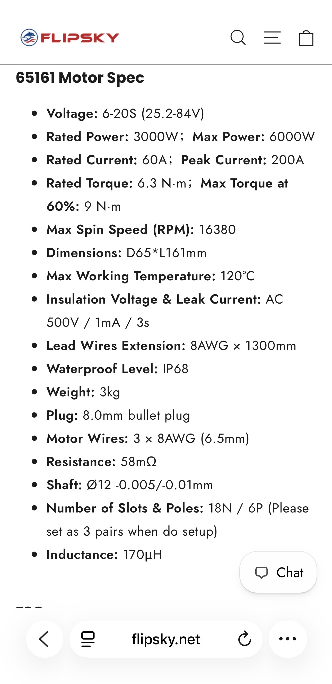

This is Flipsky spec
So 65161 is not 12Nm and you don’t need all of that to foil anyway as long as you are using a normal Efoil board. Some people use rifle cases which I believe take a lot more force to get to foiling takeoff speed. I run a Flite prop as many here do on my 65161 motor and would never think about using full power of motor during a start or even while foiling.
Also lots of people are using relatively small outrunners in foil assist builds and occasionally use them in full Efoil mode. I’m thinking they are no more “torgue” capable than your motor.
