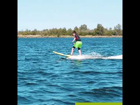

I run two 53mm jets in my DIY board.
This one: https://www.youtube.com/watch?v=-dTv7zzceto
Nice, do you run it planing or at least >20kmh?

This is how my ran, looks cool for kids. Not so cool with 2m guy plowing forward with nose pointed at the sky…https://youtu.be/2Ln42S7wNAE
My board does go faster. I’ve reached +30 KM/h with it, but it’s no fun as the board starts bouncing around.
I’m using two Surpass hobby 56102 600KV Brushless Motors each powered by 3 in parallel 6S lipo’s (so each motor is powered by a 6S3P)
The motors are doing about 13000 RPM, but can be bumped up to just under 30000 when on 12S.
( Guess what I’m building now… )
Some long time ago videos. Many things have changed after recording them.
A more resent video (sorry on Instagram)
https://www.instagram.com/p/CCySTySnHWP/
Noël on Instagram: "We (Kian and I) did some more testing with V1 of the jet board. It definitely needs to be wider at the back. We are starting with the build of version 2 soon. The 12S12P li-ion battery pack is already done, and being tested now. #jetboard #electricjetboard #esurf #esurfboard" (Board is not running full speed)
