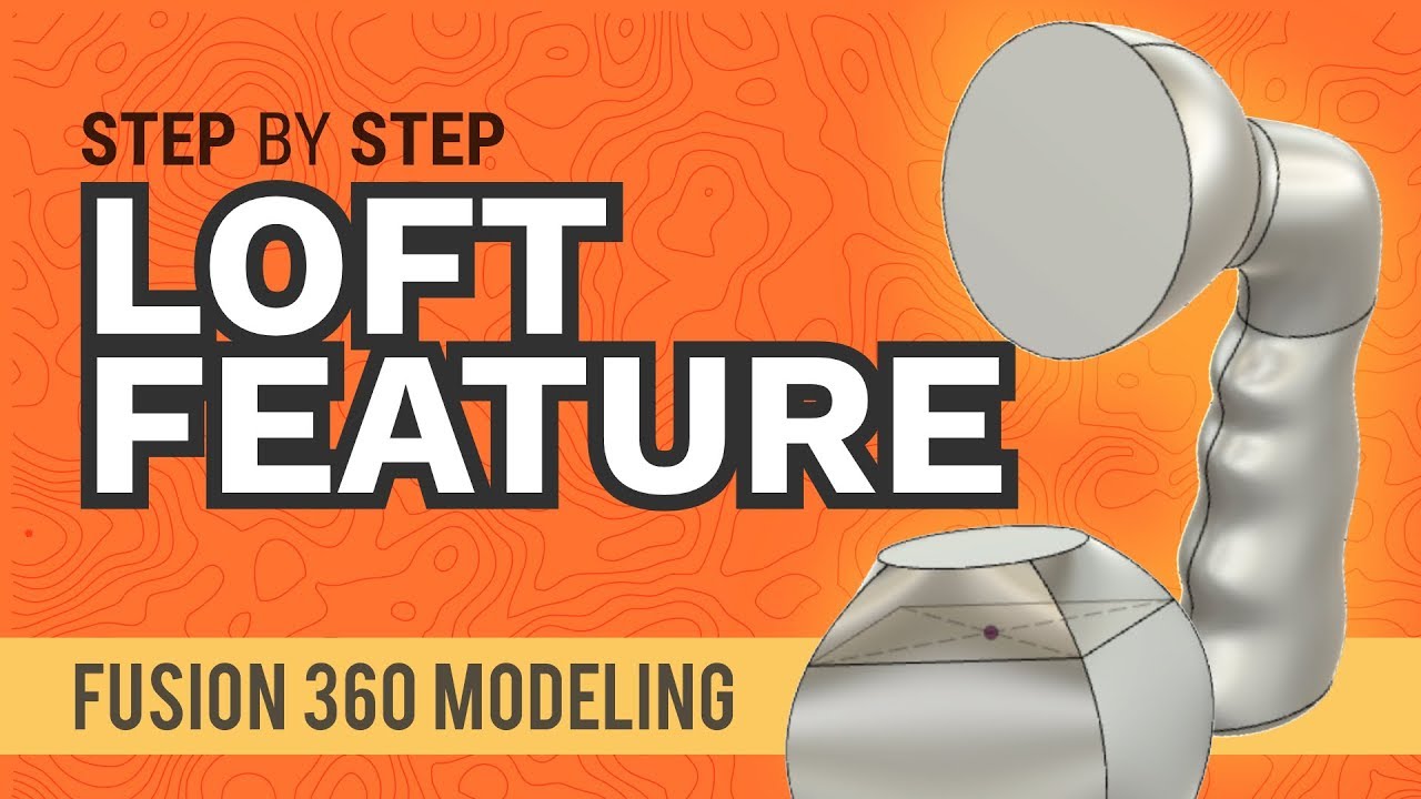

Can someone help me make an extrusion? I am using fusion 360 and would like to extrude the sketch (image 1) along the second sketch (red arrow).
What do you want exactly ? I work in rhino and will try to make the extrusion. I just need the profiles…
Try loft feature.
Thank you @Fruitygreen. Your Video helped me and i found the right function to do the extrusion.
@Tigerkiki: thanks for your offer. I could draw it myself by now.
Very welcomed. Not my video but just passing the knowledge.
