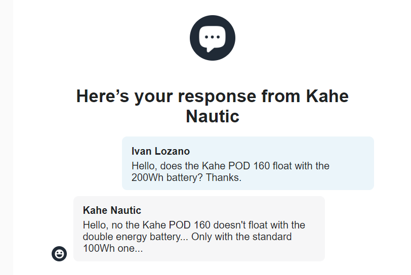

I have tested on the water the 2 batteries indide the POD, and it’s important to know that the device does NOT float whit both bateries inserted.
This is in my opinion a really important factor to take in to account.
Confirmed with the manufacturer:
It floats with only one? :smiley:
Of course it does! (It has to) actually, it’s a key feature in case you miss it on the water. The orange cap (Decathlon version) is just for this and make it visible in the water, this floating spec is detailed on the product detail page.
