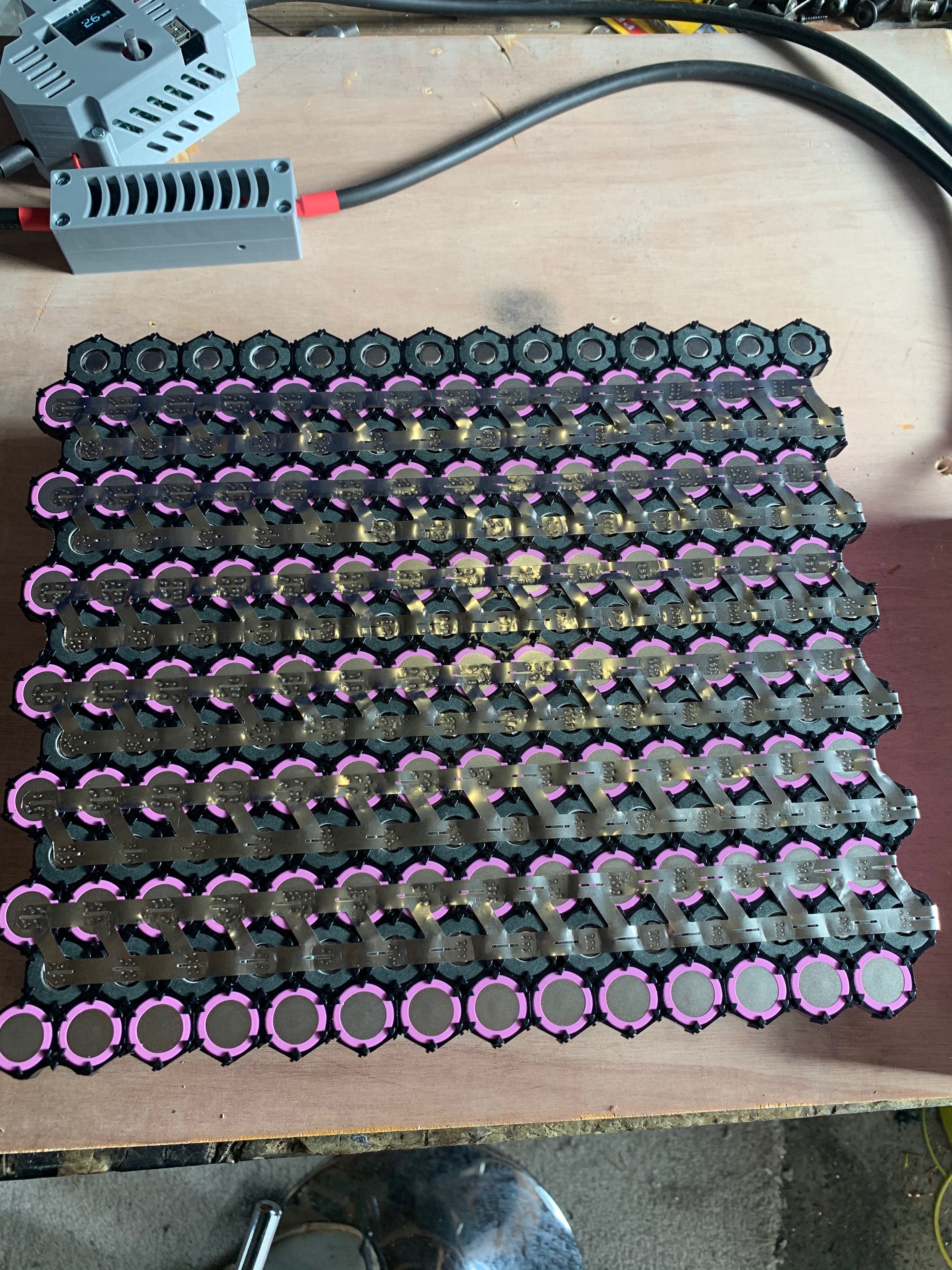

I just can’t imagine the balance leads coming off the side here along with 2 layers of rubber sheet wrapped around it, but I hear what you’re saying.
 ![IMG_5170](https://efoil.builders/uploads/default/original/2X/b/b8b3779e331a9ccbb99b9f3d51a5d2978719f7bb.jpeg)
So if you connect all balance leads to negative ends (plus the last positive) and one came loose and touched its neighbouring connection, how would that not short?

> [@Wardy](#):
It’s not about coming loose. When you wrap the nickel over the edge like you have, there stands a chance than the with time it might chafe against the cell insulation. If its welded on the positive, it will mean it chafes onto the negative and then shorts.
But if another here has had a BMS fails there’s a good chance it could be that too. None of my batteries have the BMS on them. I only connect a BMS when the battery charges and then I run a “dumb” battery. Less chance of failure while doing nothing…

Ahh I see what you mean. Well that rules that out also as the nickel was only bent over around 5mm and didn’t go past the cell holder.
I think the BMS is the culprit, I never considered using one externally for charging.
