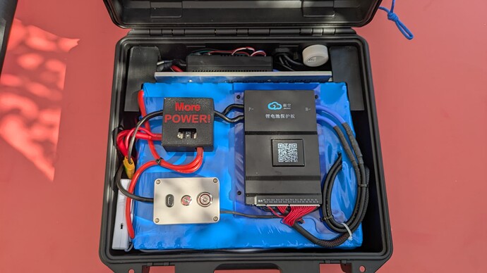

I assembled the whole battery
Installed it in my “case”
And chose to have the Vesc in a dedicated “waterproof” box outside for better cooling. (Thermal compound between Vesc and Box)
However, after 5/6 sessions, I ended up having water ingress in the Vesc Compartment… and it died.
A new 75200 has been ordered, and I now need to find a “better” way of doing things. I do not know where it failed; either the seal of the aluminium box or the sealing (Sika 521UV) between the battery box and the Vesc box.
The dedicated aluminium box was perfect, never saw the Vesc above 42°C.
I’m about to order a bigger plastic case to fit the Vesc with the battery but I’m worried about cooling. I’m a bit reluctant to have an opening in the box for a cooler…
Overall the external aluminum box seems like a good approach.

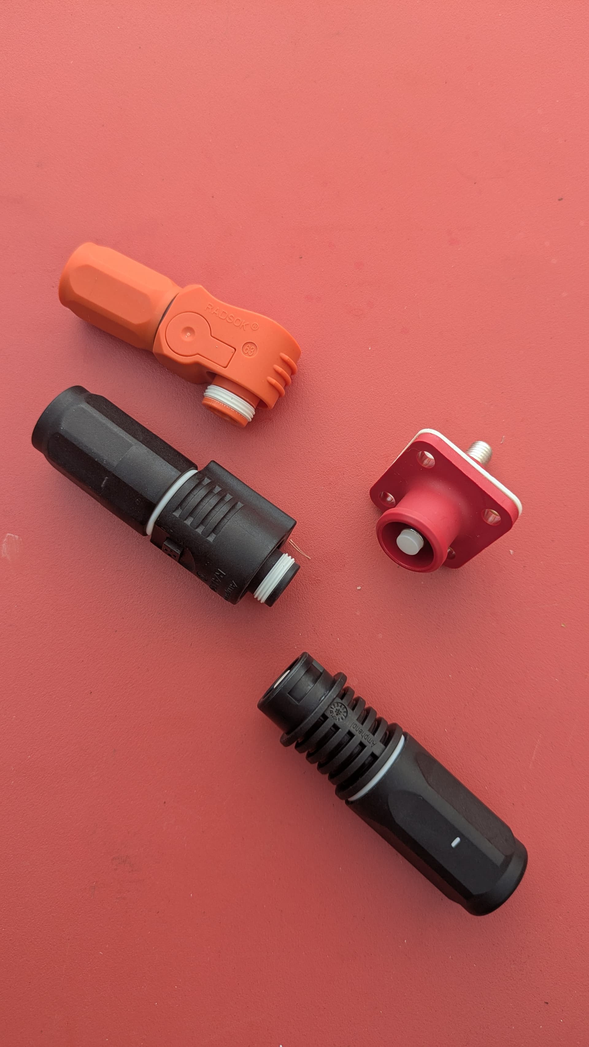

While trying to come up with a new plan, I came across these DEUTSCH DTHD04-1-4P / DTHD06-1-4S connectors.
They are supposedly IP67 and 100Amps, and seem to be meant for use in harsh environments (including under the hood)… Has anyone given them a try to connect the Motor to VESC?
To top it up they can also found on Ali for fairly cheap…
DHTD06-1-4S
V2 is now up and running for a few sessions…
I relocated the Vesc in the battery box. It is now attached to a 6mm aluminum plate acting as an heat-sink.
Phase cables are now integrated into the mast and I removed the prop guard. This makes a huge difference as I can now foil as low as 1500W / 30 Amps.
However I feel like my design is far from being optimal as I get fairly high temps from the ESC (up to 75°C). Is this acceptable or I should think about another design?

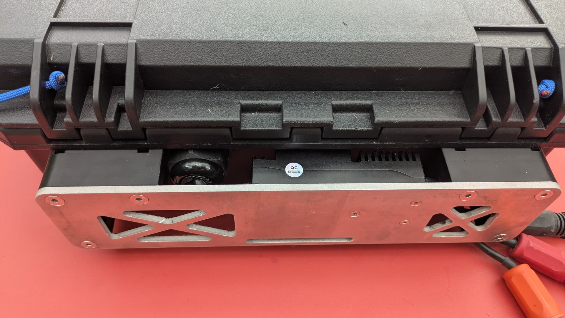

  • Just bought a new ESC (Sequre WP14200 / escape32) that I plan on installing outside the case to get better temps.
If I was to do it all over again, I might go for a smaller battery, I can easily get 20+km on a charge…

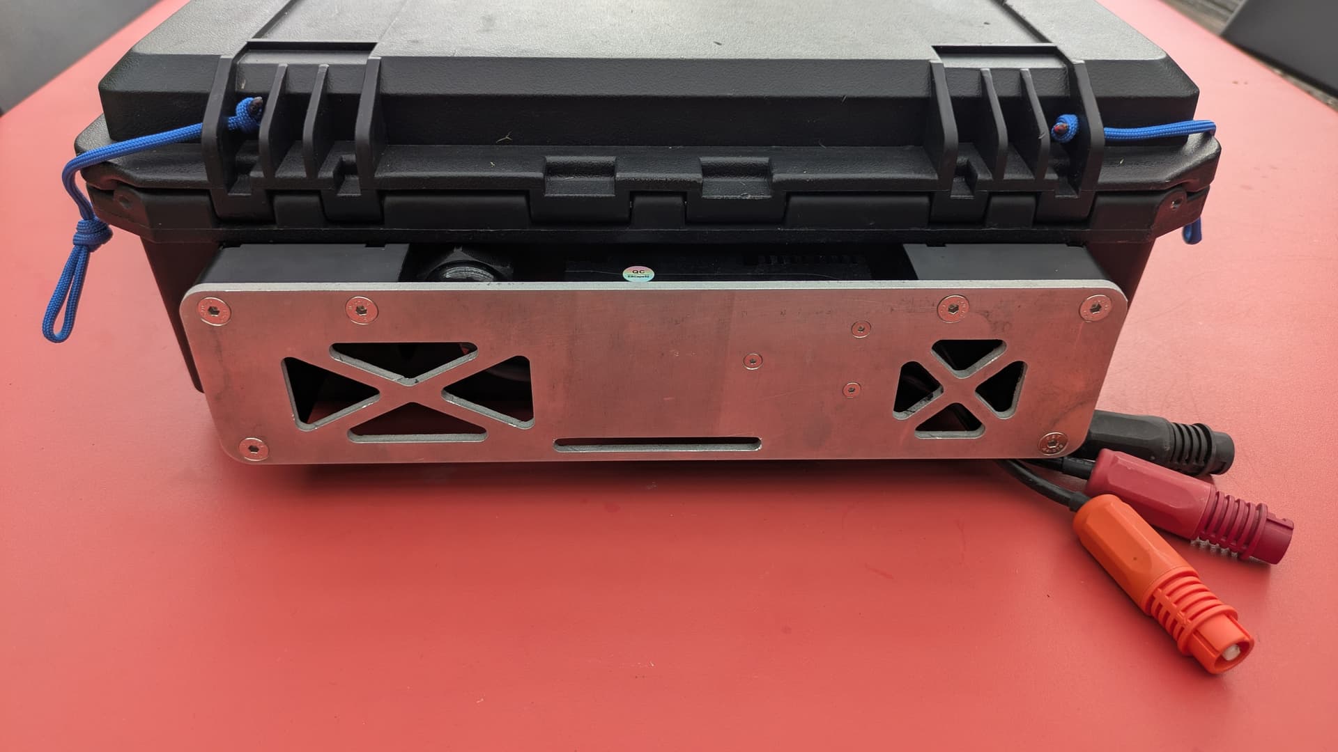

Now having V3 running… Changed from Flipsky 75200 Vesc inside the case to a Sequre WP14200 outside that case for better temps. Runs fine, still need to fine tune the onboard Escape32…

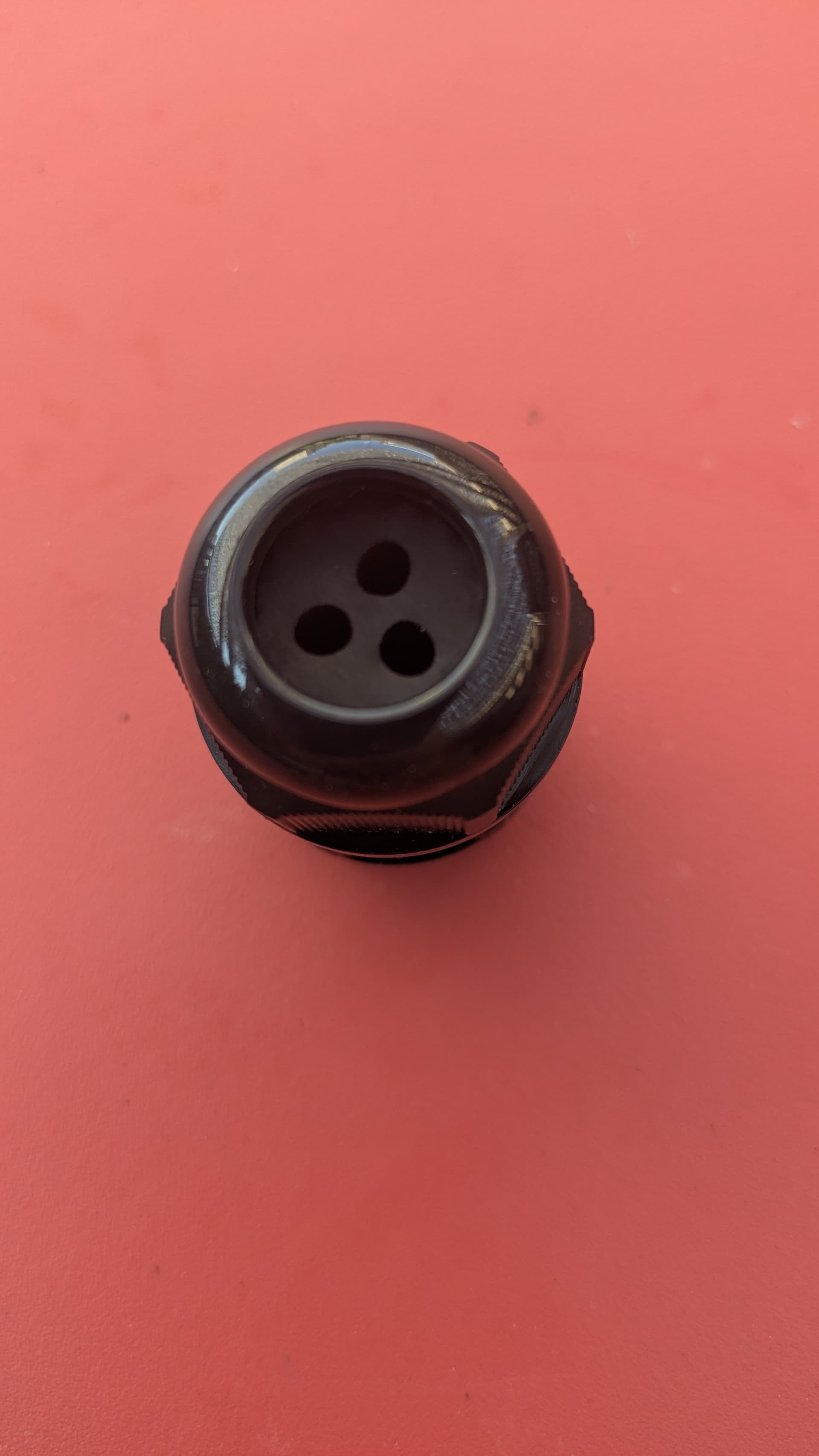

Hey,
Nice build i am using the same ESC, it is really good never overheat outside the box.

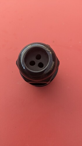

I was wondering which cable gland you use to run the cables inside the box?
And what are these individual connector for the motor side?
Thanks
Cable glands are from AliExpress, no complaints so far.
Motor phase connectors are Amphenol Surlok, they come in all sizes and forms…
