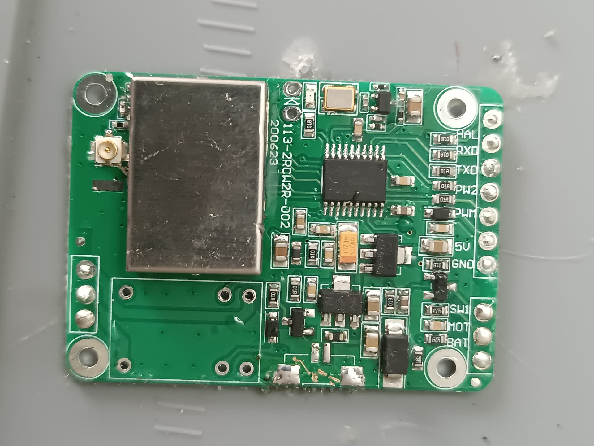

What are the dimensions of Maytech receiver?
Please help me. I need it for modeling…
What is that large part ? Looks like a relay…
1000067077
This is the pump relay.
Unfortunately both my receivers are filled with silicone, but you can estimate the dimensions by this model. Maytech remote control receiver box by strepod - Thingiverse
Models - Great idea! :blush:
Pump relay, great - I can remove it…
