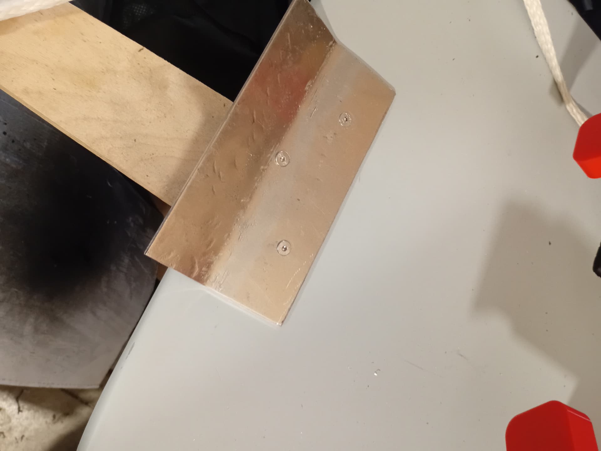

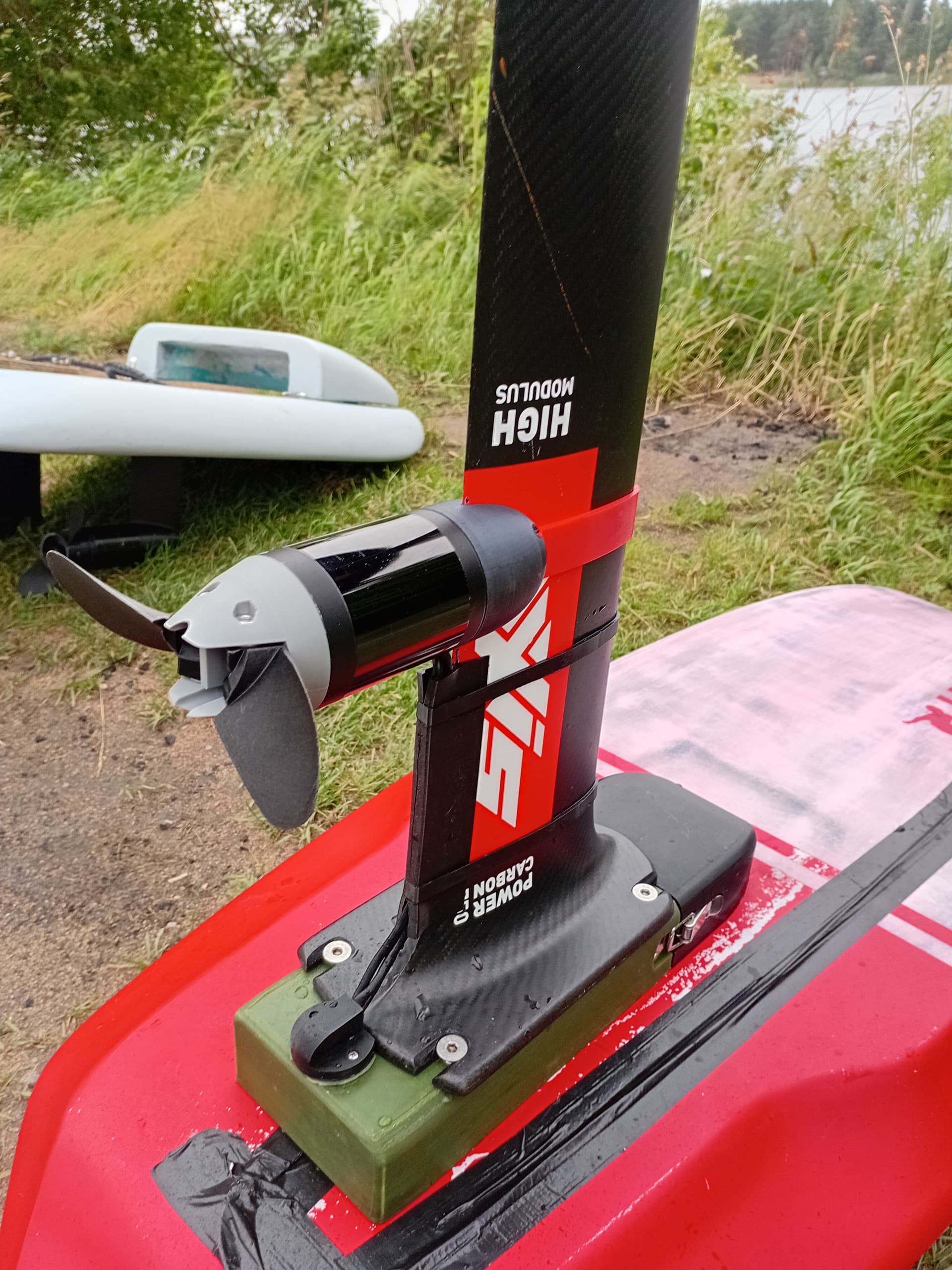

I bolted this aluminum plate, made in the garage in a quick and dirty manner with a vice and a hammer, to the tow boogie. It completely eliminated the porpoising. The stern no longer bounces at any speed and I have no complaints about the handling.
The maximum speed has dropped slightly to 27.6 km/h. But when I return the tow to myself, even empty, it no longer lifts its nose.

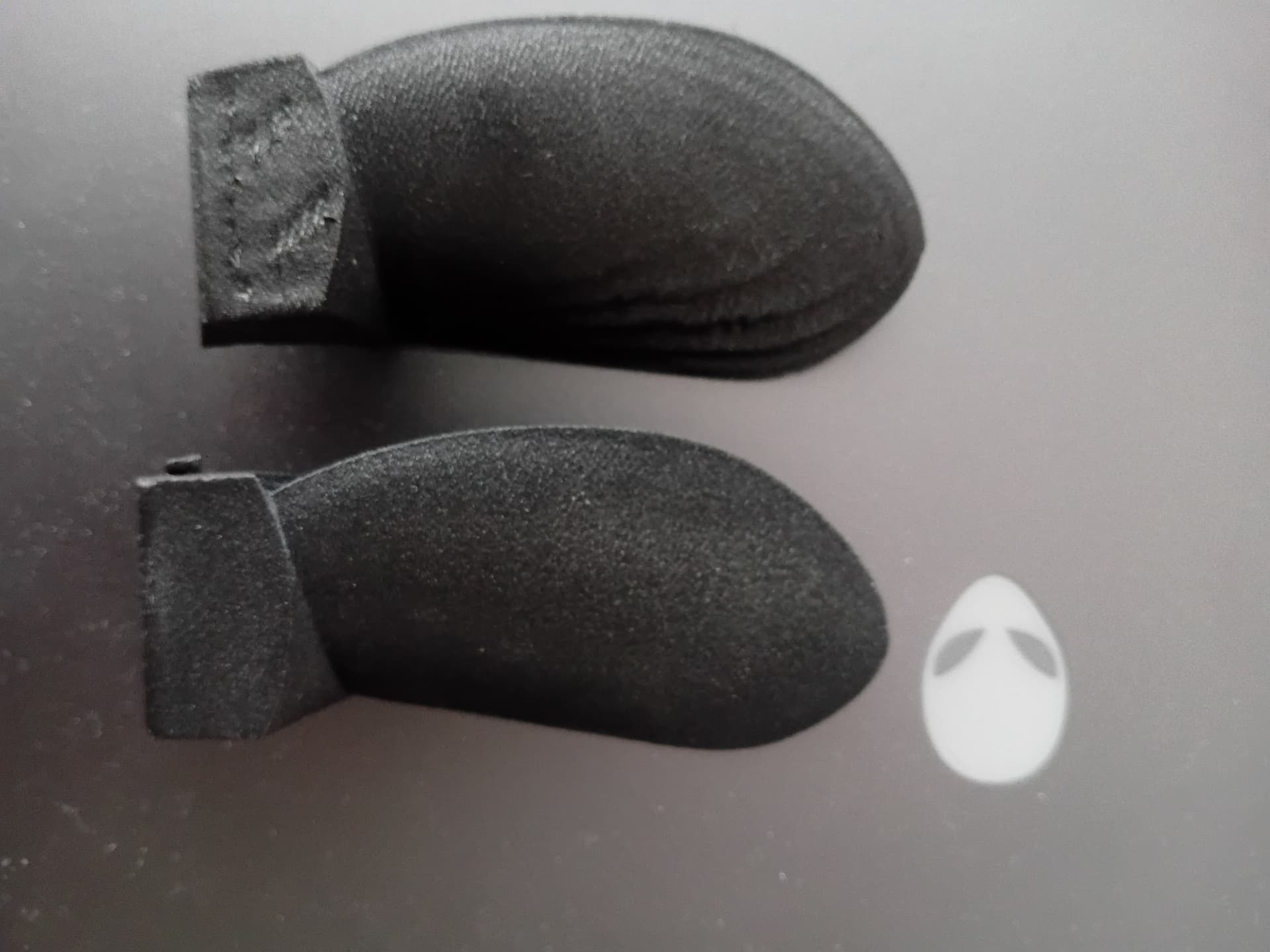

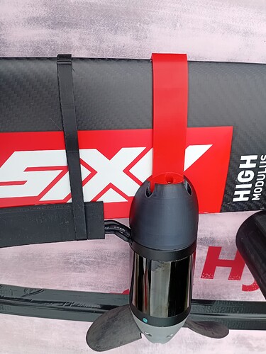

Made a new mini-pod style mast clamp. Previously used clamps from Strongarm and its derivatives. Good, but the fit on the mast was a little shaky. Now, because the strap is designed to the profile of the mast and it is quite wide, the fit is quite tight. I am happy.
By the way, I have a hybrid motor in the photo ). I took a rotor from a Flipsky 6384 with broken stator wires and connected it to a stator from a Maytech 6384 motor whose magnets had fallen off. I had to sacrifice one bearing. KV also changed due to the reduction in the amount of copper on the windings. But at least it works )
There is a little vibration and I would appreciate if someone could share a simple method to balance the rotor and stator.

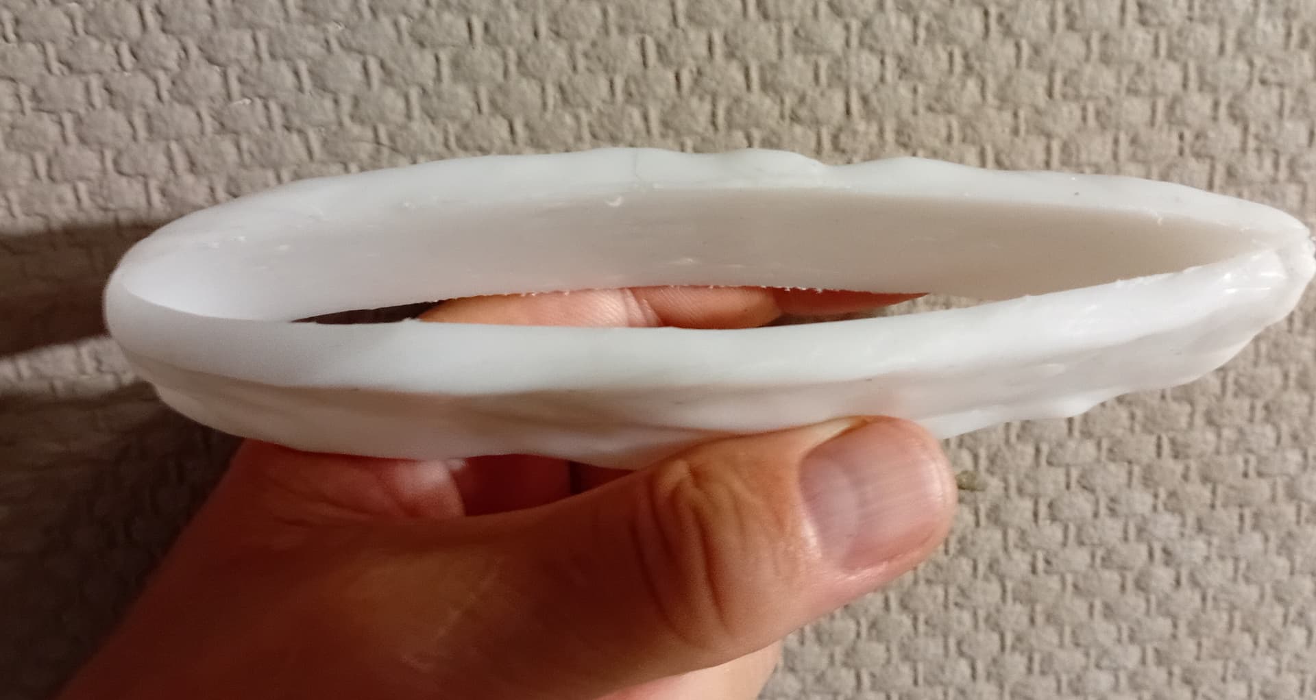

I want to share my method for creating a mast profile. I take TPE granules, soften them in water and create a mold like this. Then I take a couple of photos and transfer them to Fusion 360.
That looks like a really nice design. Great work.
Thanks. I will do some more tests on the water and if everything is ok, I can share the model with those who are interested.
