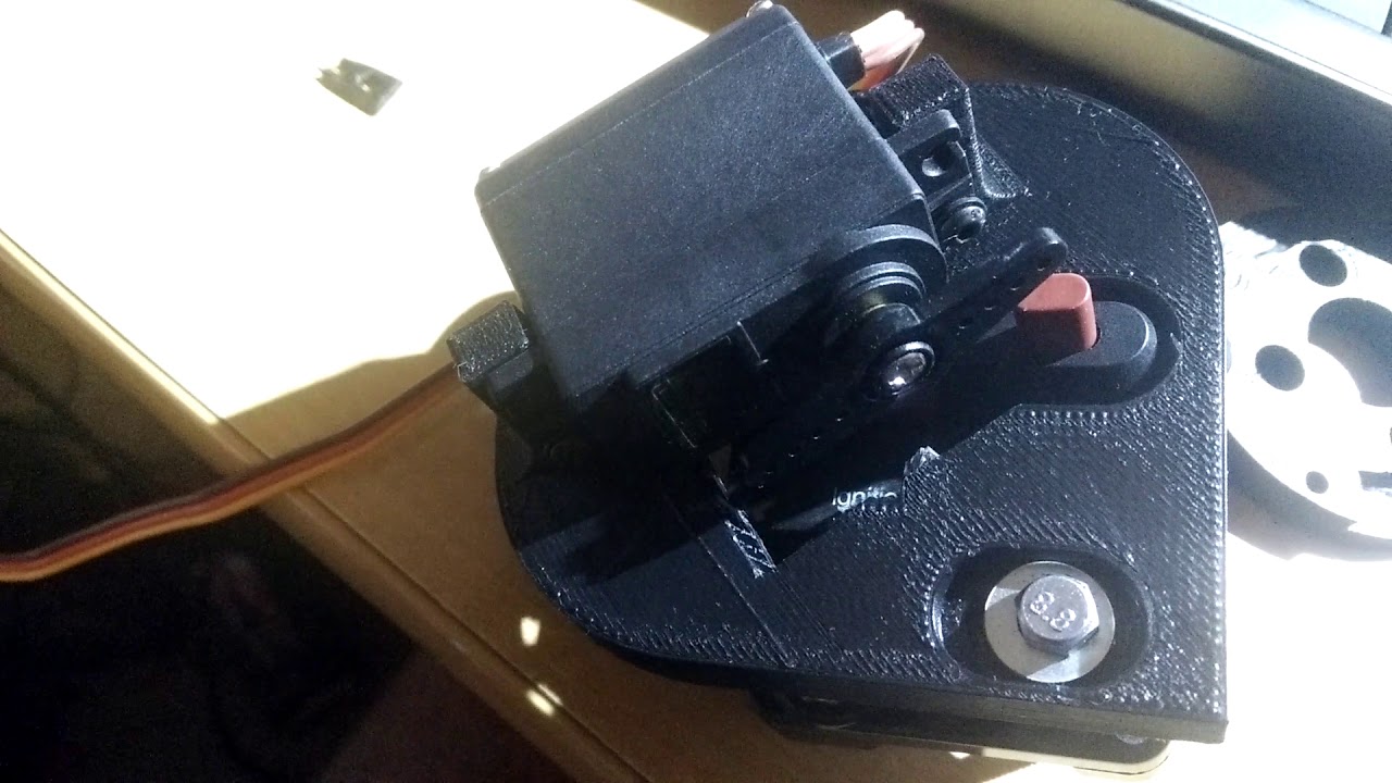

Has anyone used/tested a circuit breaker (CB) such as this? I had a thought to use this circuit breaker also as a switchable dis-connect. I.e I will trigger the circuit breaker test button with a servo to break the circuit and also use the same servo to reset it.
The intention is to simulate having a contactor, until I find a suitable contactor solution. I have a teensy in the loop controlling the ESC speed, so this can also control the servo to trip and reset the CB. If the lanyard is pulled then I will trip the CB. Obviously this isn’t super reliable adding a servo into the loop.
I haven’t actually tested this circuit breaker yet, just trialled the trip / reset with a servo.
Any thoughts on this idea?
For 3000A@48v interrupt capability those are quite cheap, good find. I wonder how they work internally and how much power loss occurs at 100A.
For the servo idea, I like it but that would be to much mechanical stuff to figure out for me. Maybe if you open it up, a way to acuate it electricaly could be found. Edit: Like @MaxMaker says below, there is only a bimetal sheet inside. I found a video teardown. Does not look confidence inspiron to me.

I looked at them. Very cheap. Some say „waterproof“ but I don’t see how they can be. Inside are two metal plates that deflect to create contact. Clever mechanism, but not very accurate and prone to errors due to cheap manufacturing. Check out some videos on Youtube. They break all the time.

There are alot of these style circuit breakers out there all with ratings up to 250A. But I agree they just don’t look beefy enough.
