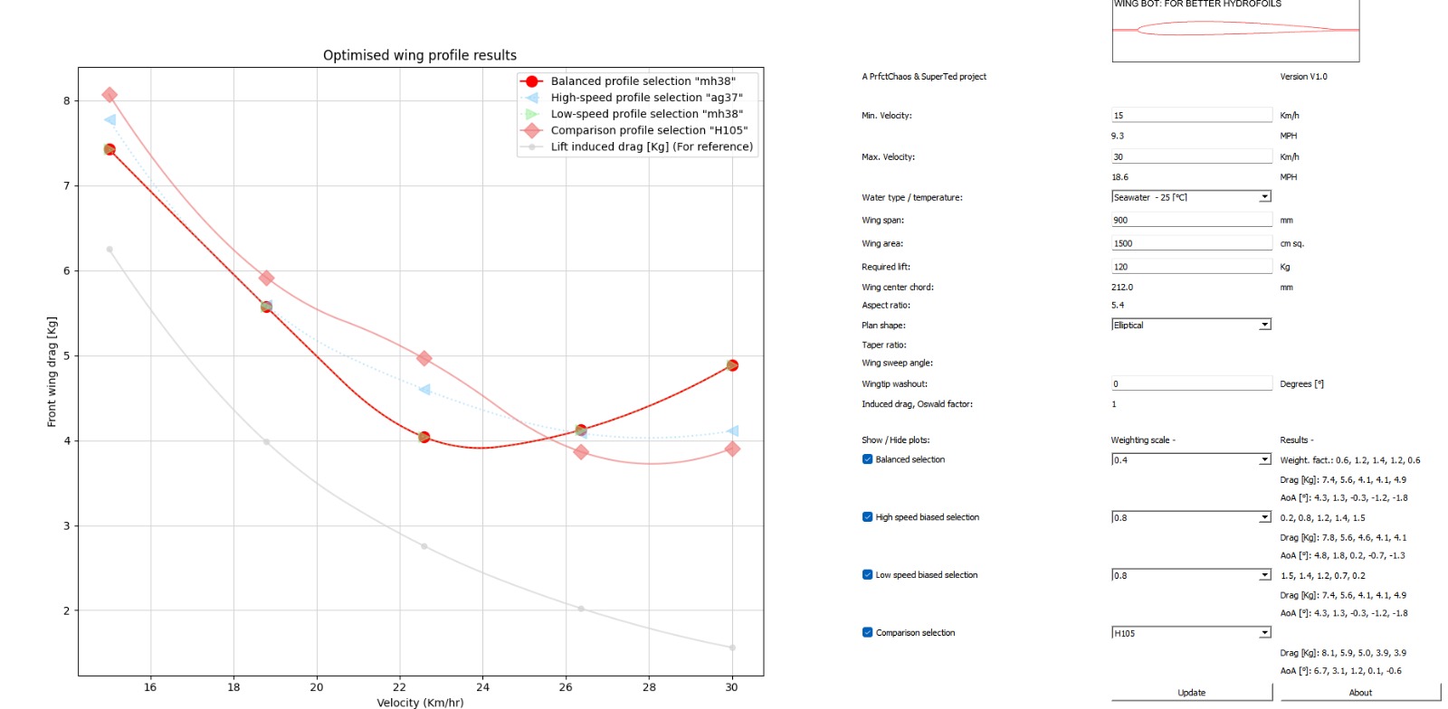

Thanks for the suggestion. The wing_bot suggests the mh38, but the difference for the H105 in drag for the same lift is relatively low.
With the benefit that h105 seems to be less sensitive to profile imperfection, right?
I do not think so.
The camber profile is really hard to get right.
Advantage is how it is a thicker profile, so easier to build a rigid foil with.
For a beginner pump foil, I would choose a profile with a slower max efficiency speed than 28km/h (H105). Would be good to be able to reach that max efficiency speed, 28km/h is (too) fast for pumpfoiling, at leas for a beginner. Around 20km/h seems more realistic.

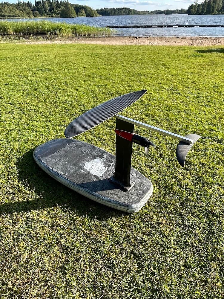

I have the gong trail xxl and i love it for dockstarting, with no electronic assist. No idea if it is suitable for an efoil. I havent seen any efoils with a wing that large
Also, the amount of force these foils take when pumping is a lot. From the outside it looks smooth, but when you pump on the foil you can tell that the metal underneath is being strained.
Gong actually recommends a titanium fuselage instead of aluminum for wings over 100cm wingspan. The metal takes a beating
