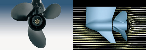

Hey, why did you make a tail cone? Modern highly efficient propellers have the opposite design:
Yamaha:
Suzuki:
because the tail cone is more efficent than a “normal” propeller.
That design that you show me, i not tried. my design is 3 years old.
I can design such a end and try if i see some differences.
At the speeds efoils run at the tailcone will have absolutely zero effect other than looks.
Even on large speedboats with 300hp motors a cone makes minimal difference and as a result they leave them off because of manufacturing costs etc.
Have you noticed any performance improvement with your design?
Have you made any measurements or comparisons of effectiveness?
