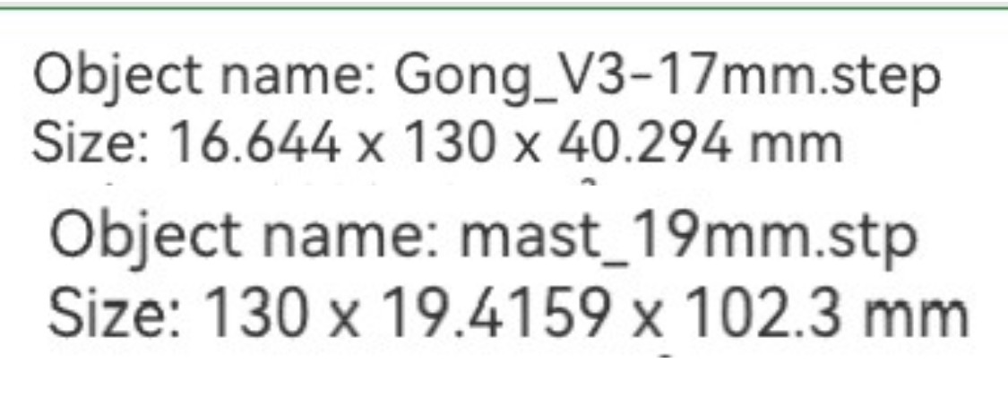

Turns out there are only minor measurement differences as they are all 130mm wide with similar height choices.
The V2 and V3 17mm masts are even matched in maximum width at 17
The V3 19mm is obviously wider than either of them but is very close in curvature to the V3 17mm
These are the measurements of the 17mm model from Kian and the 19mm model from Nabazul - produced by Bambu Studio
If I was to change from my V2 mast to one of the V3 choices I think I would pick the 19mm version as it’s purportedly “stiffer” as its usage description is for “wider” front foils.

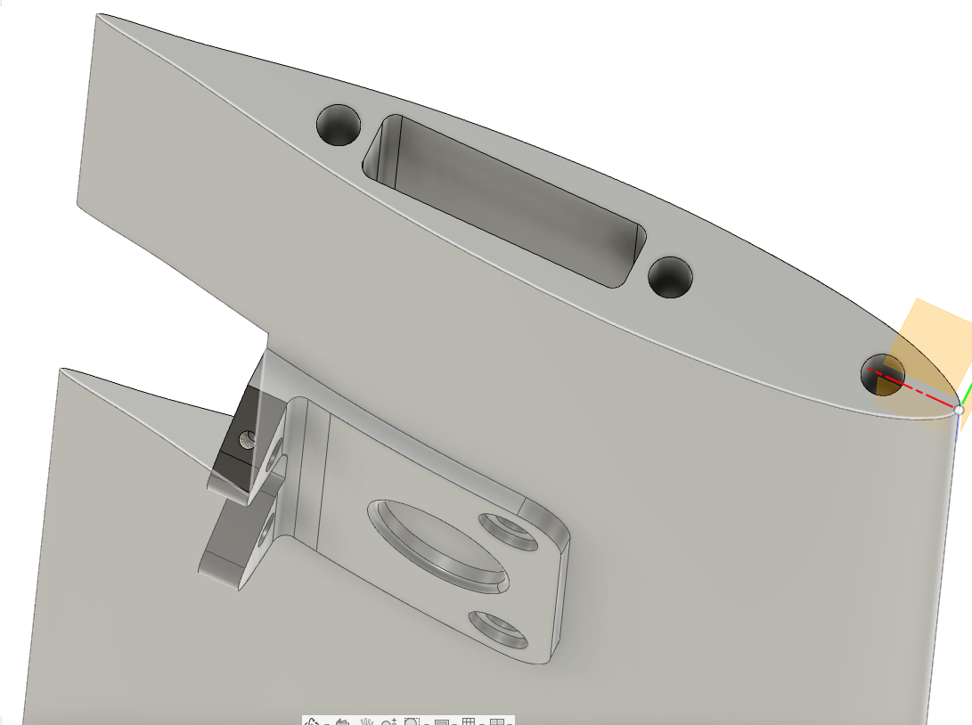

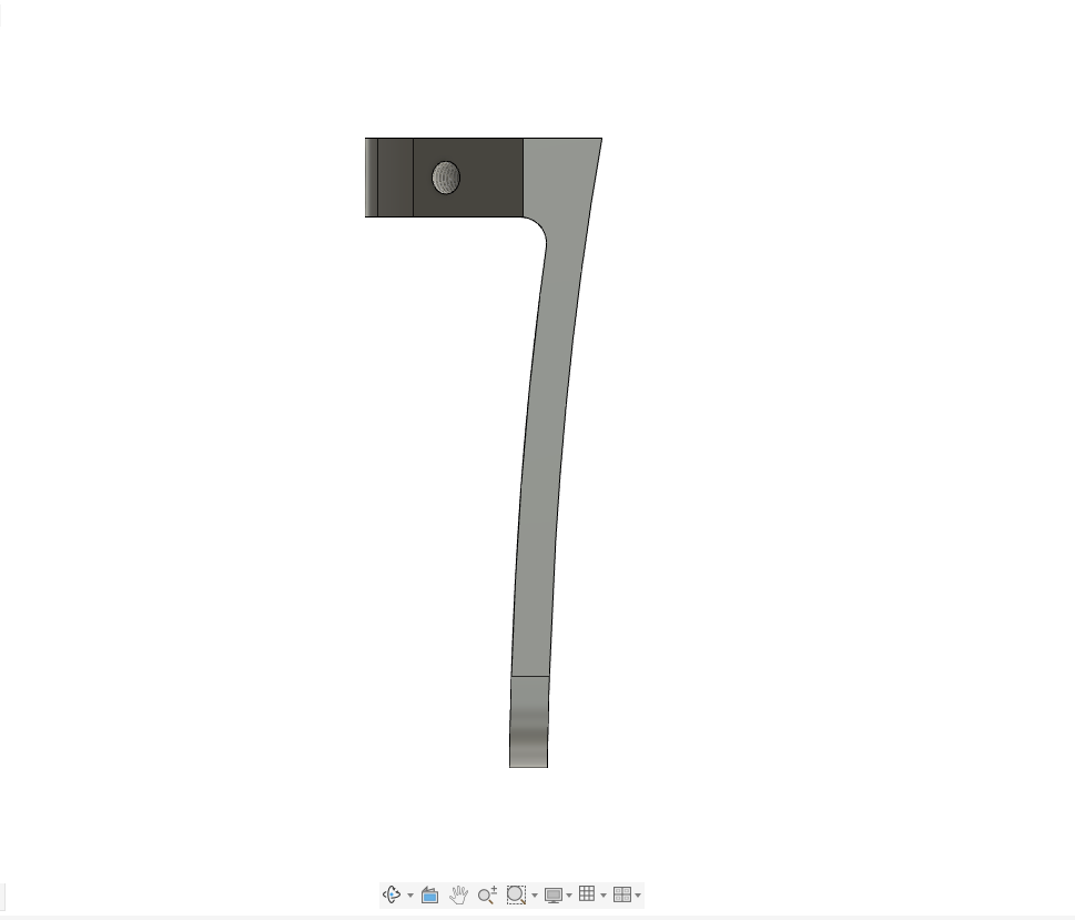

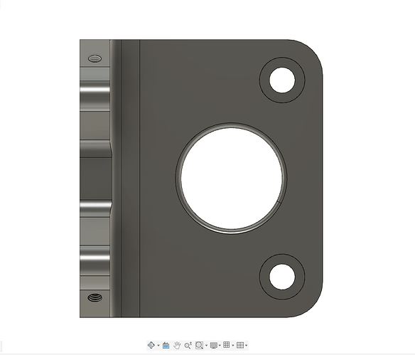

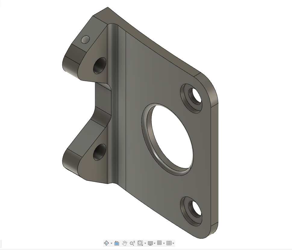

Here is mine, will release next week. V3 19mm Gong
Not tested yet, very similar to Kians design. I need to test whether the head of the motor screw will be obstructed by the fillet or it will bend a bit.

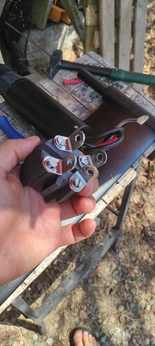

Hi

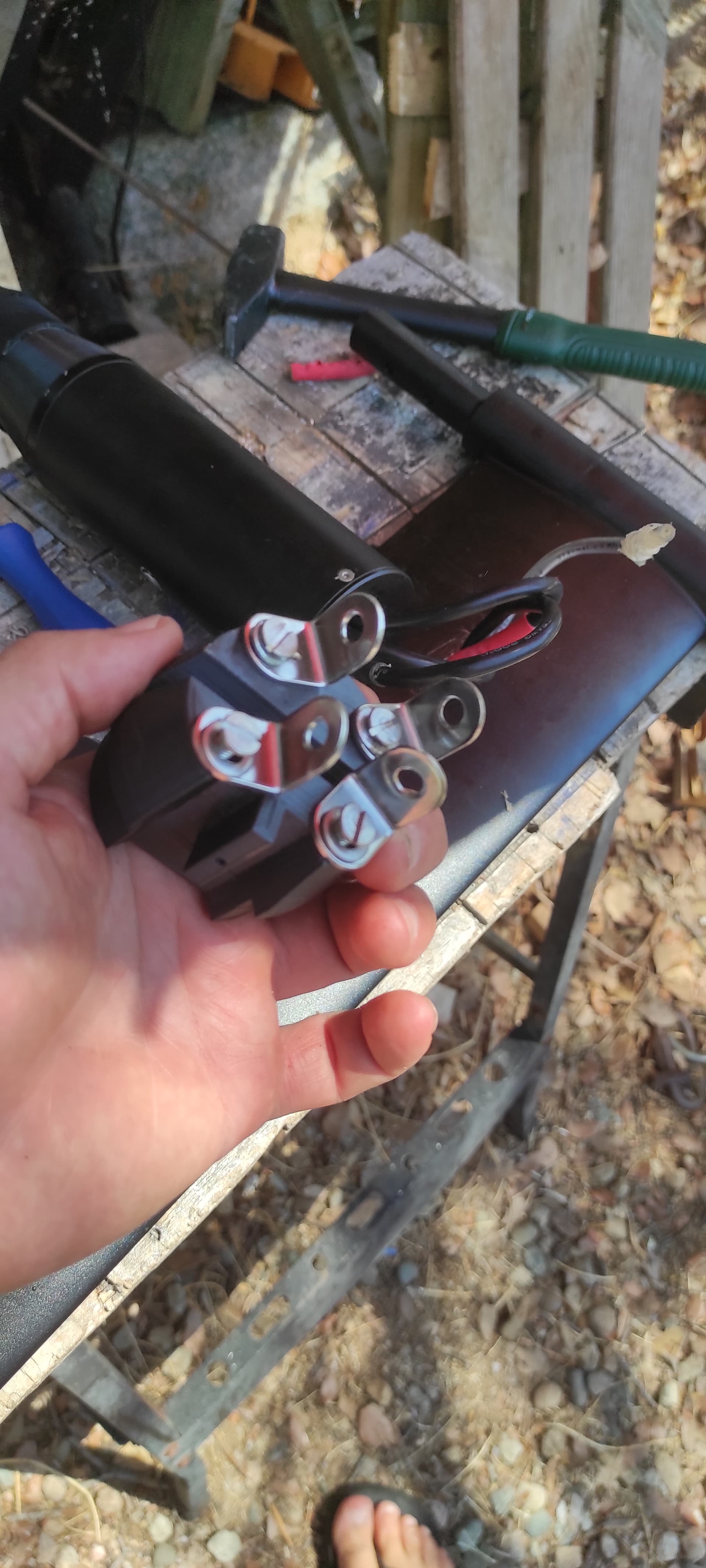

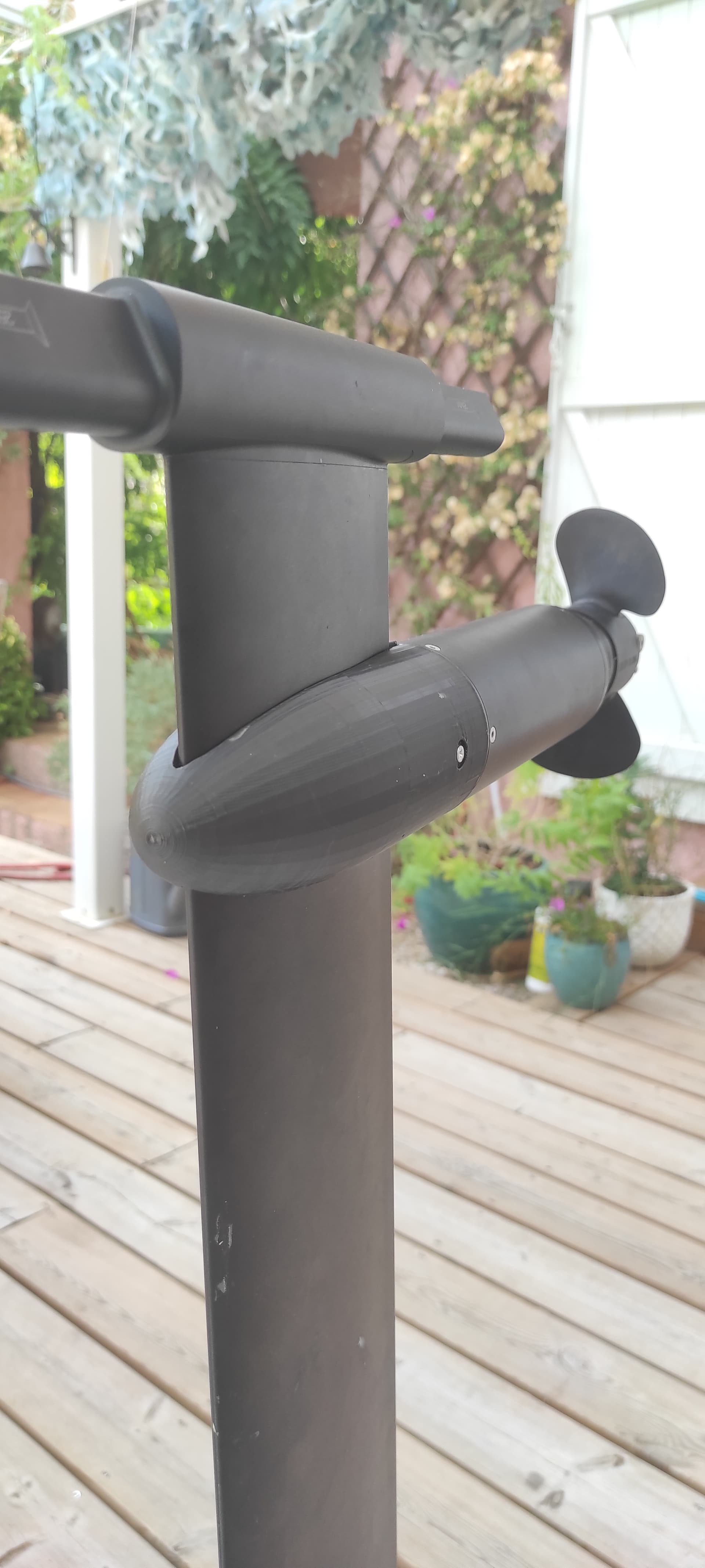

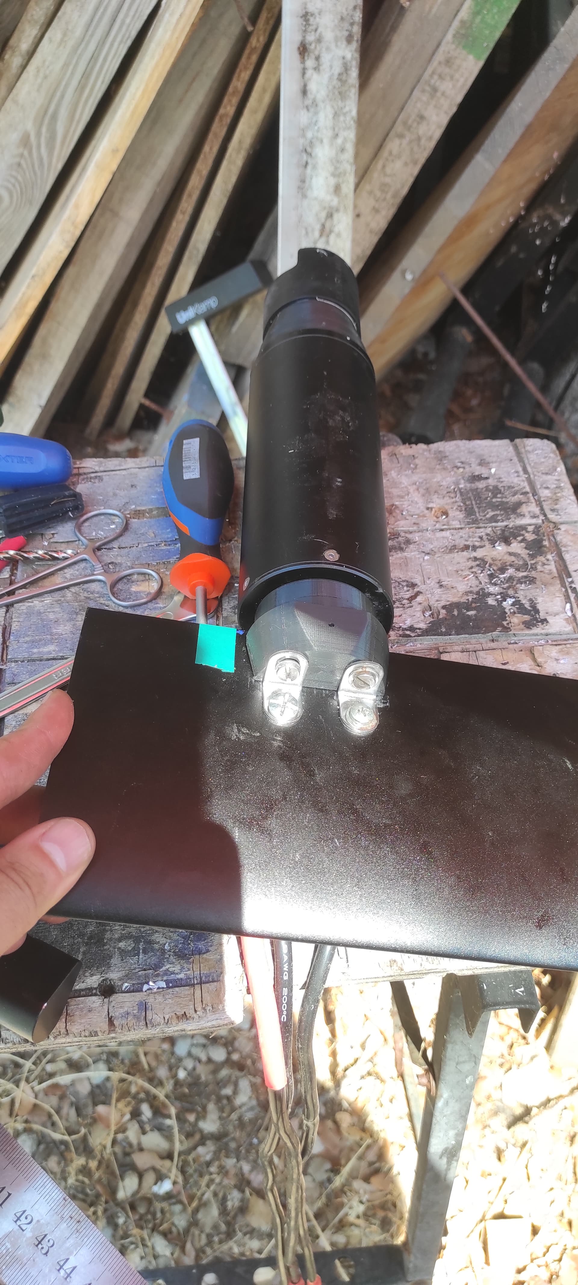

Thank you for the files, i decided to use your design for my new mast, v3 19mm, but i wanted a shorter pod, so i used small stainless brackets.
I will report when tested
Looks good @Alex2A , I am curious what propeller that is you have on there? Looks like a folding prop?
Yes it is. An easyfoil alu folding prop i bought here on the forum from @easyfoil.eu.
Very efficient
