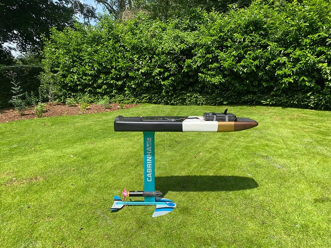

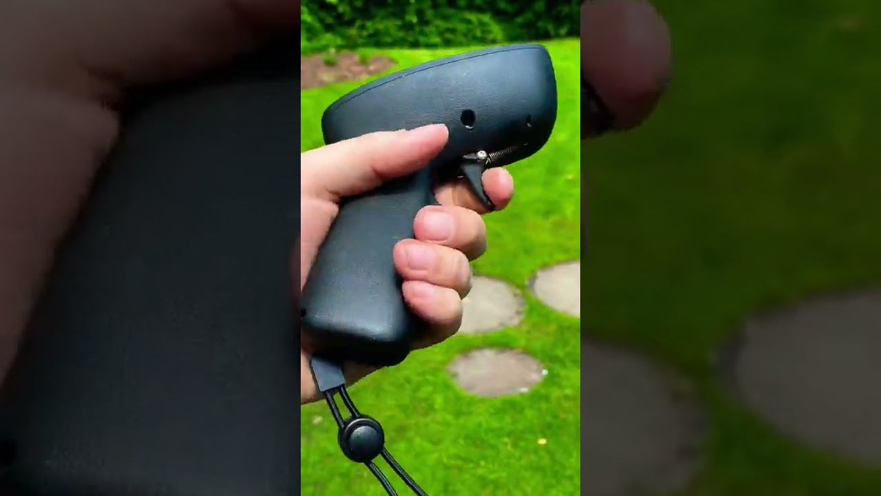

I am back! Felix from FeRo send me a Felix Remote which sparked the motivation for me to finish the hydrofoil. It has a display and GPS built in.
Today I mounted the motor. Now I need to print a cage around the prop. Have you got suggestions for the pest duct profile as well as strut profile and number of struts?
Ditch the duct, it just adds drag, regardless of the profile. Mast and wing are more dangerous than the the prop.
I agree. Forget about the duct and start flying
Its all done! Thank you for the support from everyone over the years. Lately especially from Felix Remote. They have a awesome product.
Below is a very short YouTube video. Full video is coming up in a few weeks.
