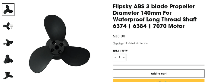

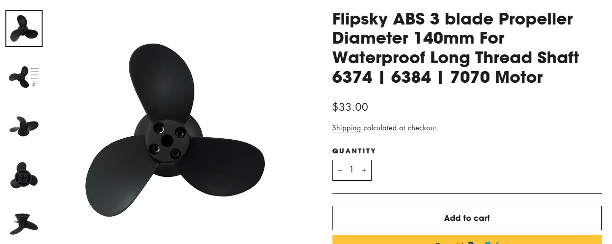

I’ve just seen Flipsky sell a 3 blade ABS prop for outrunner motor, is this new? Had anyone tried on their boogie. Says for long shaft but it also appears to have 4 screw holes.

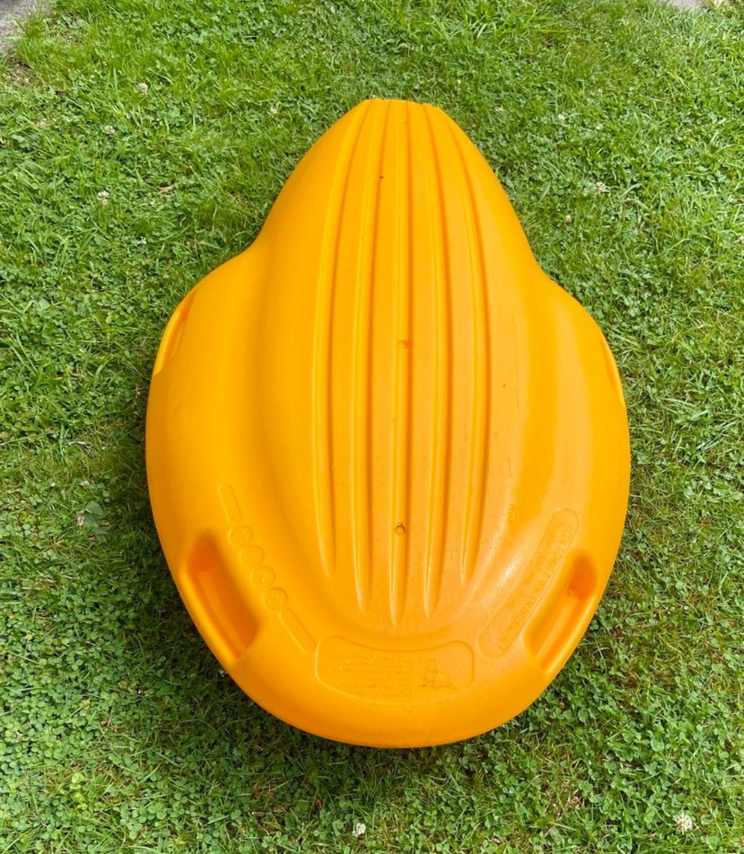

need to see the under side, biggest concern would be tail rocker or rounded underside causing it to suck down
Found these pictures. Looks like a pretty consistent rocker throughout the whole underside - so probably not a good match. Maybe a plate attached underneath where motors are mounted and towing rope attached to flatten out the rear. Or some heat gun action.
From the buoyancy I’m thinking about using it the other way around.
This one might not be THE ONE. Anyway I like the idea of a small canoe type boat because they are way more solid than glas or carbon over foam and you won’t have to worry about scratches.

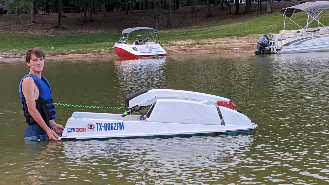

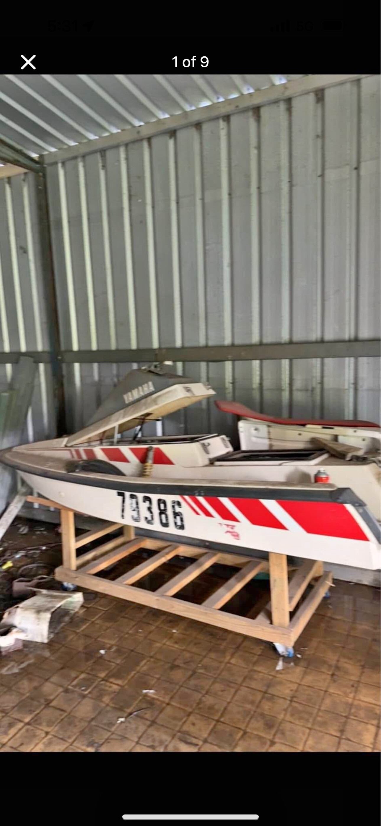

I’ve been thinking that a Kawasaki JS300 or 500 might be a good base. Smallest ski made, I’ve seen few hulls floating around.

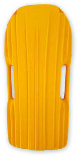

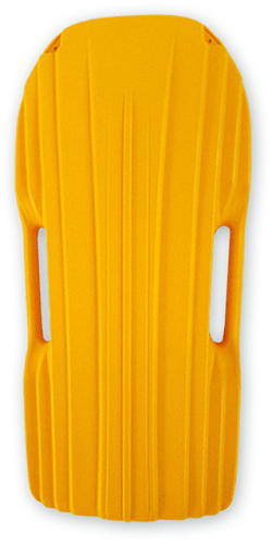

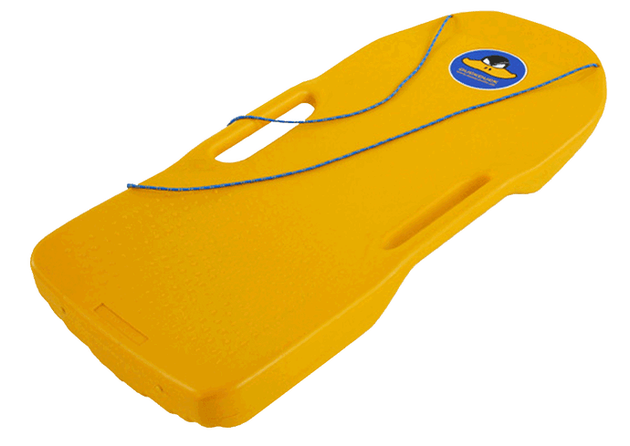

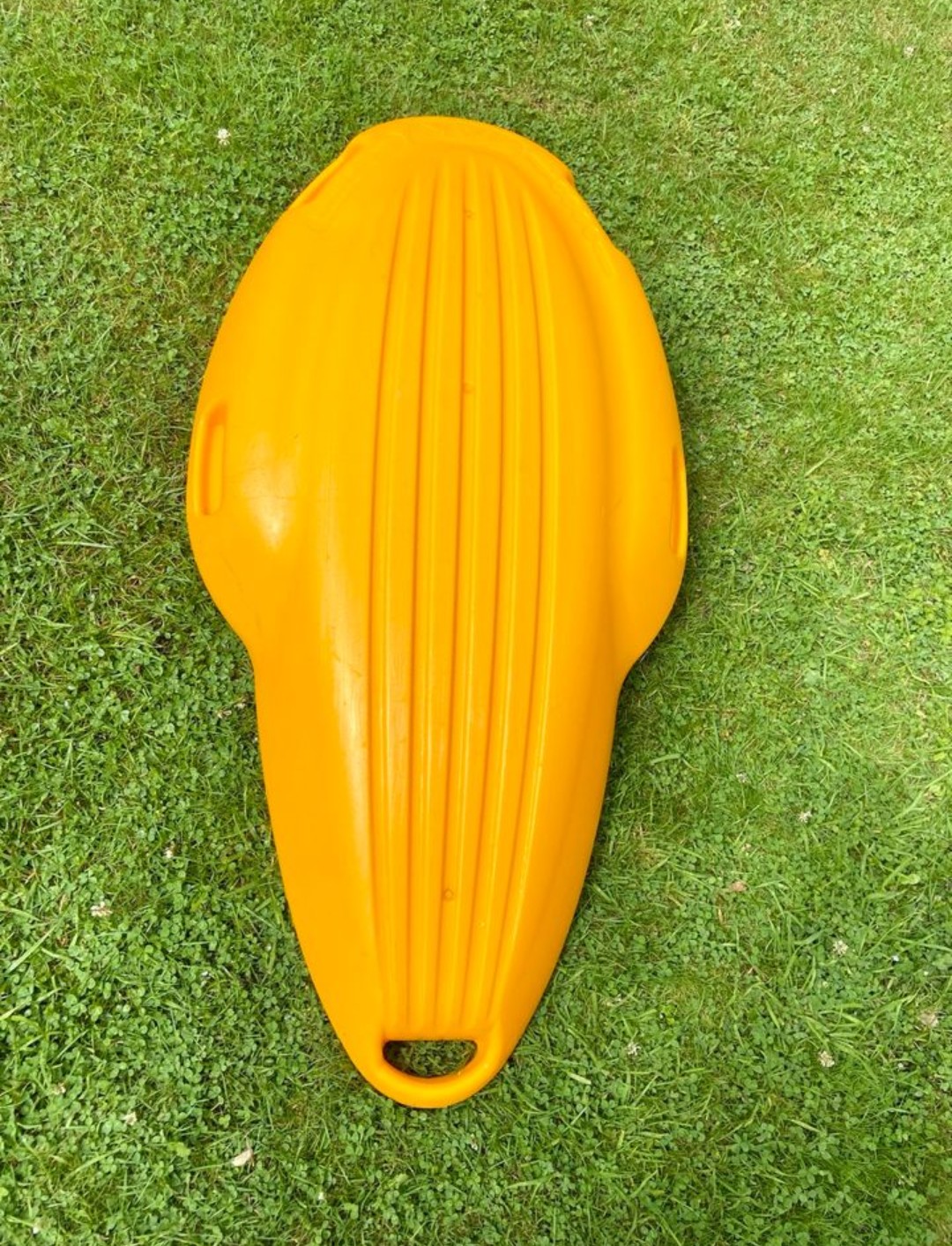

There are these really durable PE plastic sleds Made in Germany. Also possible to use as body board and approximately 40 Liters of volume.
That underside should be close to perfect at least for dual motors - not?

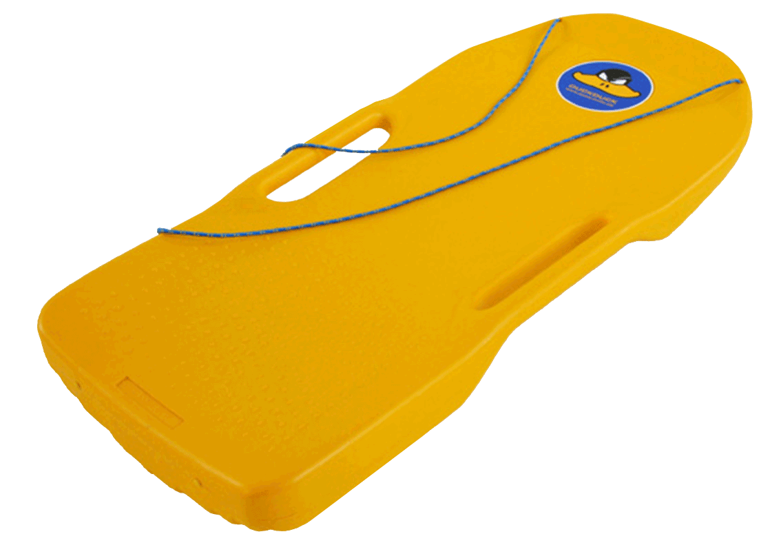

Good idea - snow toys!

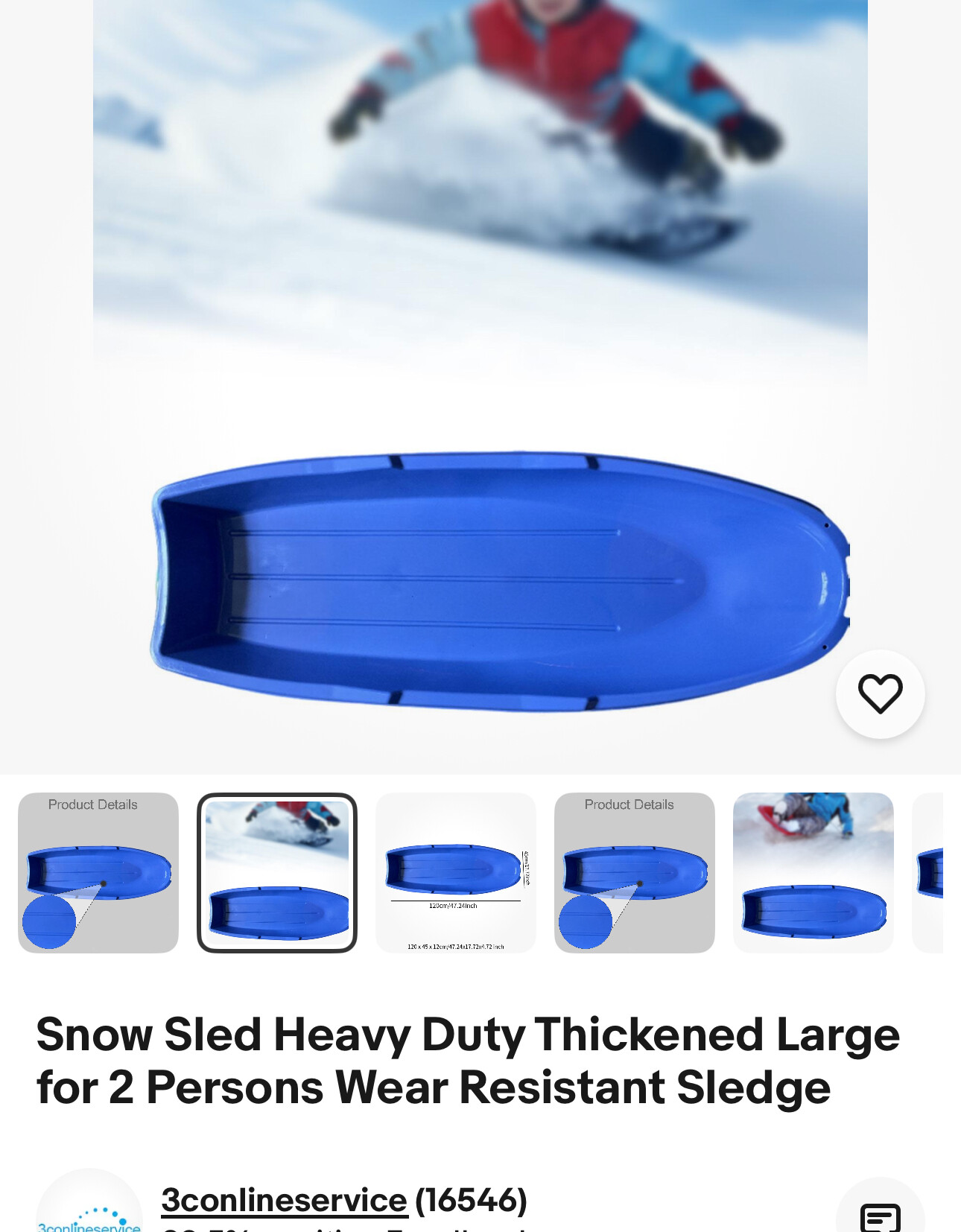

Here is a two person sledge that looks like it could be good with large custom foam inner around the case.
