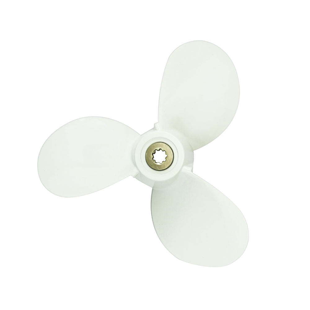

Have you considered trying the Flipsky prop that is too big for Efoil?
Yes I have to try it, can probably get one locally from a friend. Those are reported to vibrate quite a bit.

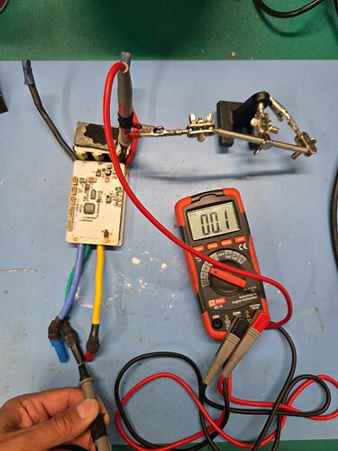

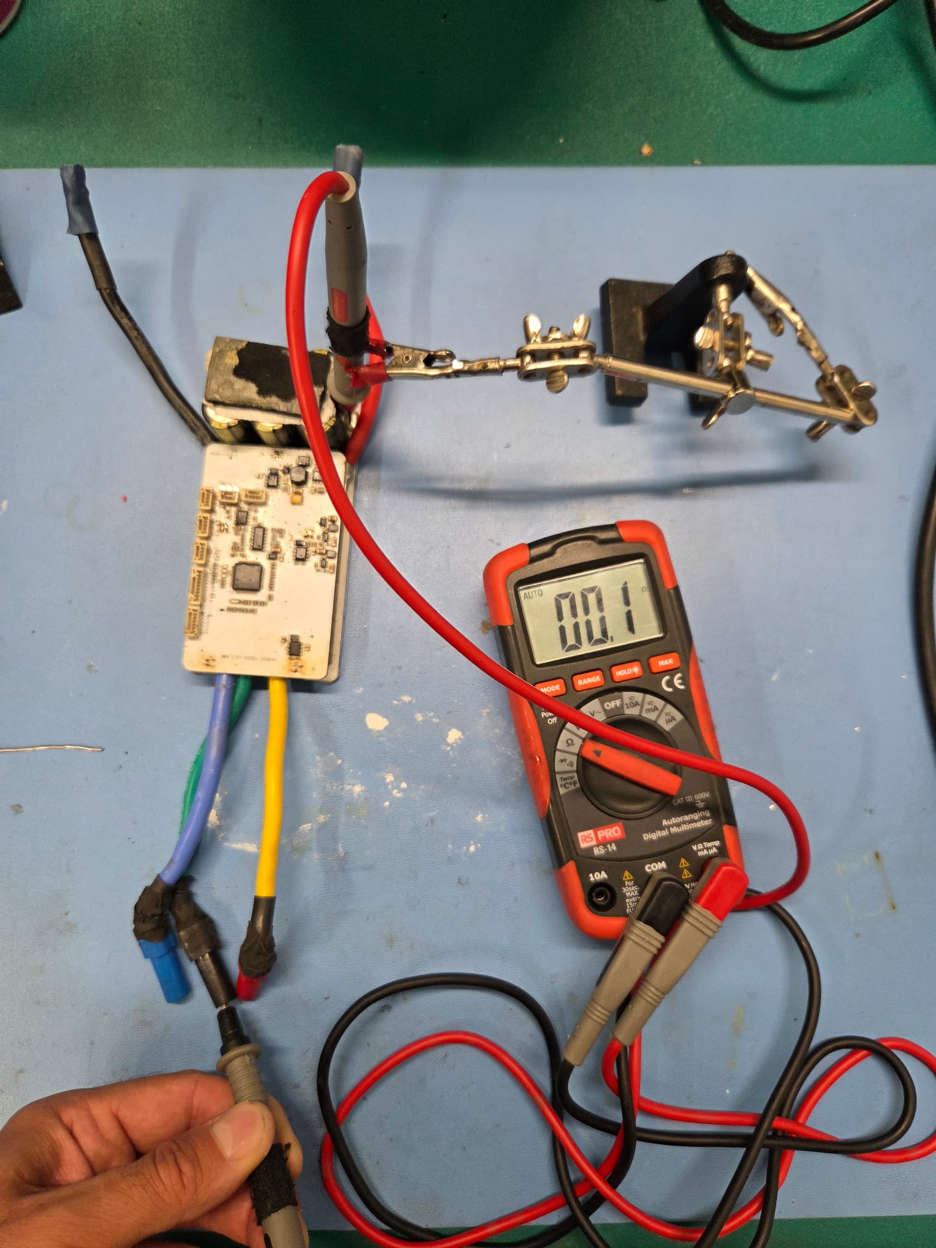

Turns out my session yesterday ended not because the battery were too low, but because the esc lost a phase
There are no visible signs on the fet, but it is most definitely shorted on the high side.
Will try to replace it, but separating both pcb is a pain in the ass on makerbase controllers and most two layer controllers.

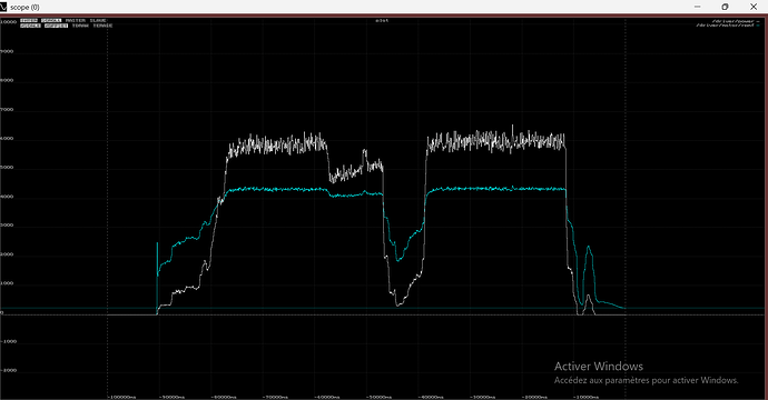

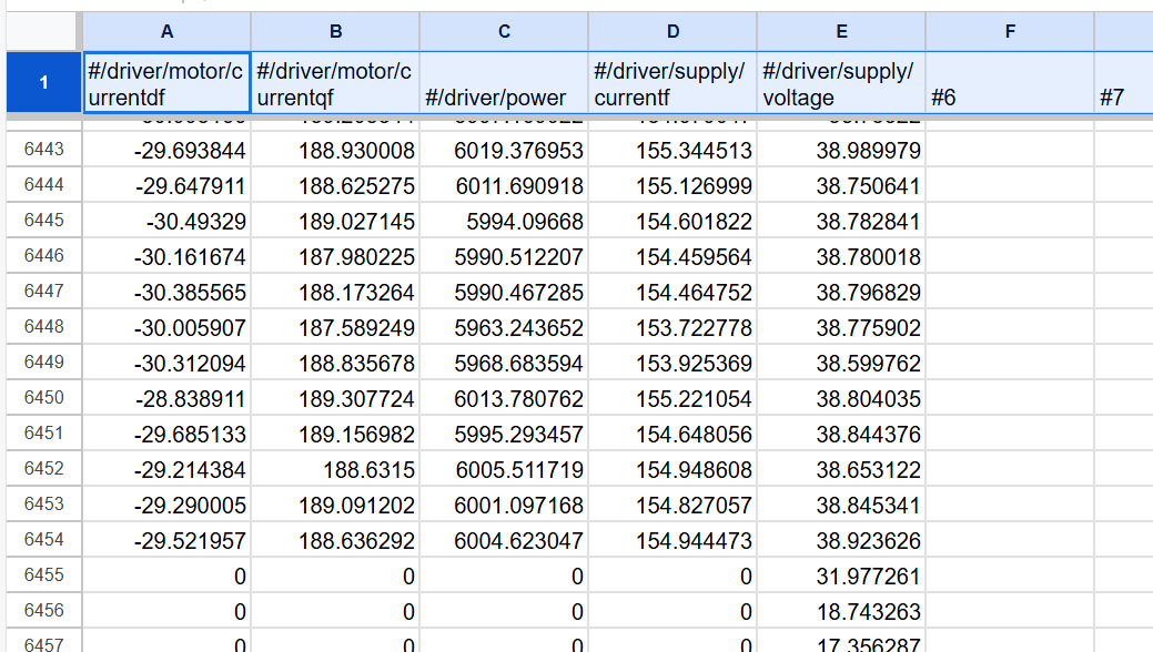

Got the first test on the silixcon controller done, config is not ideal seems like there is some saturation /desync going on at 50% throttle. Was better in bldc mode, but I would like to do some field weakening.

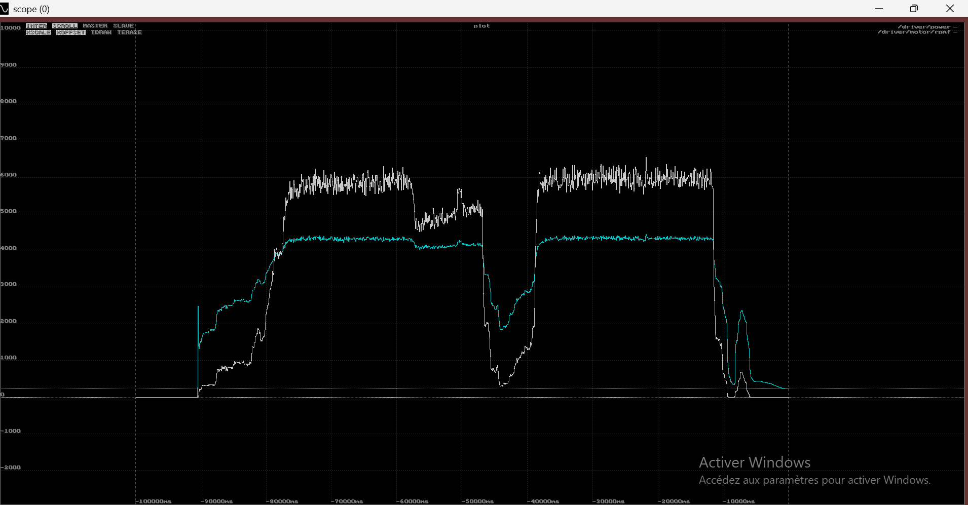

I used the new 3kwh battery mounted in a bow bag all the way to the front of the boat. Continuous power was set at 6000w.
Battery being hammered pretty hard :

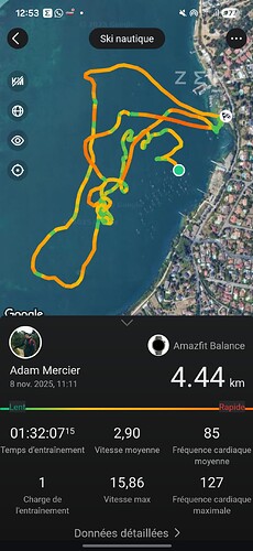

After fiddling with settings for a while, and low battery, I could get sub planning around 15kph, but not faster. What was strange is that the power did not drop at top speed. It seems that this combo would work better with more rpm/fully charged battery, will test again.

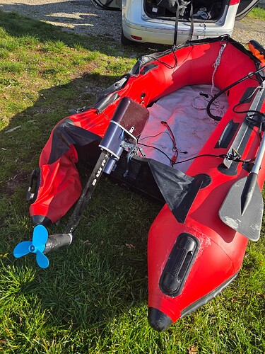

Tested a 175mm printed prop, but the flite remains better, smoother.

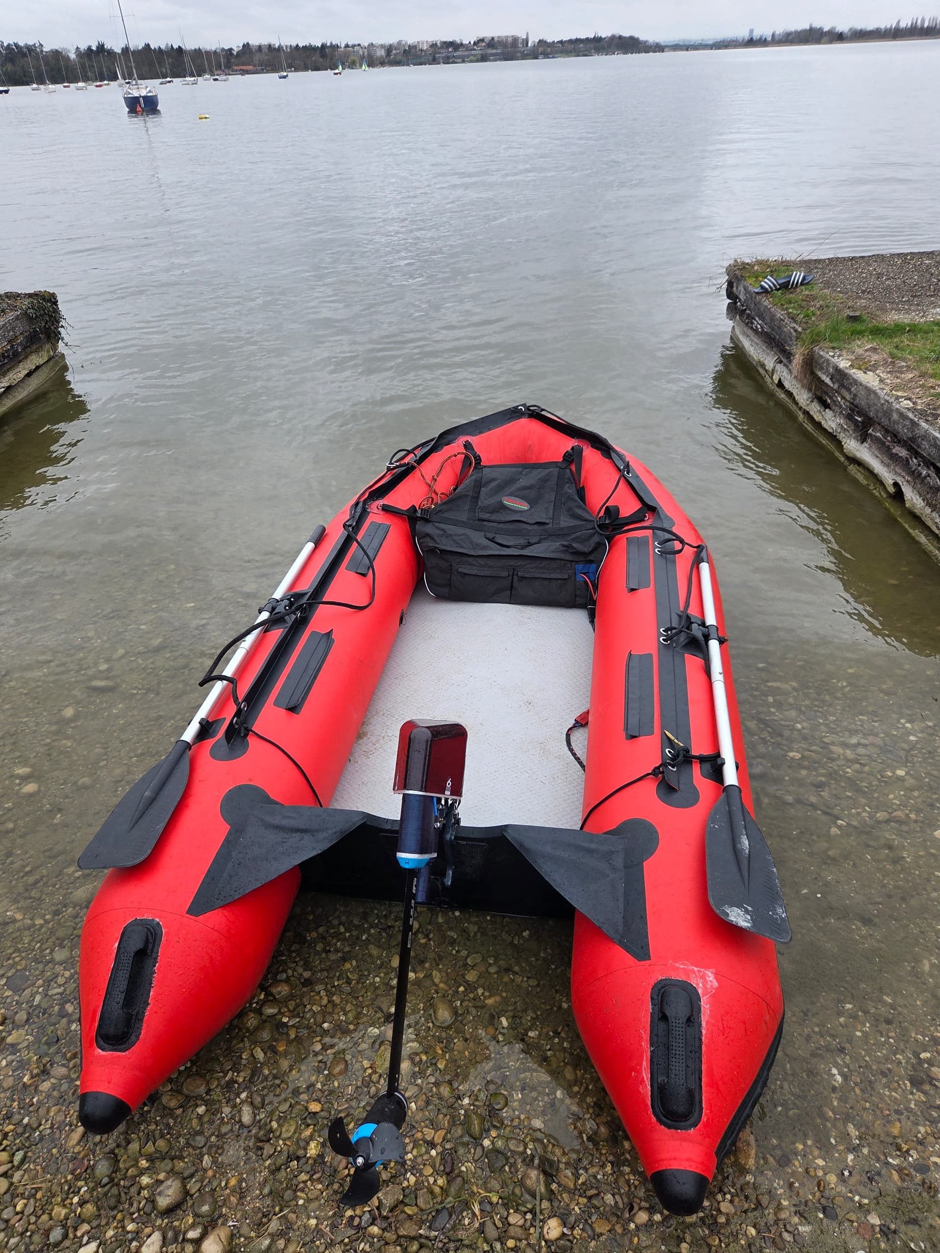

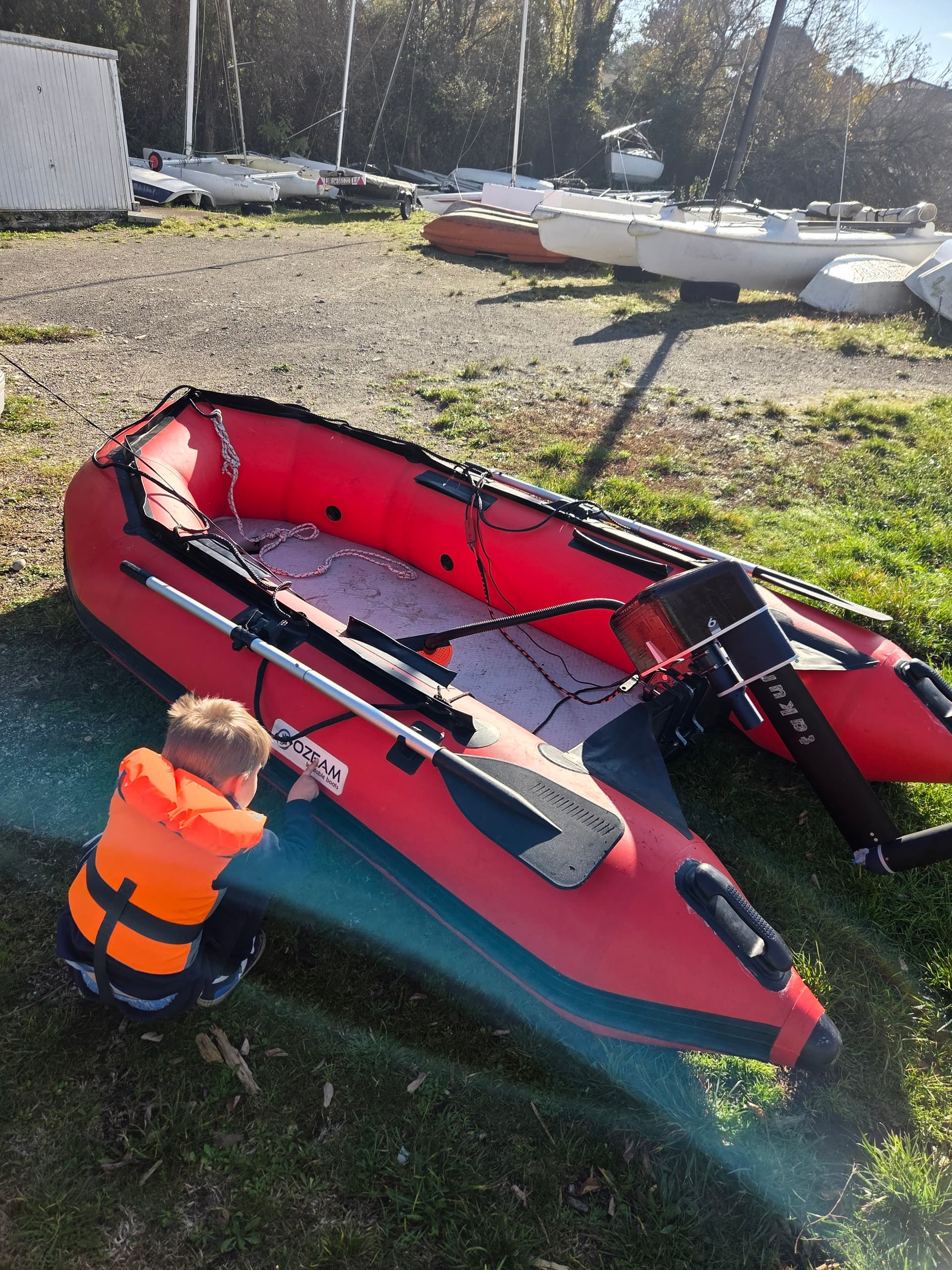

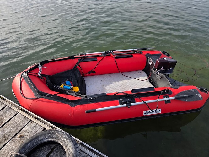

Setup is clean with the battery bag all the way in the front, and added parts on the motor to avoid wire tangle.
Reworked the battery (bms change) so i now have BT and working canbus.
Added dedicated attachement points to the hull for the bag.
I have quite a lot of play in the steering, need to re-tigthen it all, but assembly /disassembly is a pain, system is not optimized.
I was recommended another prop to try, in order to reach higher power.
Ready for next sessions, setup is clean for tow and family rides at displacement speeds. Next goal is to be able to get on plane with the family onboard, on glassy water.
