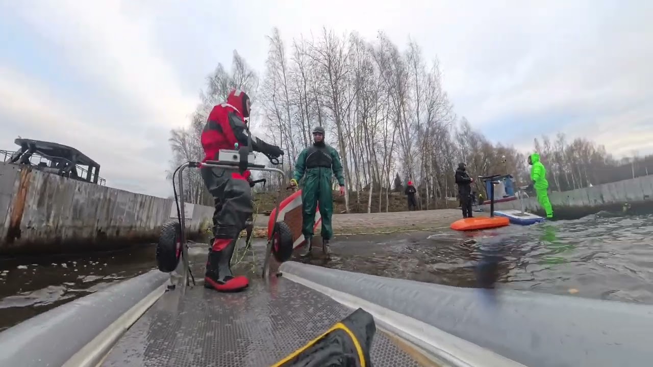

I am interested in seeing the tow bogie developpements here. But I feel the tow boogie concept is missing some features for safety, and social element.
This video was really interesting for men the tow boogie style gave me ideas :

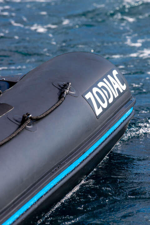

My idea is to make a 3.1 or 3.6 inflatable with V-shape hull into a tow bogie/electric boat hybrid. 3 use cases :
  • use it with the remote as a boogie
  • ride in the boat and tow another rider
  • use it with the family (my wife and my son) in lakes and river during summer.
I am not sure how it would to compared to a jet ski in smaller/non breaking swell.
With this kind of build, I could venture much further away than what would be reasonable with a tow boogie, to find some sandbank waves and swell, or to use as a shuttle/safety boat in downinds (battery++) Also, not going alone, for safety and enjoyment.
Exemple boat, that I found for sale in good shape for 800€ locally :
