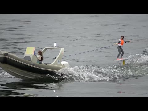

I have scratch built my own rib and outboard motors, so i was looking for a new challenge when i came across wake foiling, perfect.
Looks fantasic. Nice Job.
What kind of underwater connection between surfer and boat did you use? Carbonrod?
Thanks, 12mm carbon tube, roll wrapped.
A bit too active in this video, read my description on u tube. Today is testing day for a complete rethink of the engineering.
One carbon tube inside another creates the bearing, an aluminum collar limits the angle of turn. The mast is getting a streamlined part to slide down over the round carbon tube to stop the spray off the back. A push on tail fin to improve tracking, i can have a bigger one to hand if this one is too small. A lot of foils have rolled down outer edges, anheadral, what does it do? Guessing it gives more lift.
