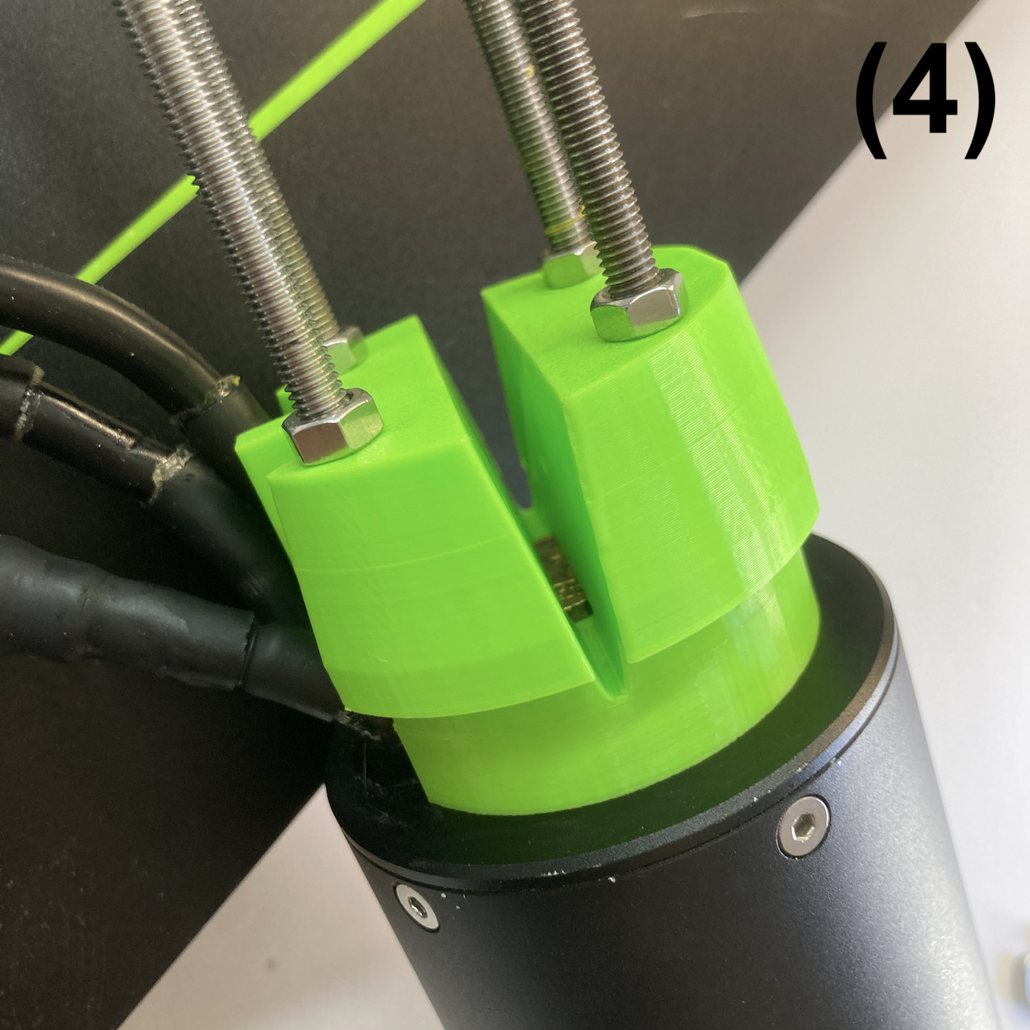

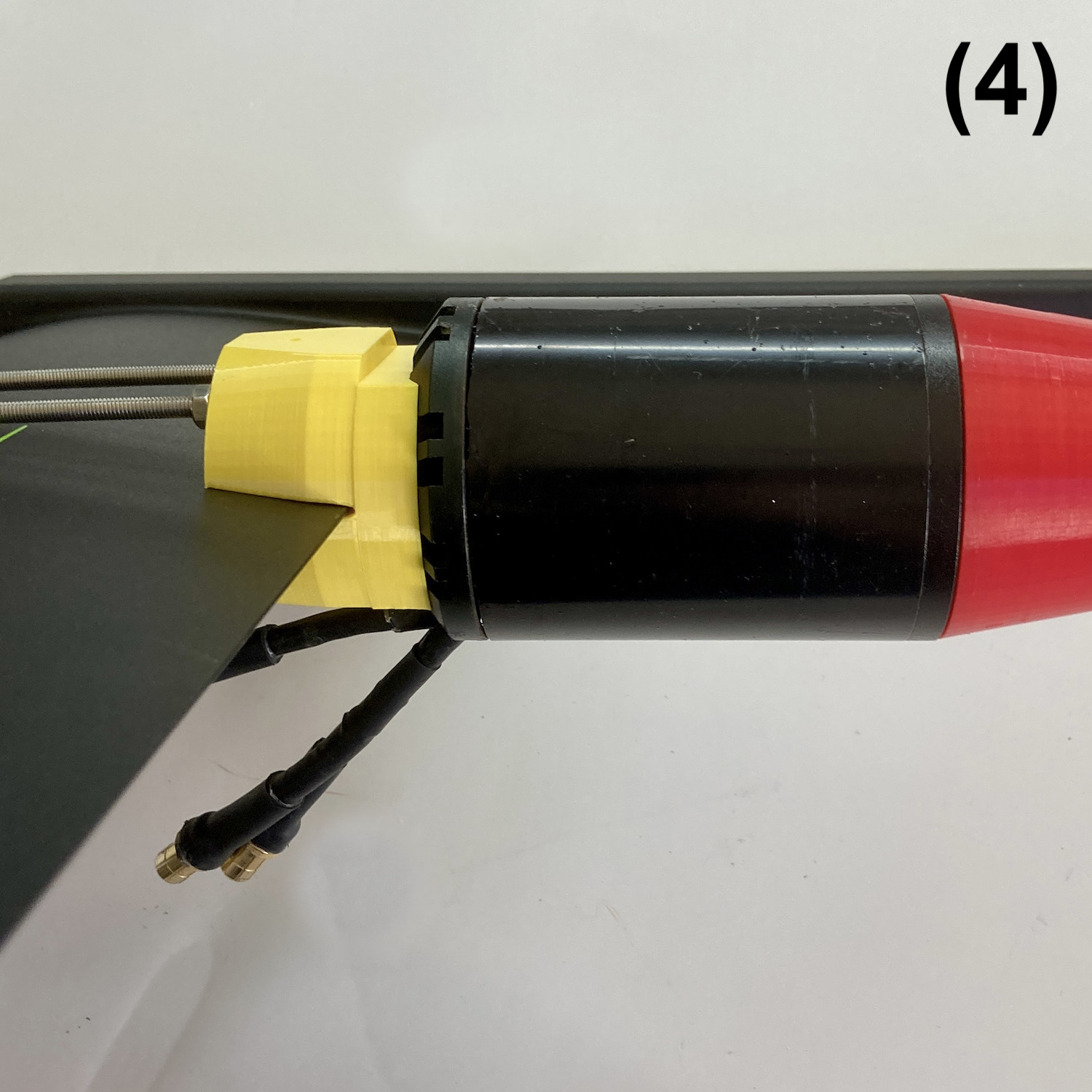

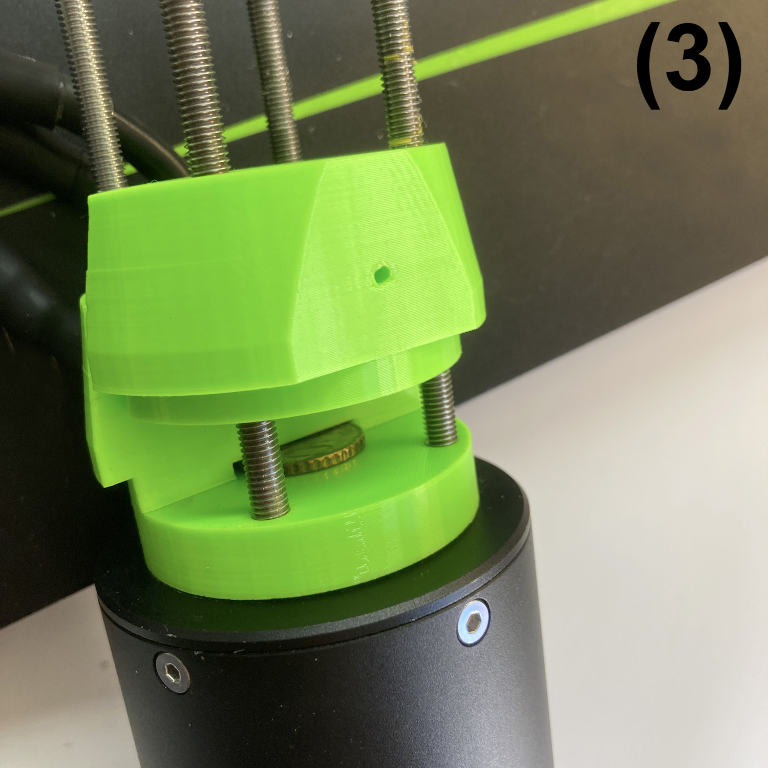

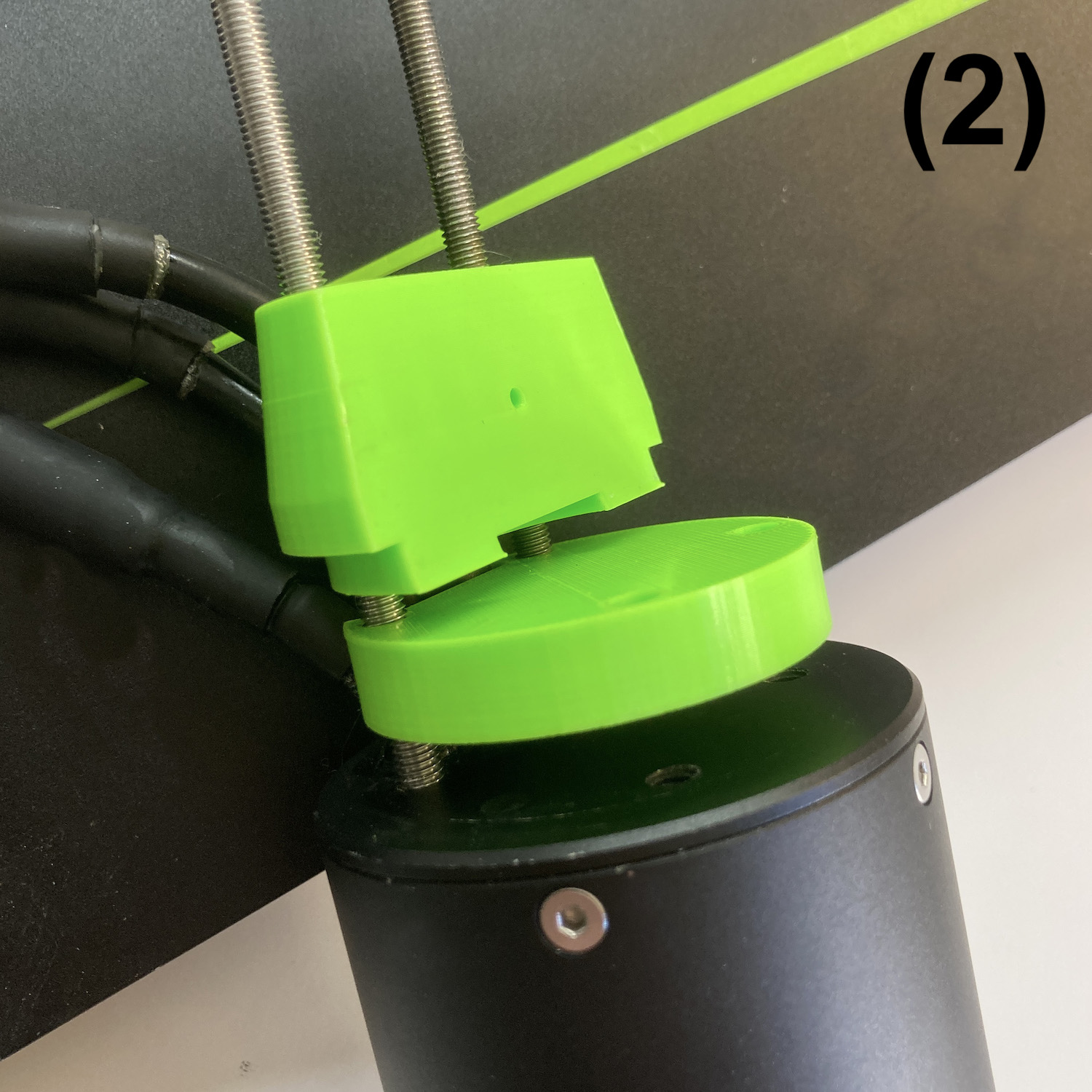

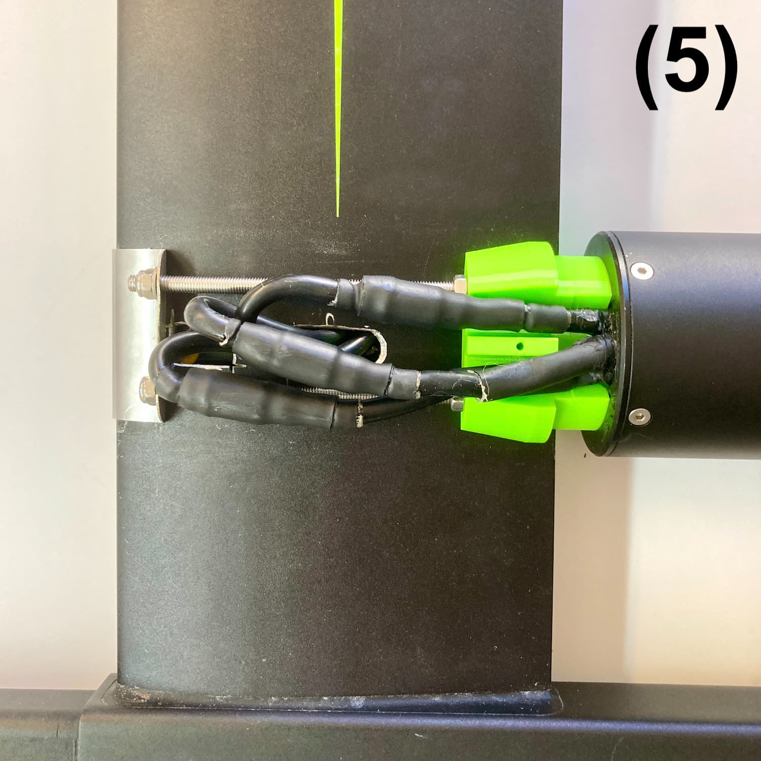

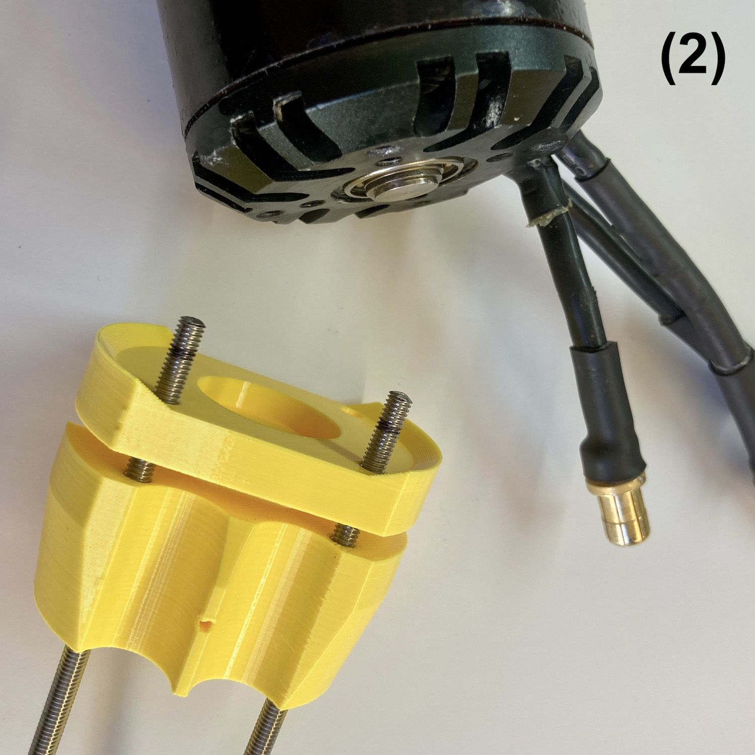

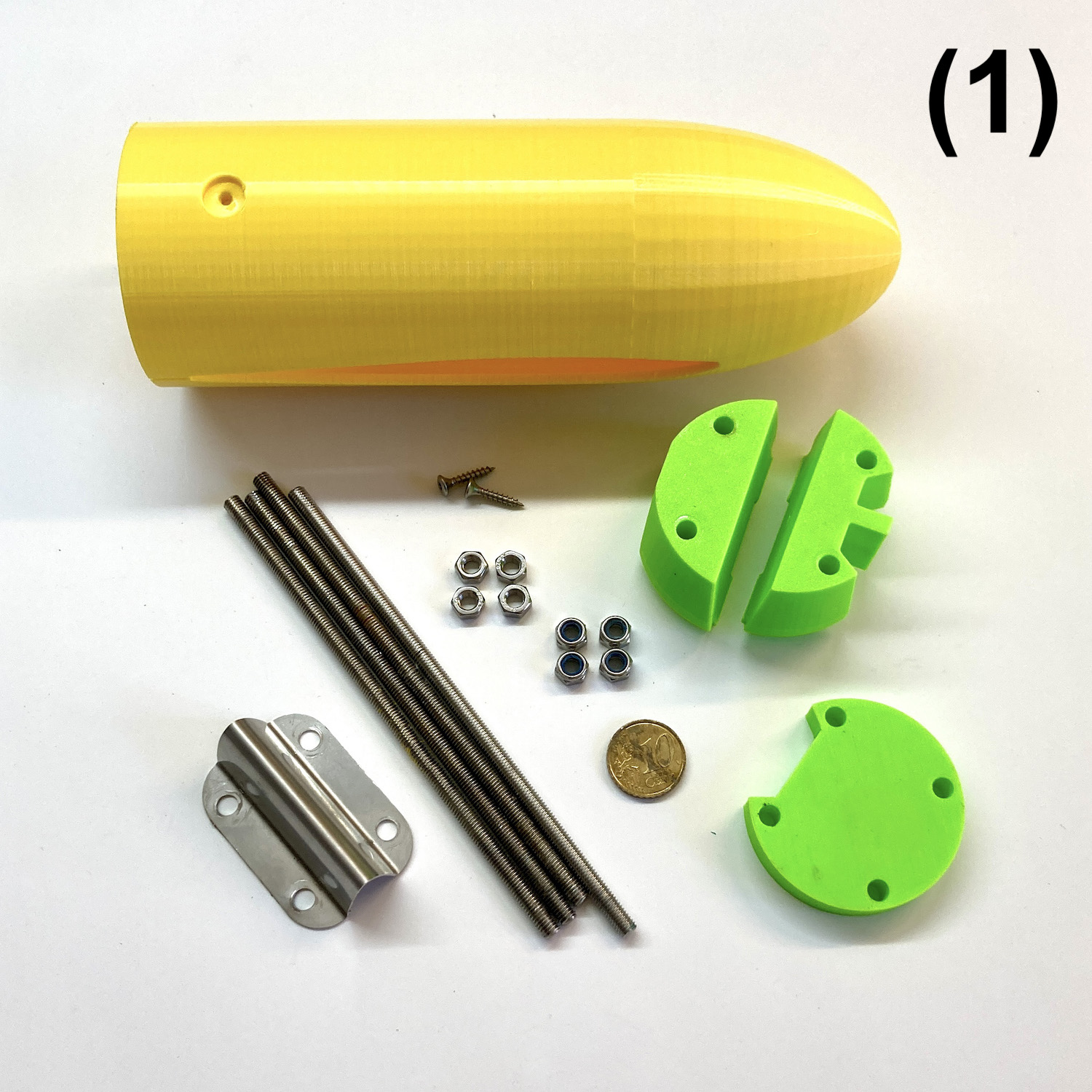

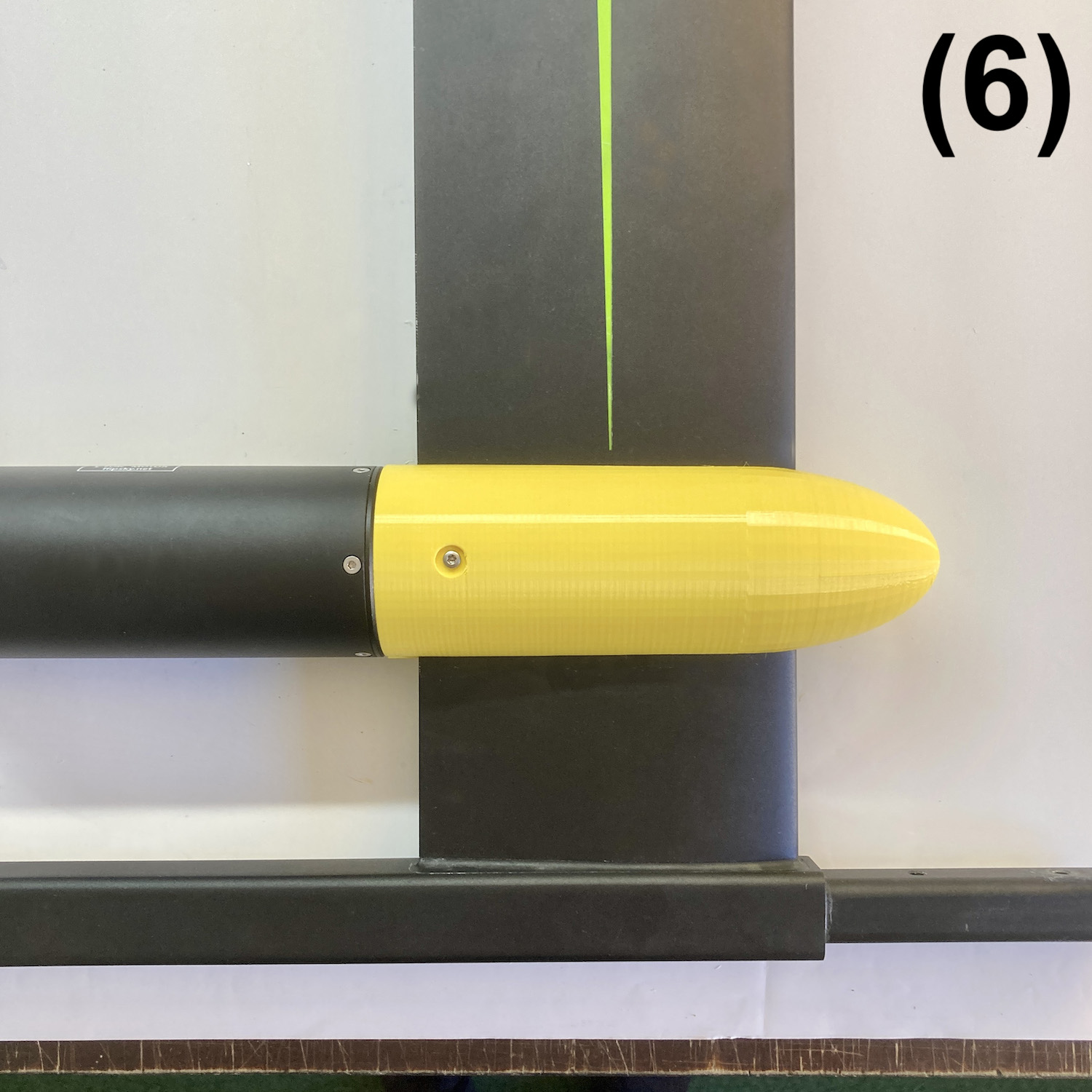

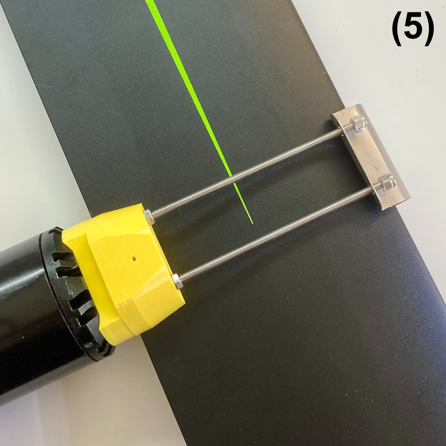

I know there are quite a few designs, variations, versions … after countless modifications I’m sharing my clamp design for mounting a Flipsky 65121 (or similar) or a 63100 to a Gong v2 mast: simple yet strong. I call it the “10 ct clamp” because an important part of it is a coin: a 10 ct Euro, a Dime or anything around 20 x 2 mm will fit. It withstands all the force, the plastic just holds everything in place.

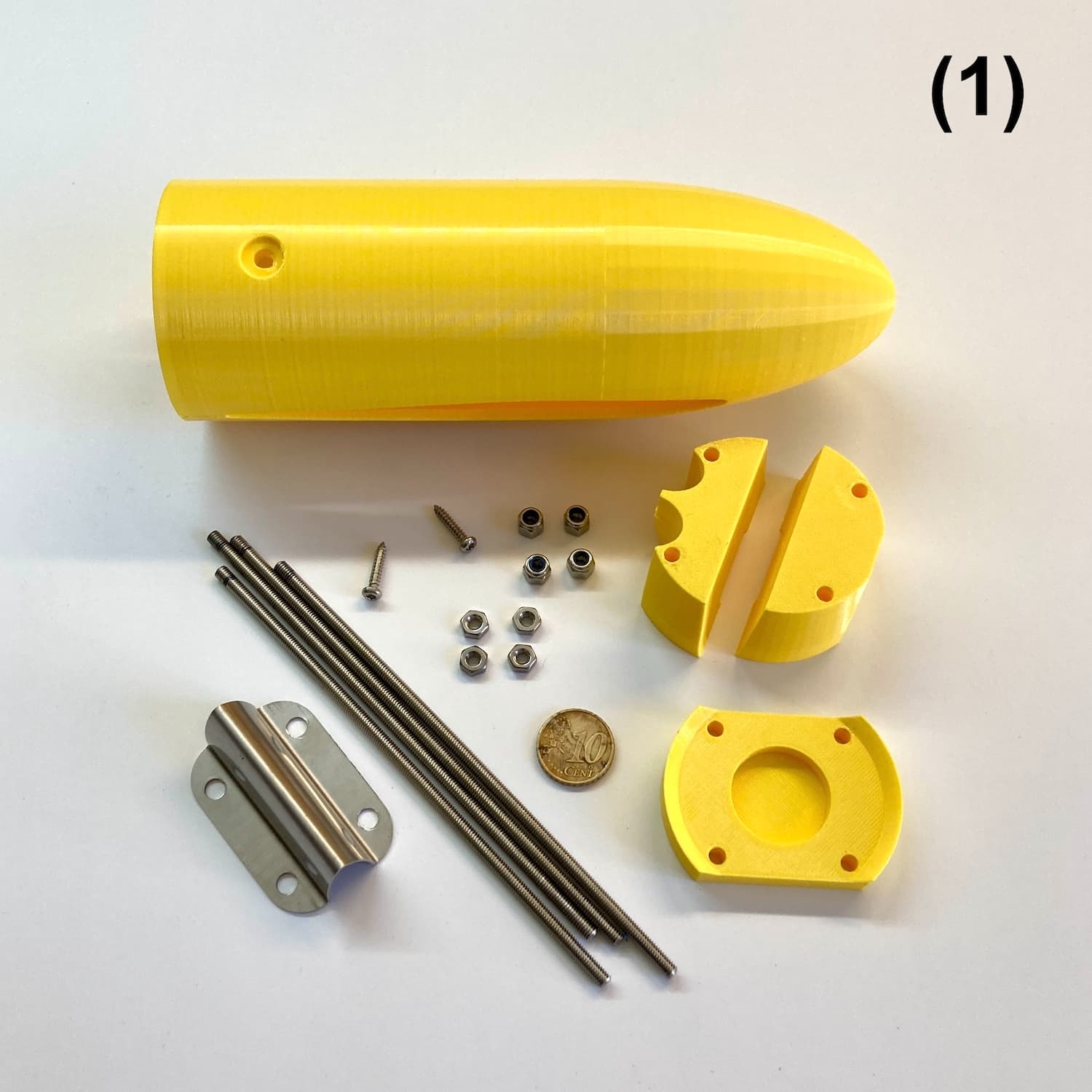

Apart from a 3d printer, you will also need (63100):
  • 4x rods length 140 x 4 mm
  • 4x M4 nuts + 4x M4 self-locking nuts
  • 2 screws for wood / self drilling, 12 x 2 mm

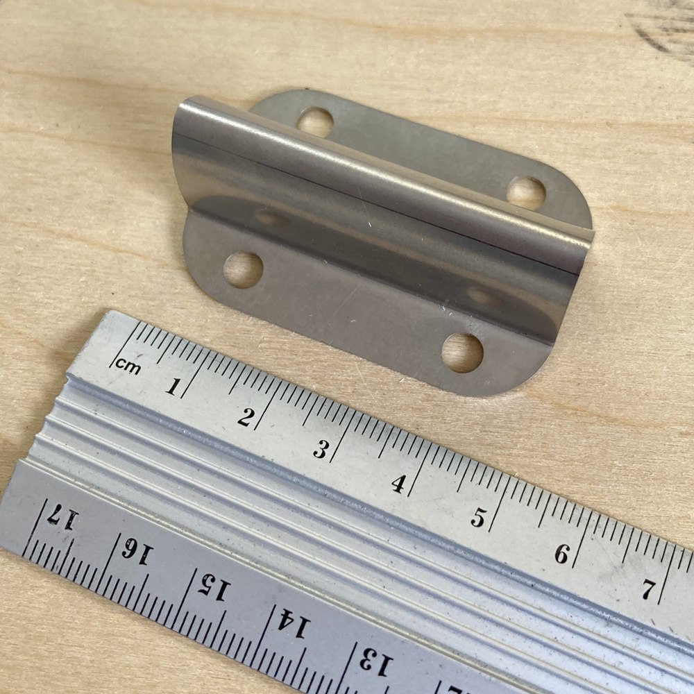

  • a clamp made of metal sheet
Or analogue for 651xx:
  • 4x rods length 140 x 5 mm
  • 4x M5 nuts + 4x M5 self-locking nuts

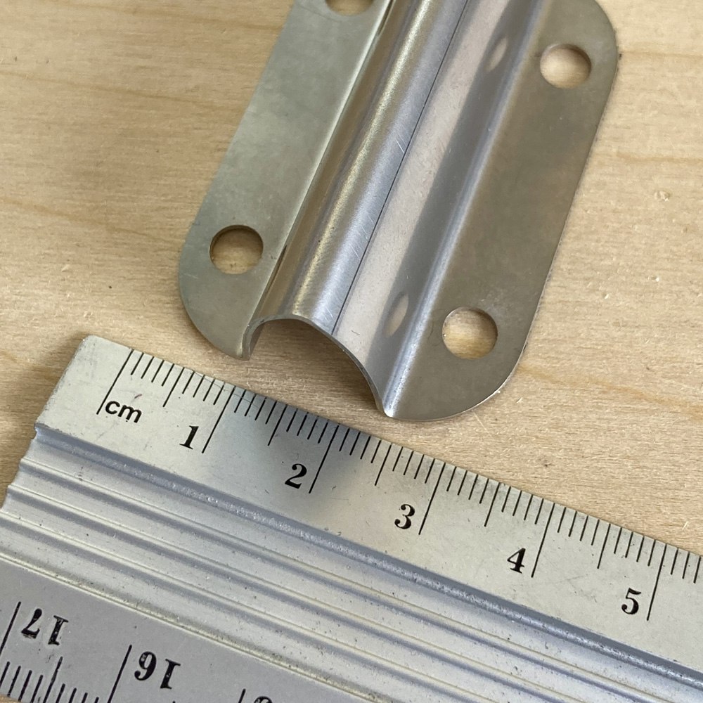

All stainless steel of course. I’ll let the images speak for themselfs. If you have questions, let me know. Here (63100) and here (651xx) are the 3d-files along with detailed description how to mount. I have used 0.7 mm metal sheet, this is more than strong enough and still can be cut, drilled and bent as needed by hand.
63100:
651xx:
Here two more pictures of the actual metal clamp:
