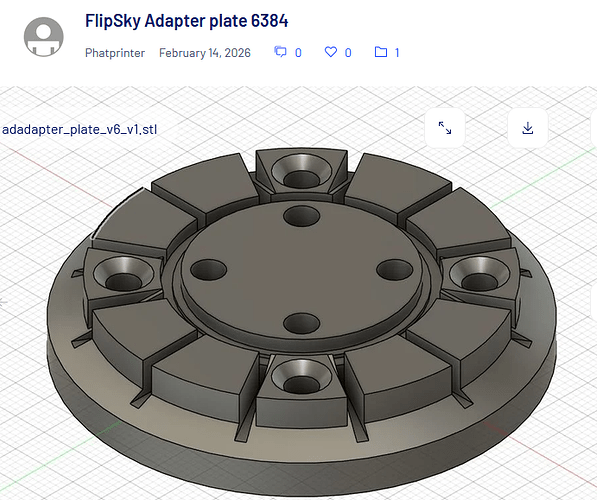

3d printable to make this prop fit an old style flipsky 6384

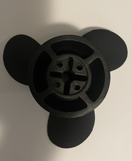

I’m very new to all of this and bought a 3 blade prop off of alibaba that looks to be for a new style 6384 motor and I have an old style 6384 motor. I didn’t even realize there was a difference. Just wondering if this adapter would make it work or if there is something else out there?

so for 20 bucks I had one printed, ordered heat sink inserts, will post if it it works or not
Do you have a link to the prop to check it out? Good luck with your project!
Flipsky Abs 3 Blade Propeller Diameter 140mm For Waterproof Long Thread Shaft 6374 | 6384 | 7070 Motor
I see now I ordered a wrong prop being I don’t have a long shaft motor
My adapter plate will be here soon so maybe it works maybe not
holes on the adapter plate lined up fine, need to figure out which length screw will work, however I just received a new flipsky foldable 2 blade prop. The shipping didn’t take too long from wherever they are to NY. Its aluminum so I doubt I will have need for a different prop.
