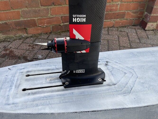

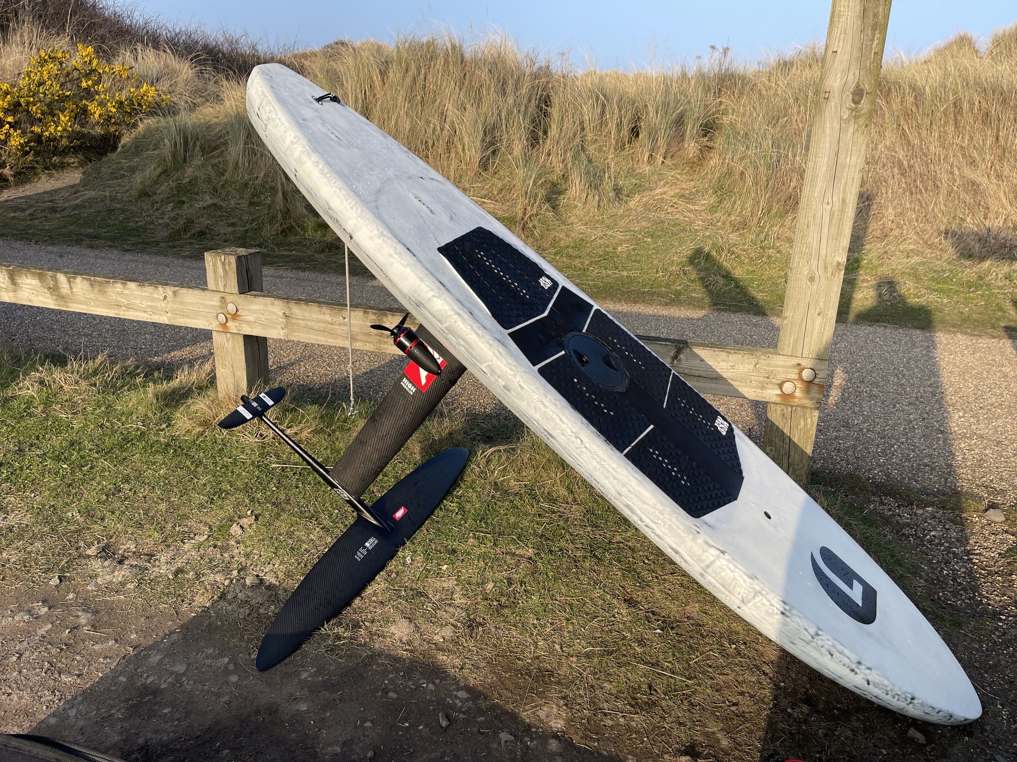

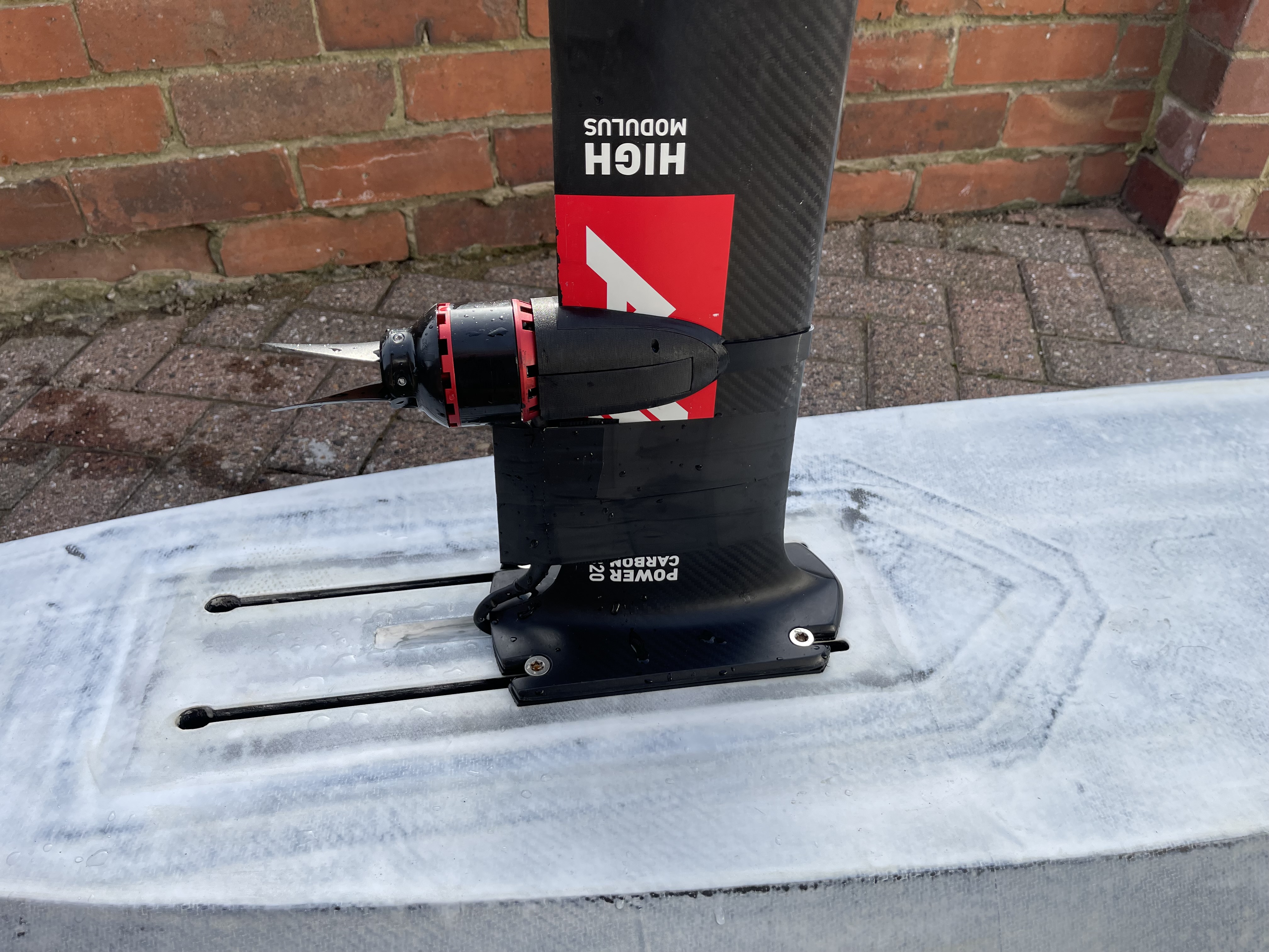

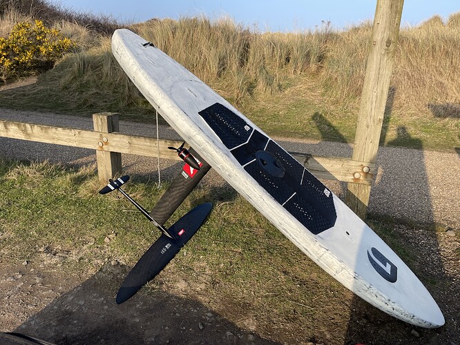

I use a 6354 for foil assist on my sup foil board. It is a 120kv model though. With a small 2 blade prop it works well as an assist with a 12s battery. I love it on the sup foil due to the reduced weight compared to the standard 6384 people use. It will not allow you to foil around in between waves though. It does not have enough thrust for that so probably not a great motor for a prone.
which prop do you use? I am kind of curious about the propeller choice since according to the power charts i have found online, a regular 6384 140KV can provide around 3,7Nm for 57A and a 6354 tops up at 1,4Nm. I like your concept of a very light setup
I use the genuine foil drive props set up with a two blade hub.
