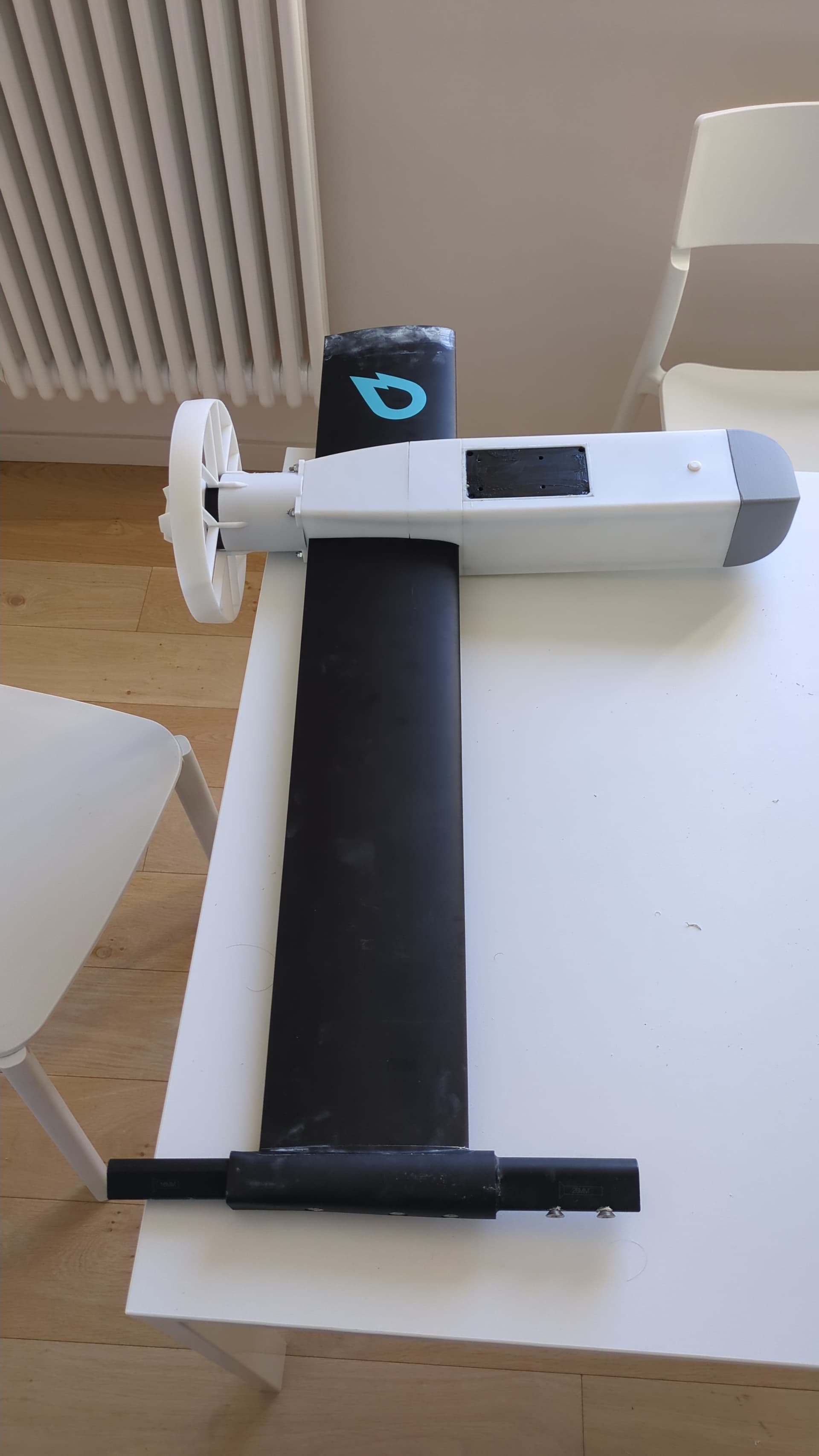

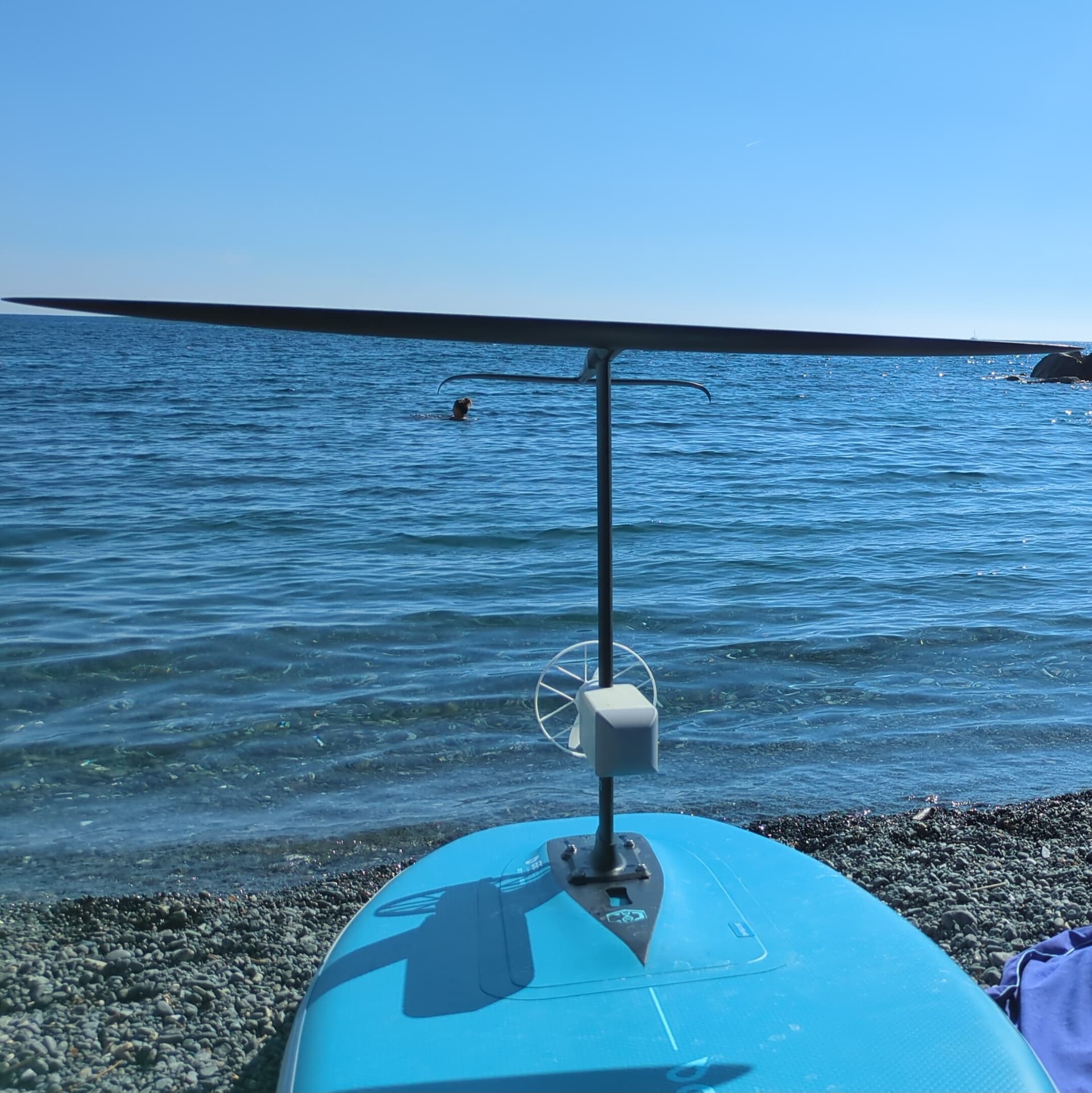

Sharing my own design:
  • all components integrated in the motor pod
  • 2 6s1p off the shelf 21700 battery packs
  • Daly 40amp bms
  • 75100 vesc
  • 6384 motor
  • prop guard
  • gong V3 19mm mast
  • I filled all electronics with two-parts silicon resin
  • vx3 remote
  • antenna runs up inside the mast
  • spanmaxiing propeller from rctestflight YouTube channel
Vesc configured at max 28 battery amp
I could fly, barely. (I weight 95kg)
Next step, I will be testing some RC plane propellers to try improving efficiency.

At low speed I think it is not that impactful. The frontal cross section is very similar to the one of the motor.
Hard to test the difference compared to the motor pod alone. Would be interesting to run the numbers on drag differences between a long pod and a short one.
Maybe a better an engineer than me :wink:
Yes, as @rttn noticed the shape, the front cap could be shaped longer

Prwtty easy to test actually. If you have a flowing river, take a fishing scale and attach a rope to the board with different variations on the board and measure the drag. That way you can get and indicator on what the difference is.
Really interesting build! Did you try out a different prop? Is the housing 3d printed to precisely fit the v3 19mm mast?
Yes, It Is printed to fit precisely!

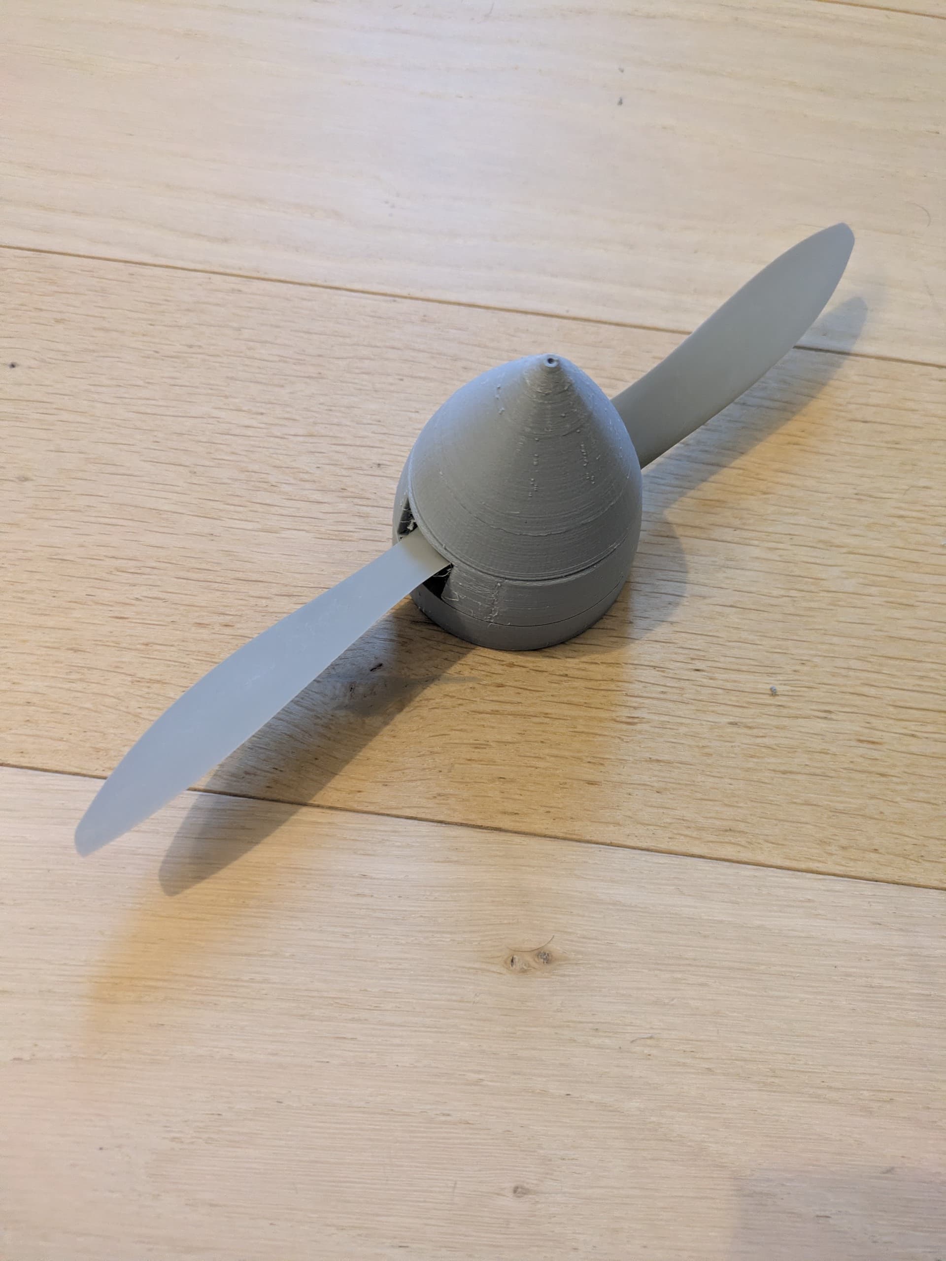

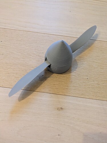

Also a sneakpeak on the props I will be testing:
Thanks @gioclava very kind of you!
Interesting idea to use RC plane props. I’m curious to see the results :smiley:
Very interesting with these props.
Do you think you also can share the 3d files of prop to motor mount, different props (the ones from RC test flight) and which RC-plane propellers you test?
I am attemping to do a build with the same motor and 13s battery. To get decent efficiency my idea is to test quite a few propellers and get the motor to run in a good RPM range.

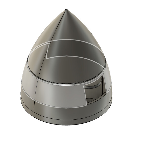

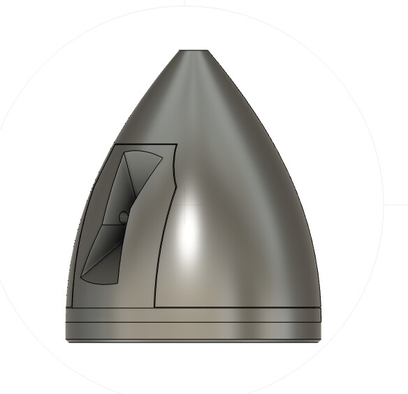

I made two models:
  • for fixed RC props (need M6*35mm bolt and nut)
  • for foldable RC props (need 3mm rods and 3mm screw)
I have a feeling that foldable props won’t be sturdy enough and probably snap, but I would love to test.
Best fixed props would be APC marine props, but they don’t seem easily available in Europe.
Next best choice seem Gas props (either gemfan or apc).
Here an example: aliexpress
I want to test 8to 11 inch sizes.
I added a folder here with the props adapter 3d files: foil assist - Google Drive

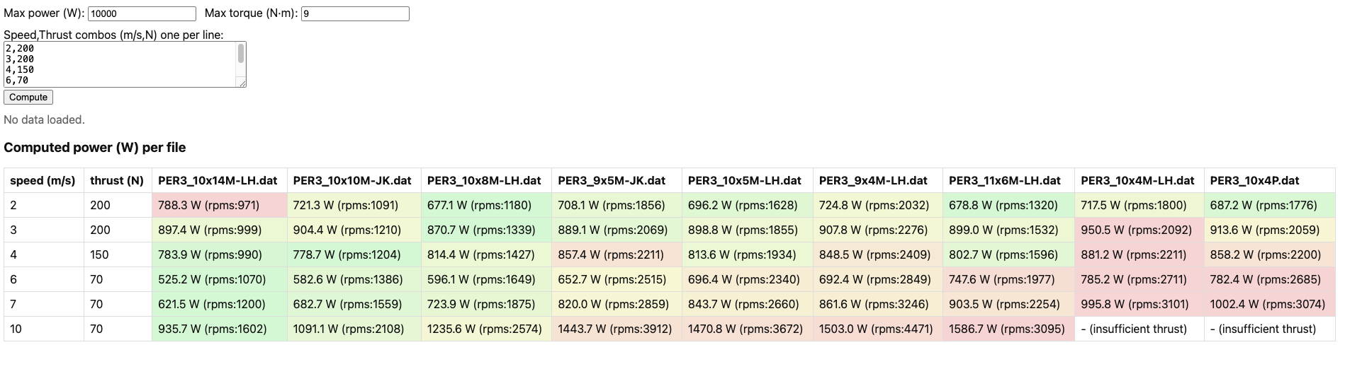

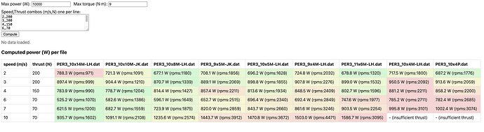

I used the data from APC website to calculate theoretical power draw for different props at different speeds and different thrust levels. This is not counting the electric motor and ESC inefficiencies.
Maybe interesting for someone:
I tested the 10x8 prop and I could take off with 1000w and cruise with 600w.
I could also take off with a 9x6 and 10x6 props, but they were making a bit of noise.
10x10 prop required too much torque and I could deliver only 700w which was not enough for taking off.
