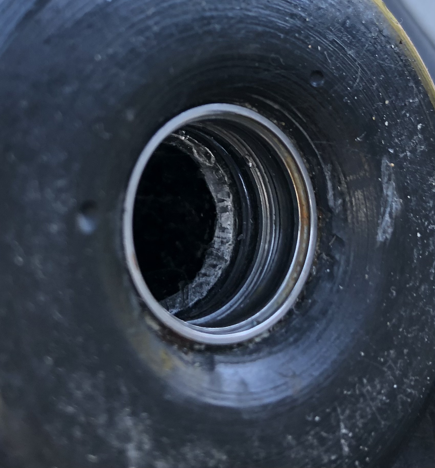

Im trying to remove 2 broken 6800 stainless steel bearings from a flipsky 6384 motor.
I broke the previous ceramic ones with hammer and chisel but these ones are stainless.
Has anyone figured out a clever way to remove them?
Thanks

My current plan was to cut an almost fitting piece of wood, put some epoxy on it, and hammer it in. And then hope that it will bond enough to get the casings out
But I’d love to see a better solution.
I also need to get the inner casing off the shaft.
Problem solved thanks to Joël from French diy group
I had exactly the same issue as bearings are glued (bearing fit), apply a little bit of heat with gas touch and once glue melts will come out easy enough.

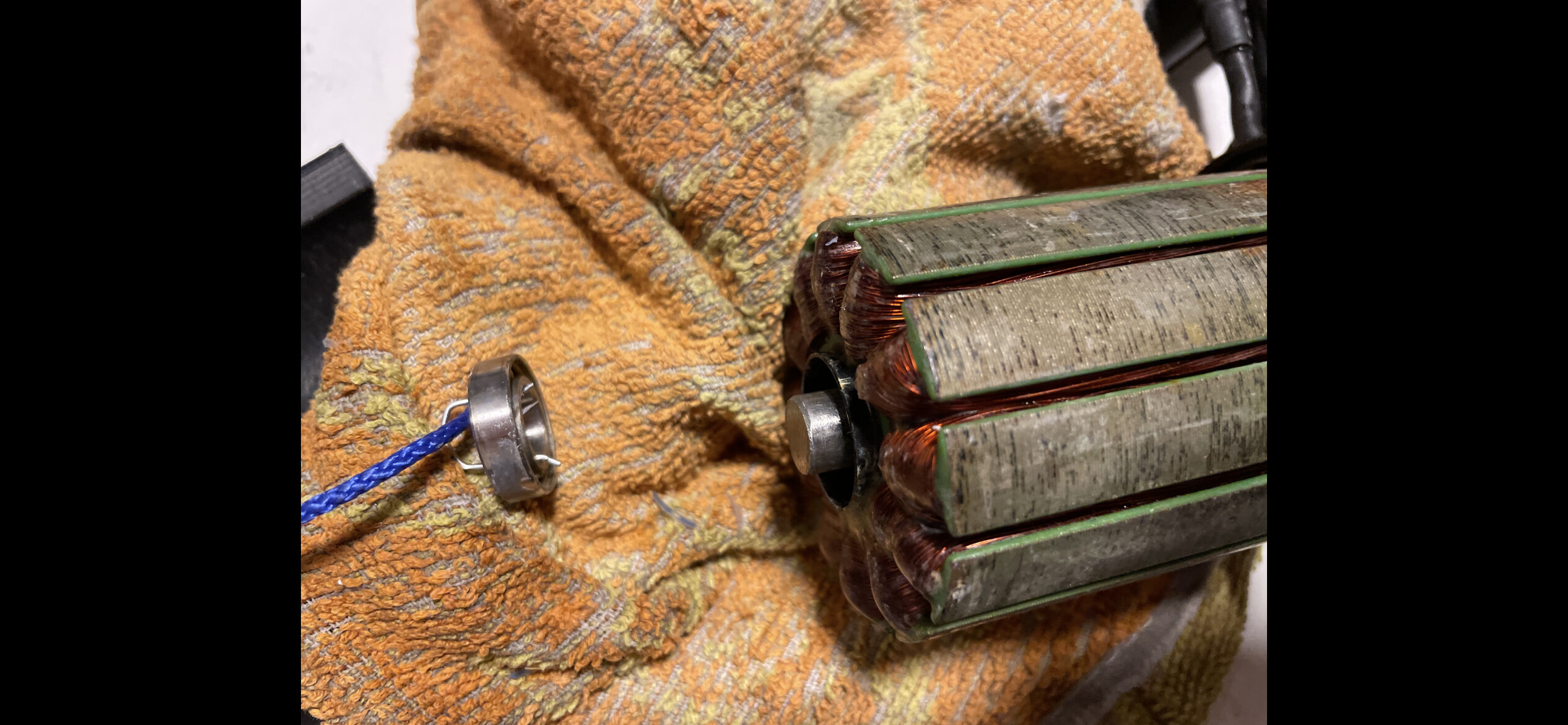

Might be a bit late, I found a picture on how I did remove them. I made a smal clip from a wire that you pull through the stator on a theread. The ends stick between the bearing and the stator. Then use a rod through the stator to hammer them out.

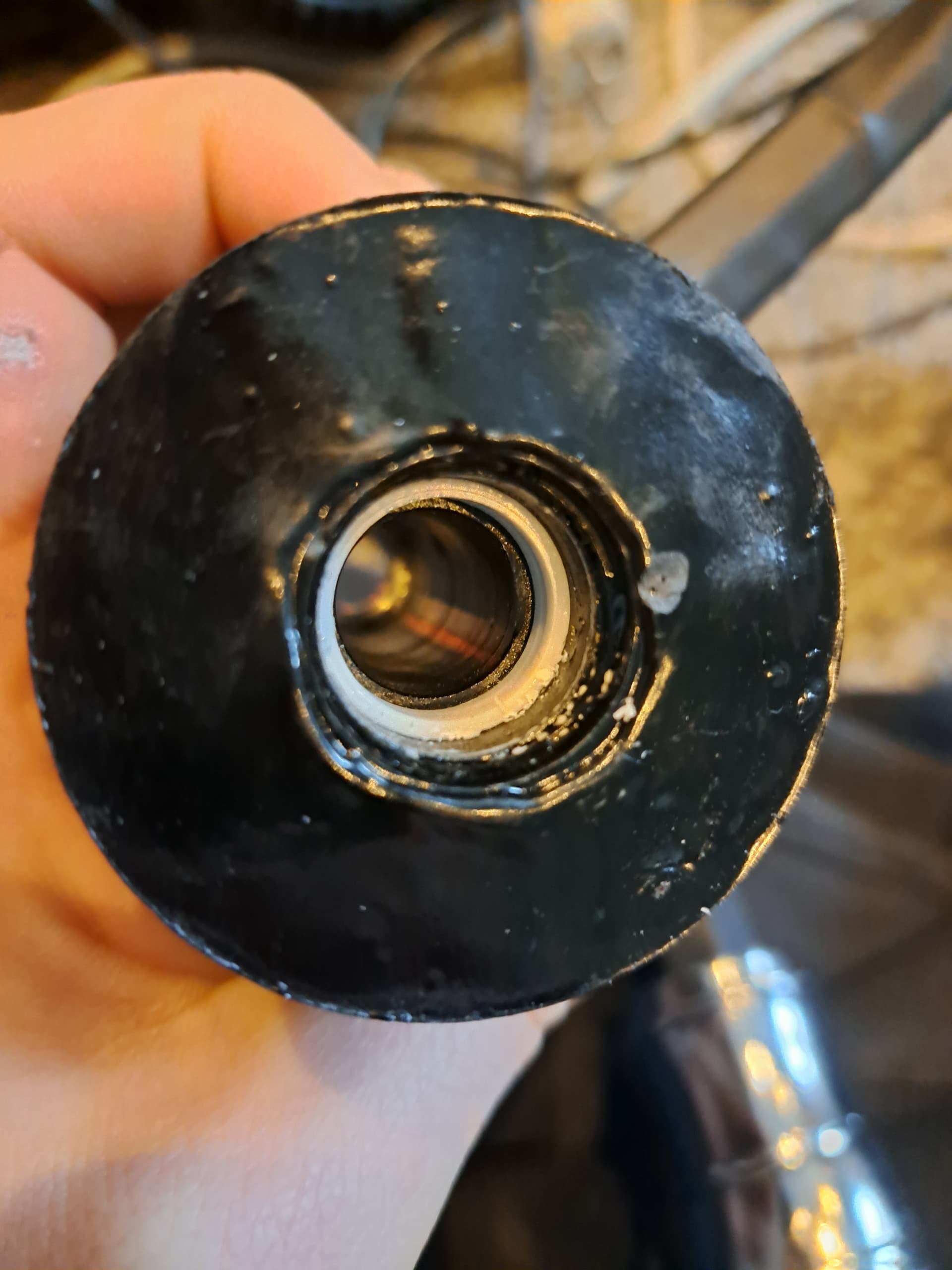

I have a Saite motor with the outer ring of a ceramic bearing stuck. The other parts of the bearing are already out.
Maybe that outer ring is glued in?
Any ideas how to get that out?
was the bearing broken? or was it still complete for this method?

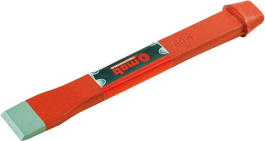

yes I had this issue previously with original flipsky ceramic bearings that broke. You can break easily this outer ceramic rim with hammer and “mechanic’s chisel”
Complete, it was not broken and could still be reused if needed after taking it out because it was undamaged. They were steel bearings but theoretically it should work with ceramic as long as the bearing didn’t get broken.
