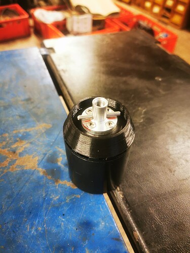

Here is what the test print look like for my version with small blades.
Not super conviced It seems like there will be too much drag.
Good Idea but I would reduce the diameter of the hub at least to motor diameter to avoid drag: 63mm
Could you explain what do you want to achieve with your design ? Is it necessary to use such small blades ?
Tks
Wanted to reuse existing blade designs.
It it is not possible to make it smaller because the Bolts have some interferences then.
Hub diameter is 80mm
