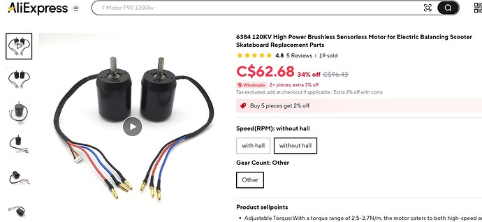

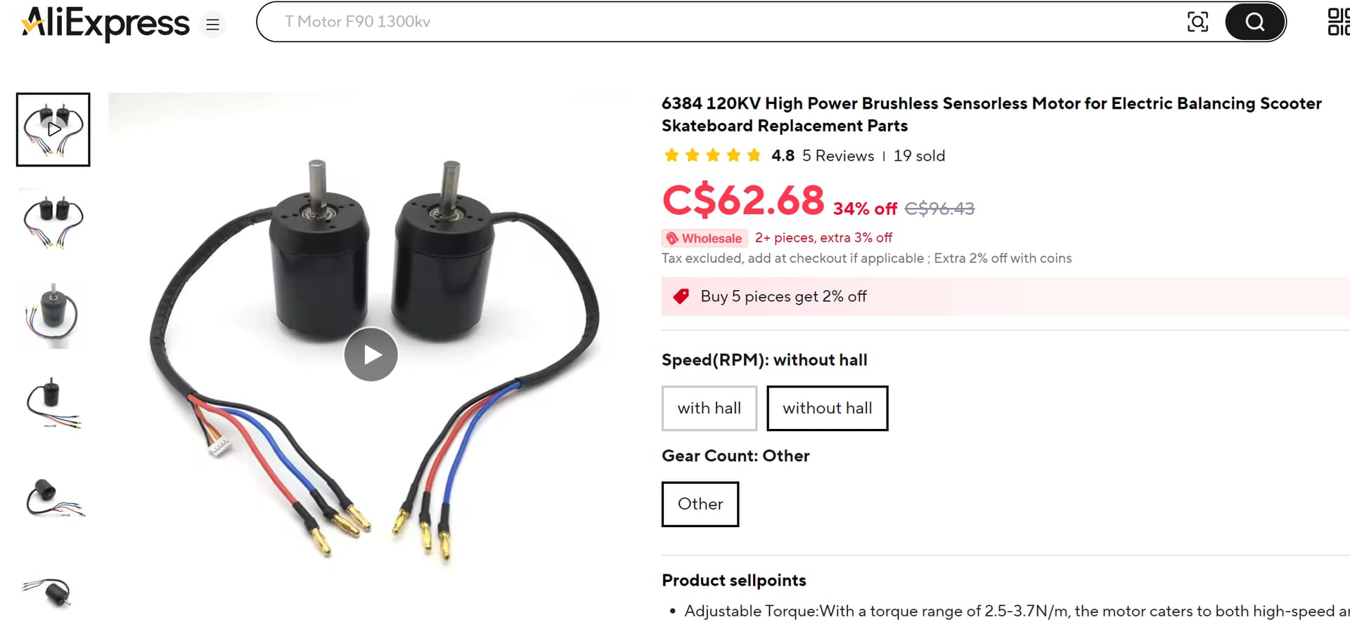

Guys, just wanted to double check, no issue would be for me to waterproof this kind of motor - as on the picture (as prices are quite good on AliExpress now)? And that’s an OK motor? This is my first build and I do not want to spend fortune on it.

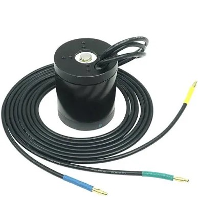

Choose one with cables towards the back, like flipsky version
