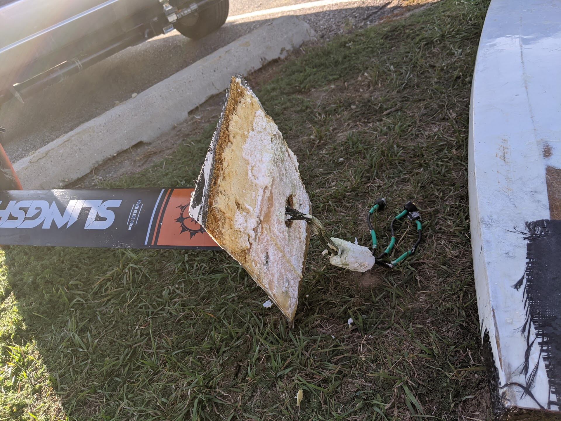

Hi @brycej, that looks like a session cut short, sorry to see that. What happened to your mast to board connection? What is the lesson we should learn? Did you have any hd foam or reinforcement under the mast plate?
Lesson learned was to build a board and don’t hit sandbars😁
On that board, i just used plywood and and fiberglassed it and put a sheet of carbon fiber to make the mast mount. If i would have helped to have the carbon fiber more toward the front of the board.
No foam or reinforcement on that board. On my new one i used a track box and a 4 layers of carbon fiber.
