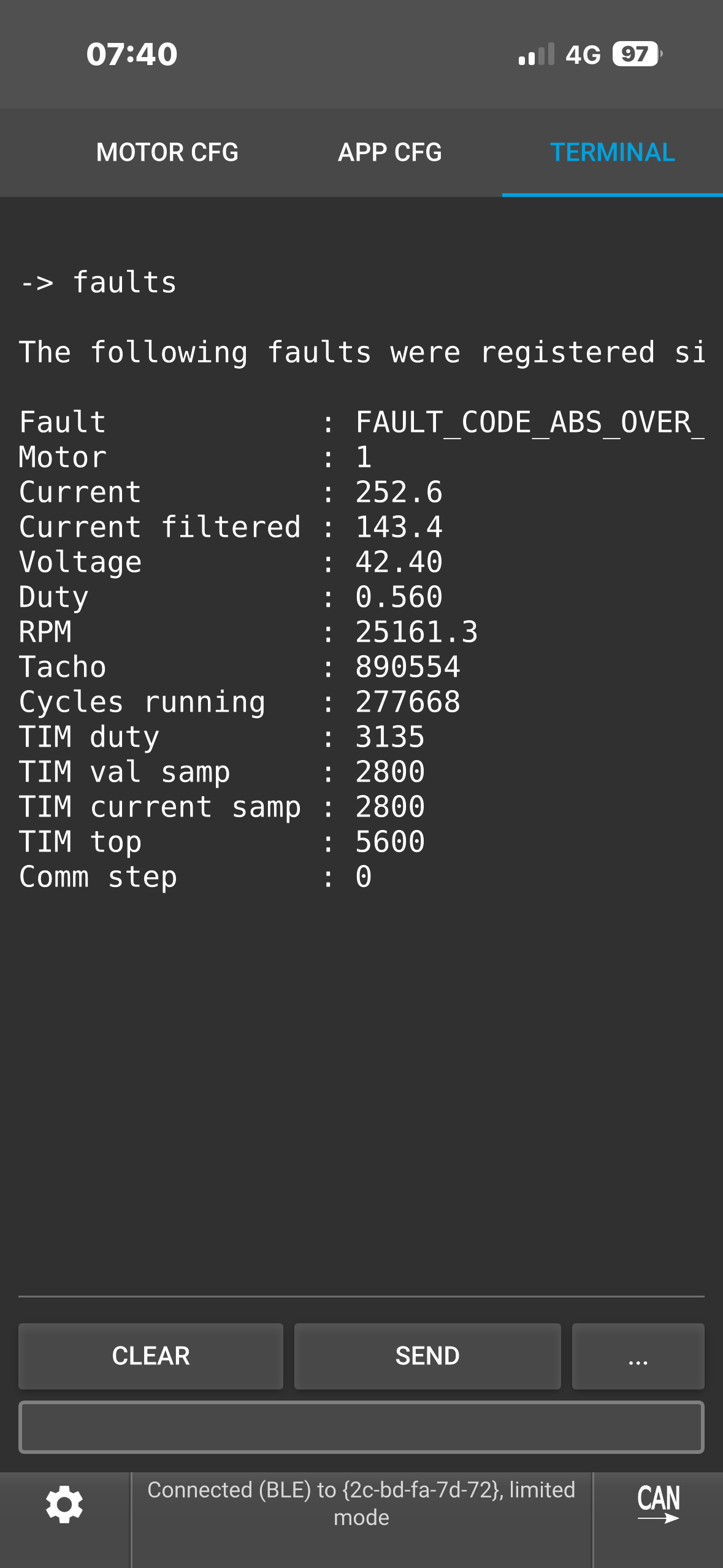

Here it is :
Is it ok to put the absolute max limit to 300 amp for an 75100?

What is the actual high spike value?
@Jezza 252 amp
