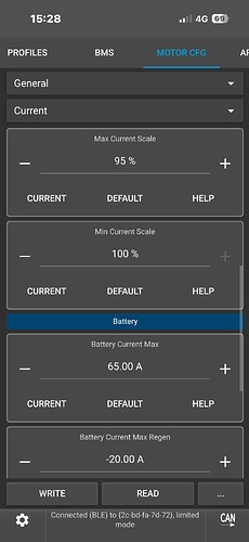

Why would you lower the scale percentage? As it says in the VESC tool, the scale percentage is ONLY to enable lowering the abs max parameter while keeping the old, higher value for reference.
Can you please screenshot your parameters? Right now, what you told us is:
Max battery current: 65 amps
Motor current: UNKNOWN (you said motor current but you meant abs max)
Abs max: 190 amps (real value 190 * 95% = 180 amps)
Abs max scaling: 95% (this should be 100% and just change the abs max directly)

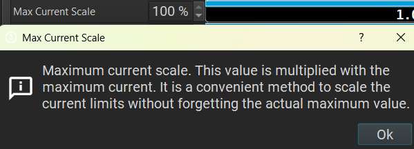

What I mean is that I don’t think the scale works how you think it works. The scale adjusts the abs max value: so if there is an abs max of 180 amps and the scale is 50%, the actual abs max value is 90 amps.
See the image:
This parameter is basically useless for normal use because it doesn’t really do anything.

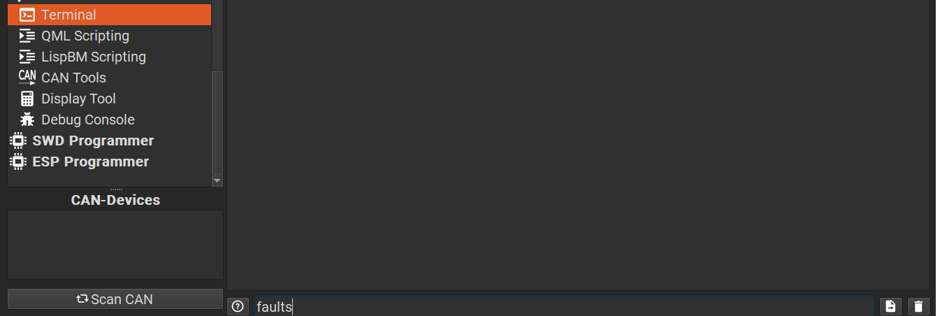

(Note: To see the ACTUAL current it’s tripping at, type “faults” in the VESC terminal while it’s connected. This would show you the fault info which you could screenshot.)

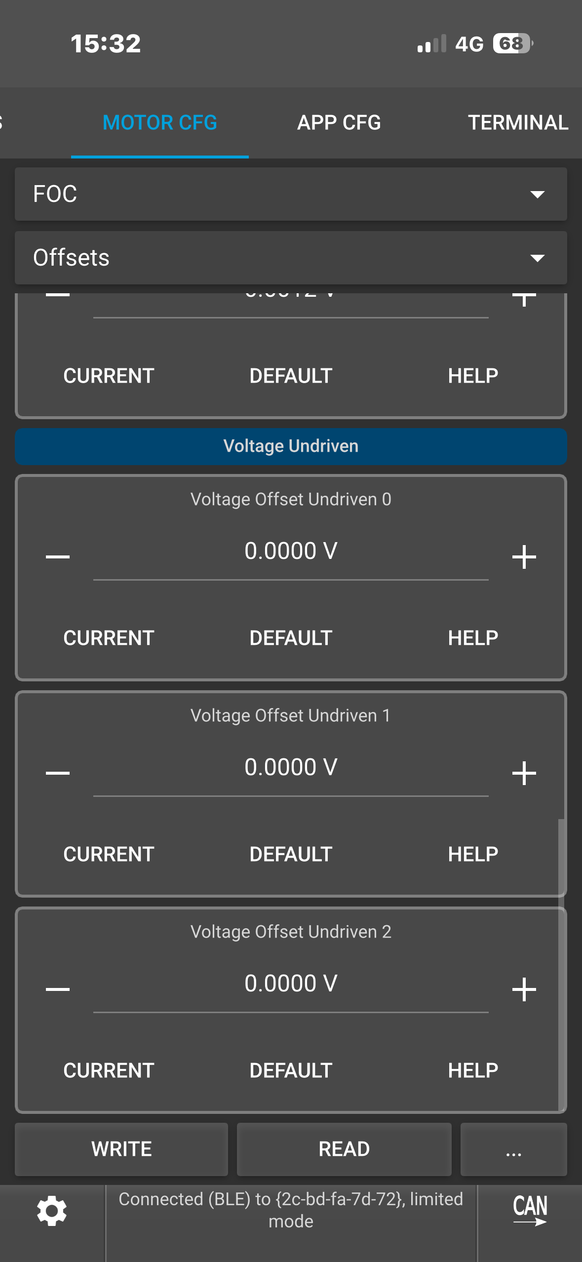

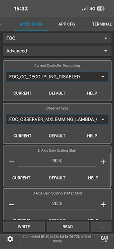

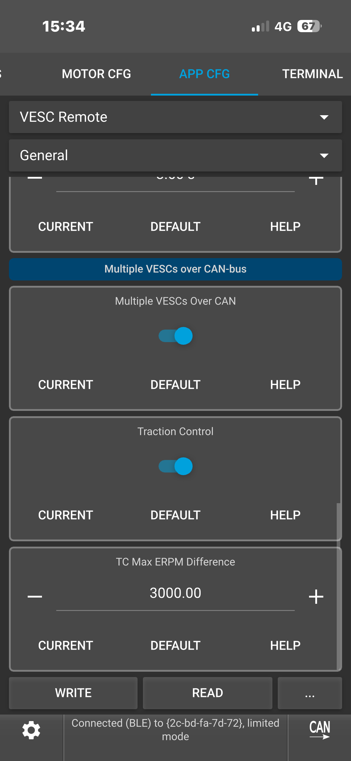

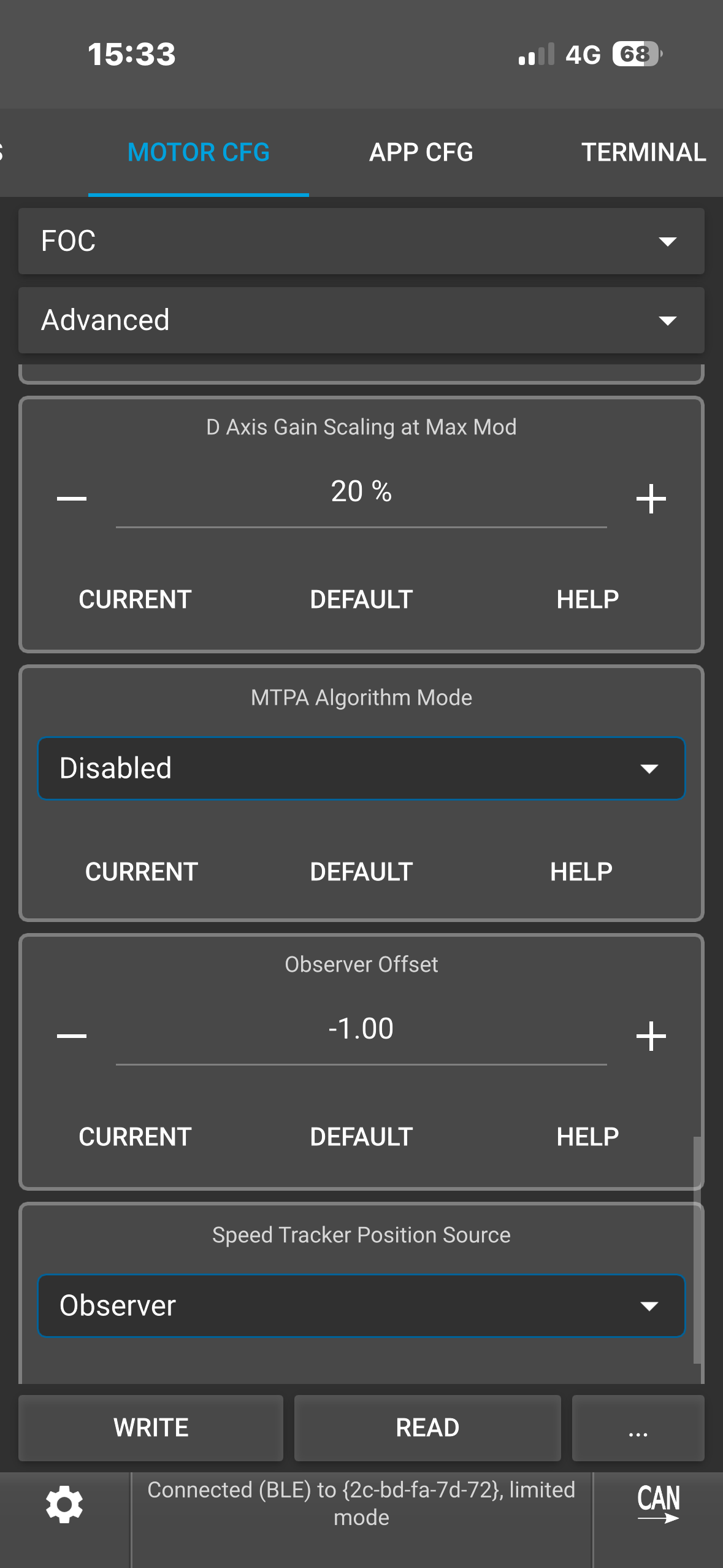

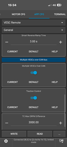

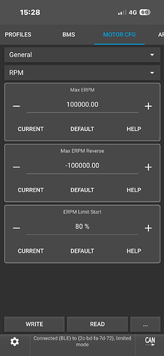

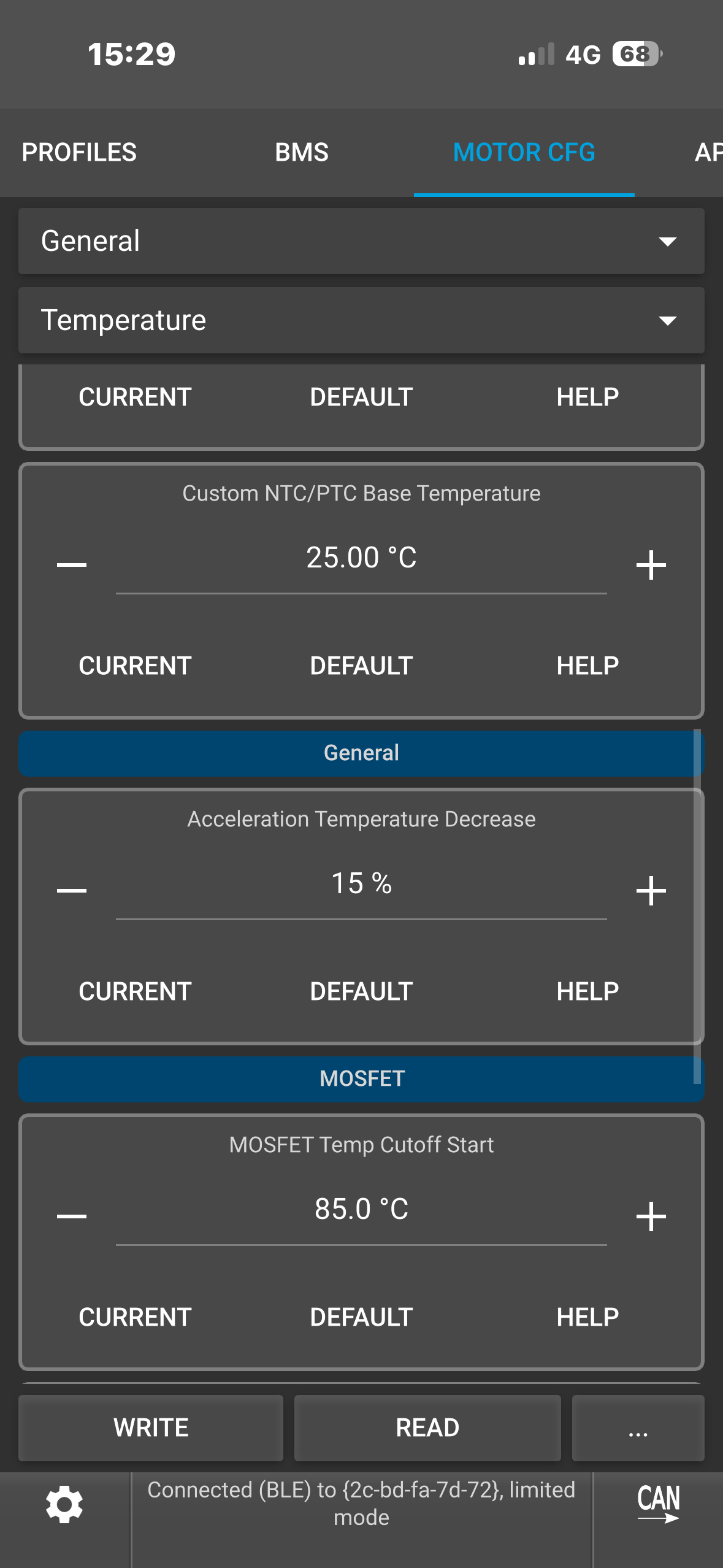

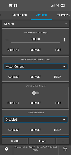

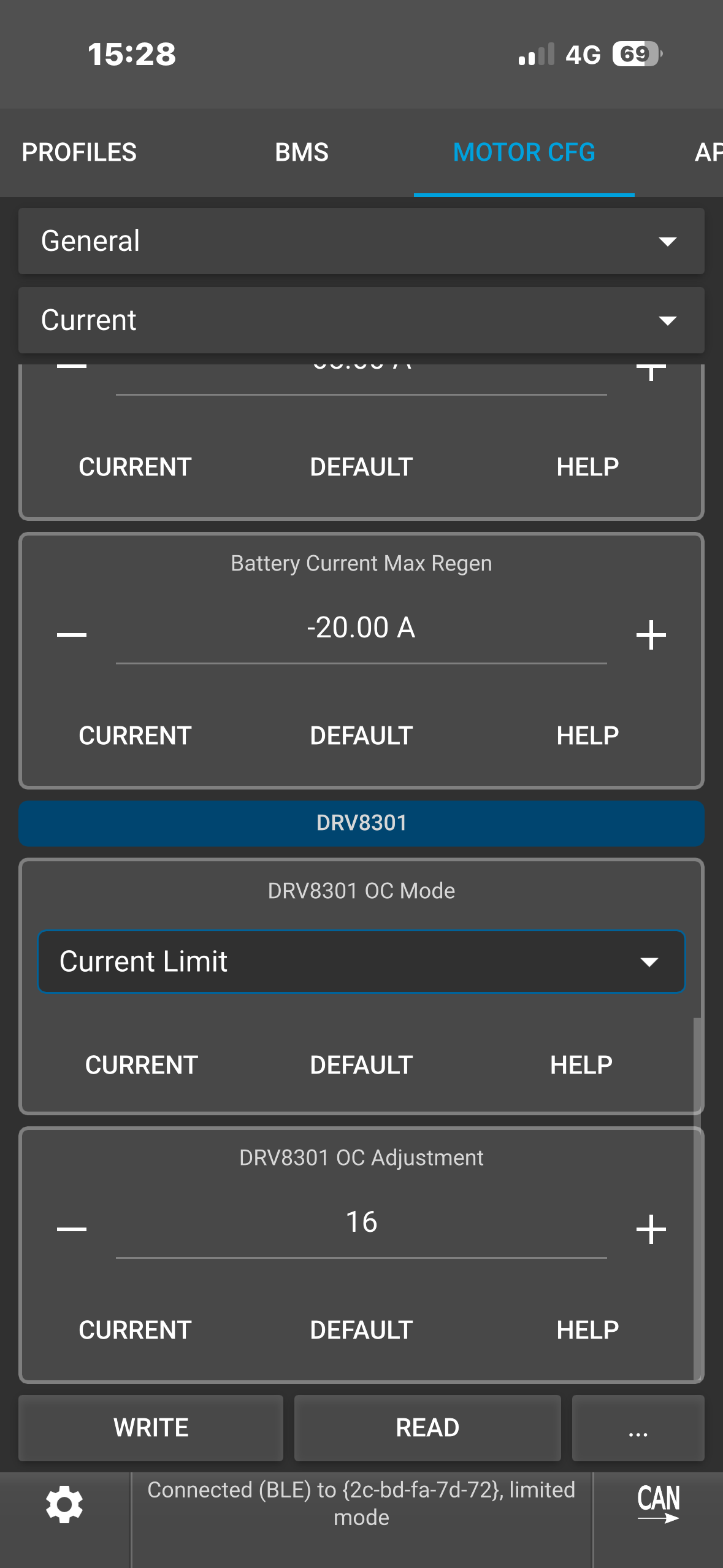

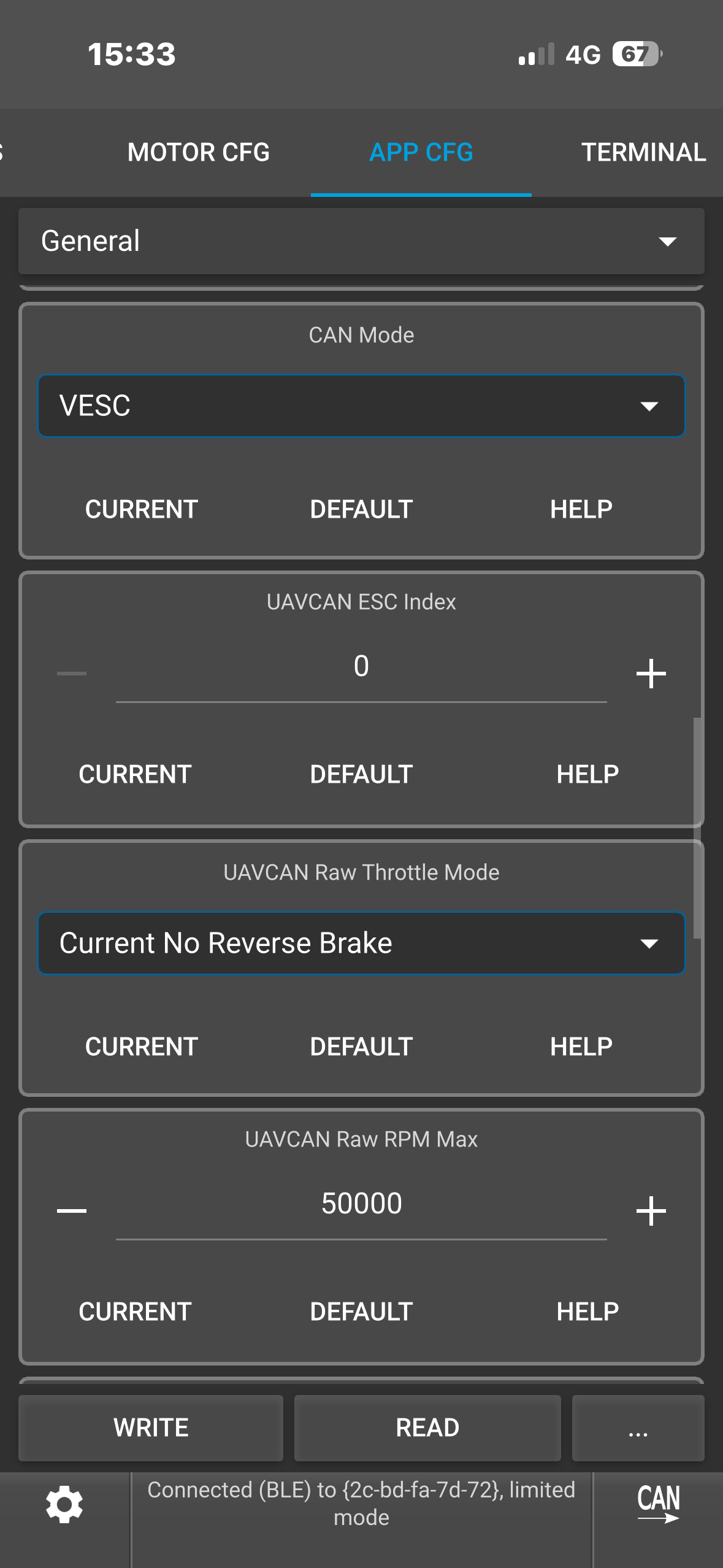

Is it possible to have your screenshots app?

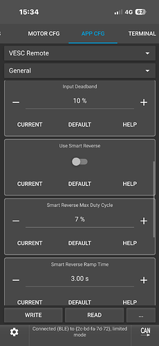

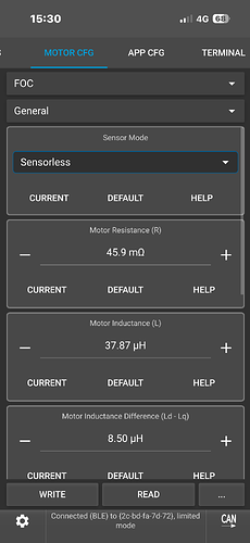

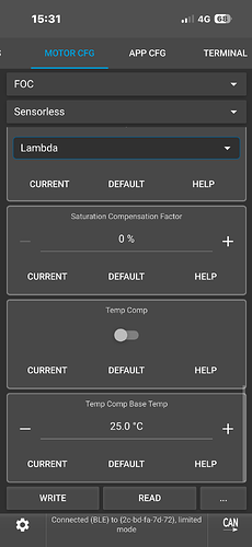

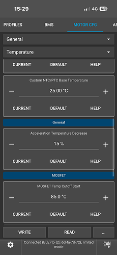

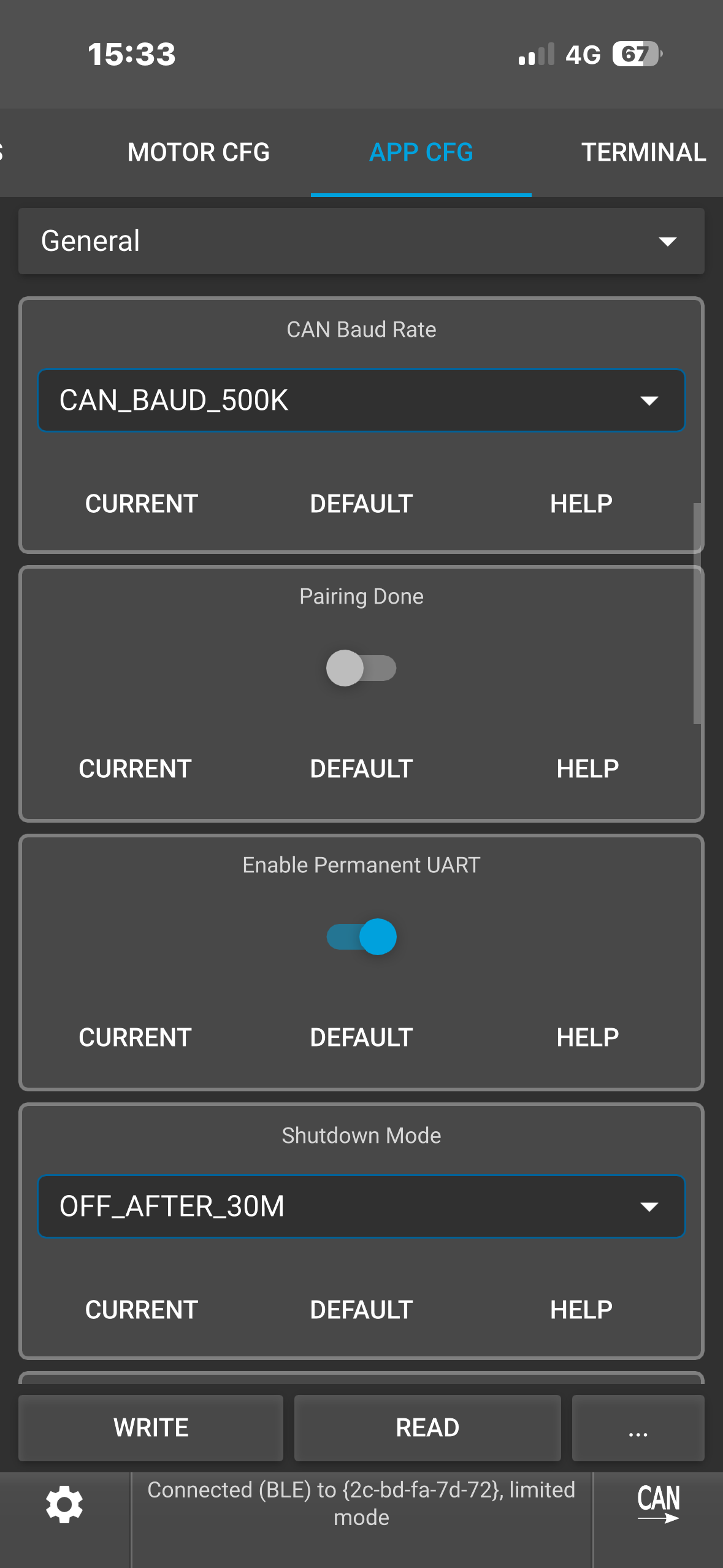

Hello

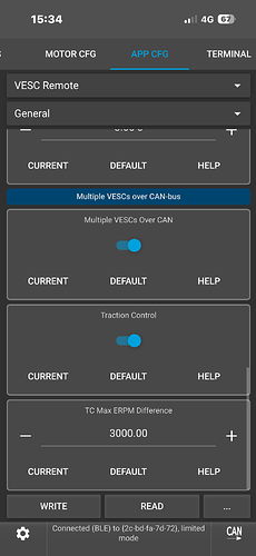

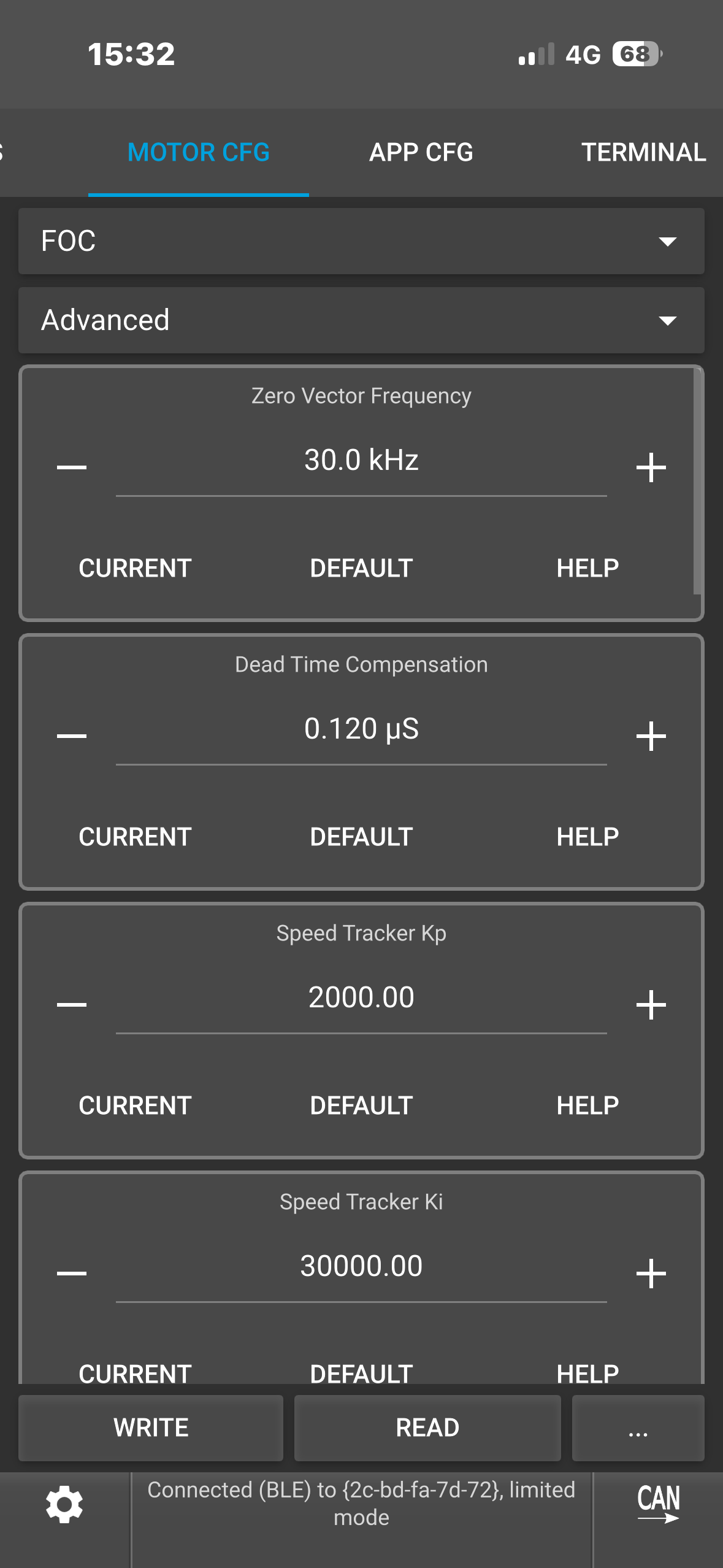

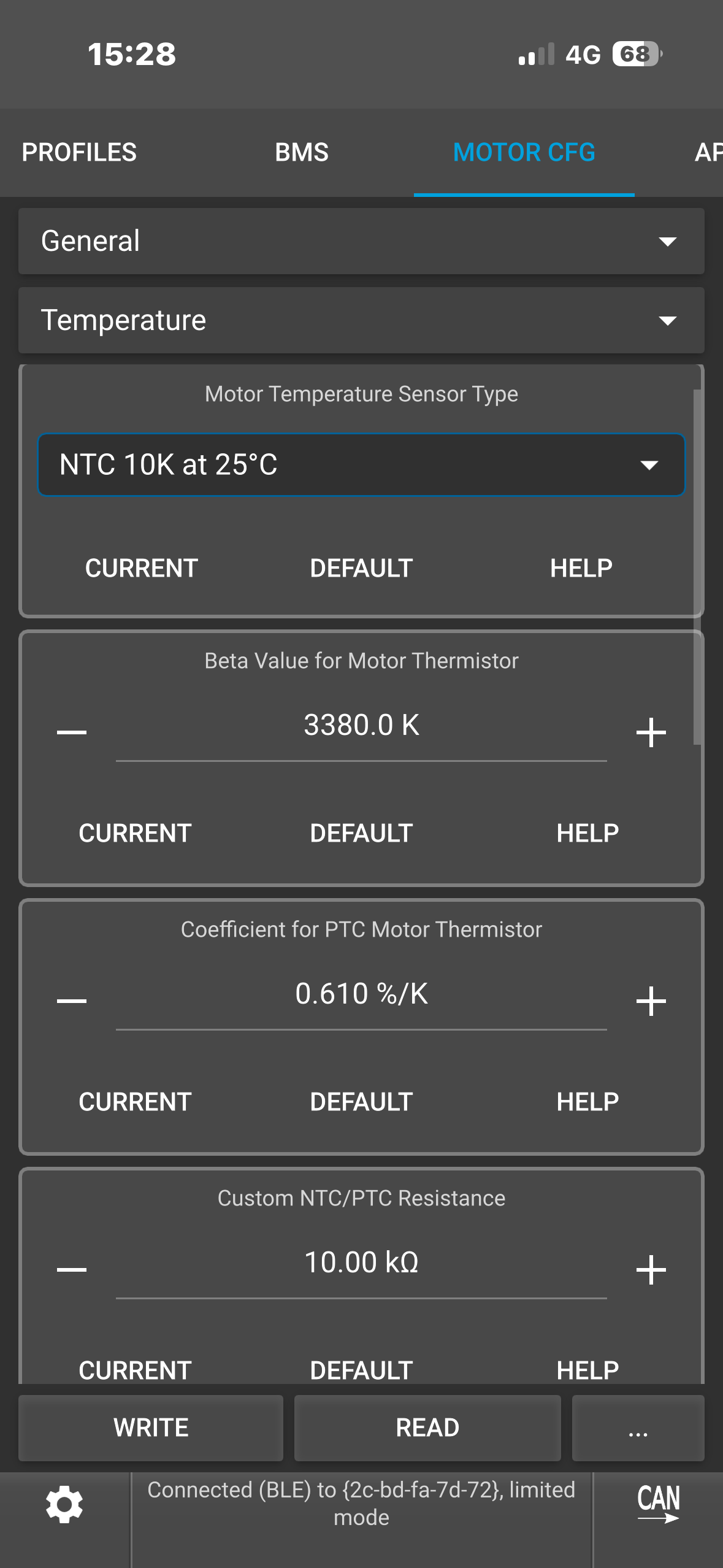

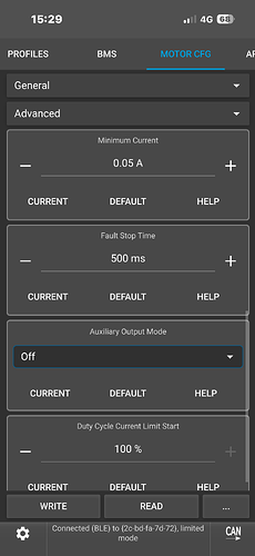

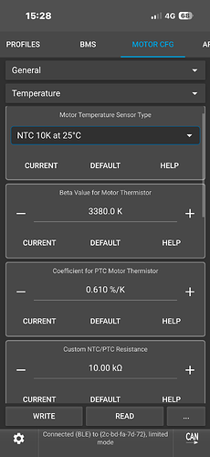

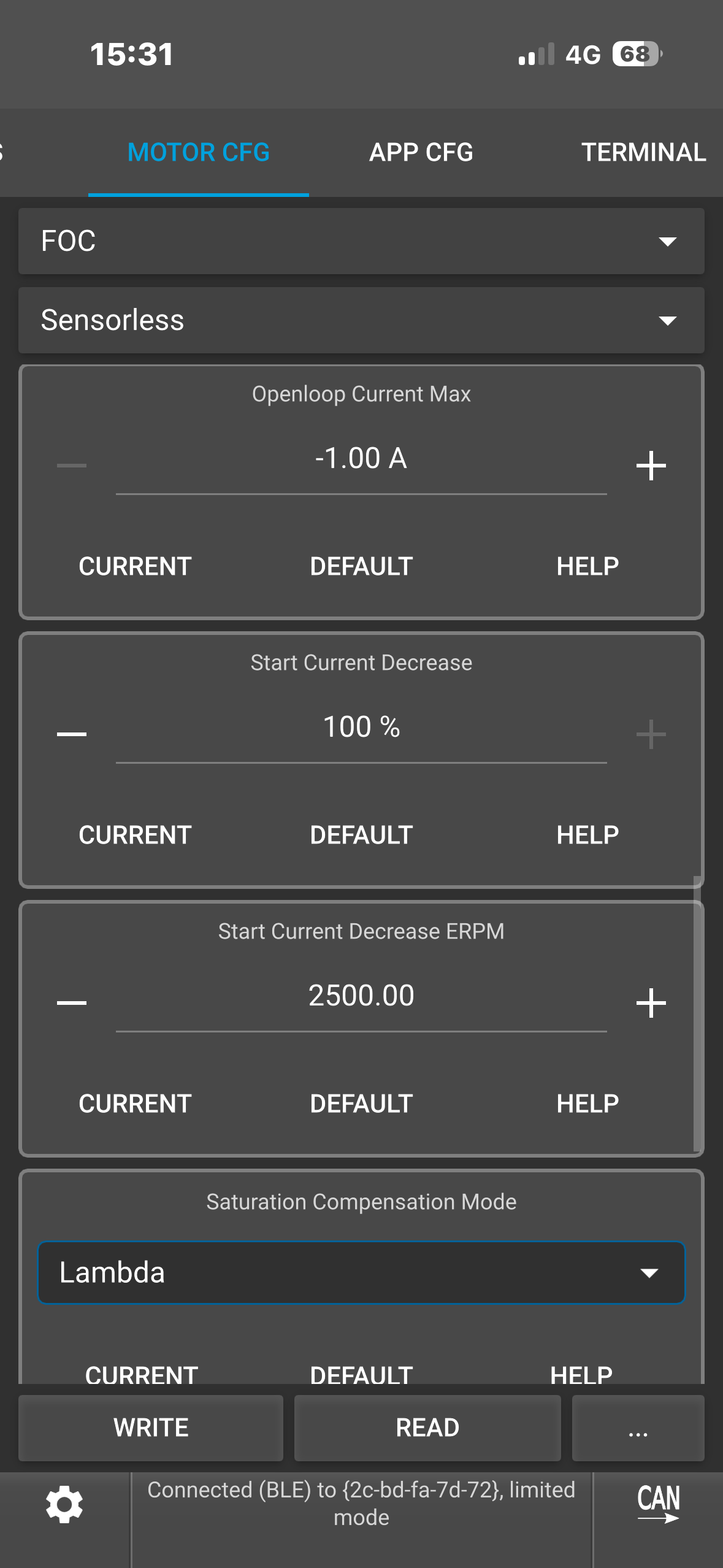

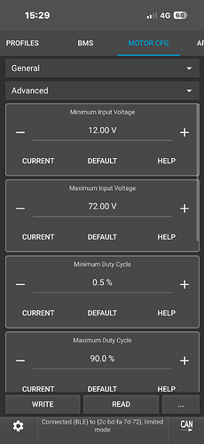

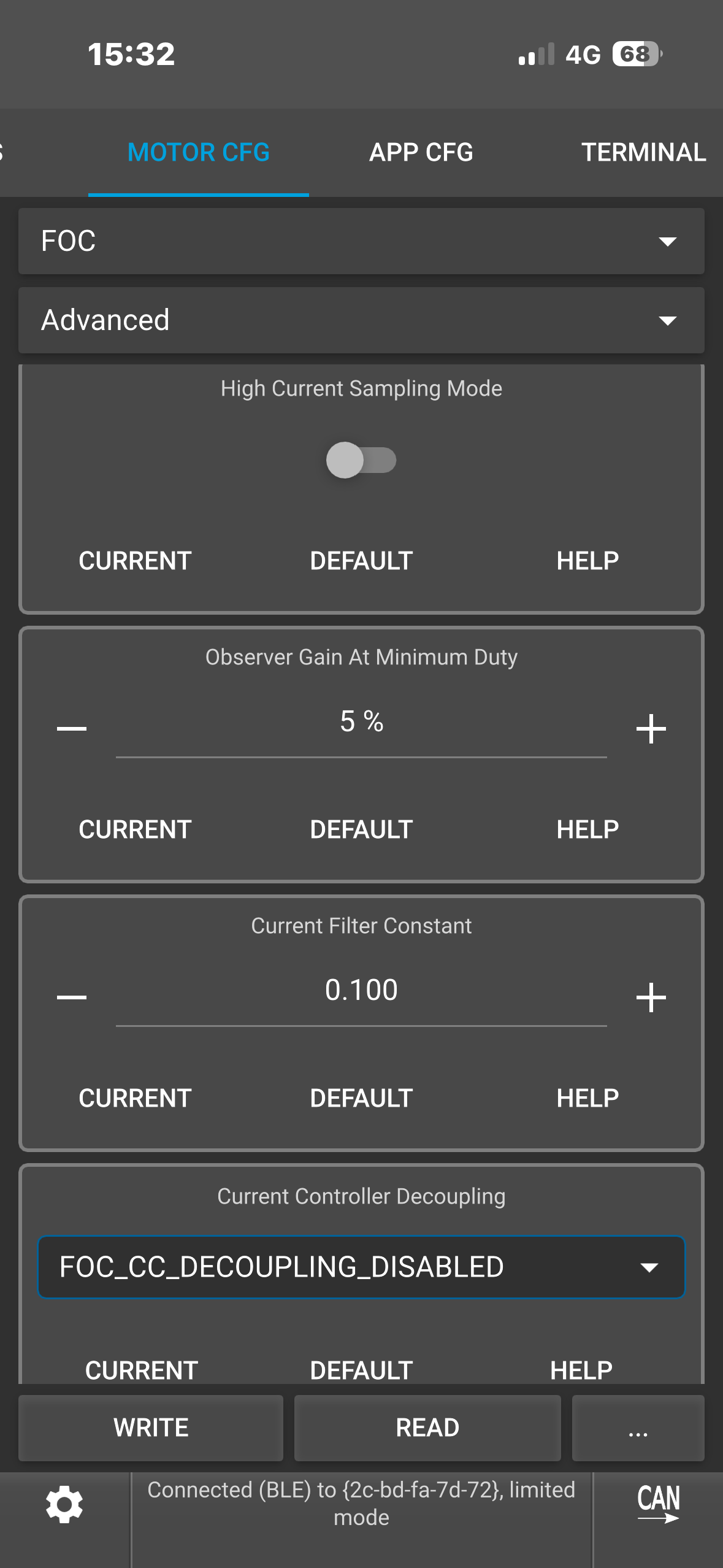

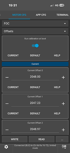

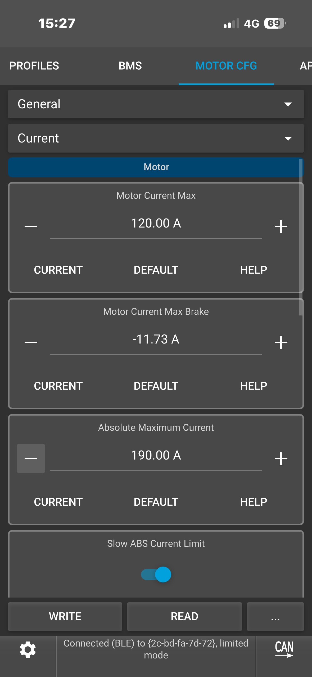

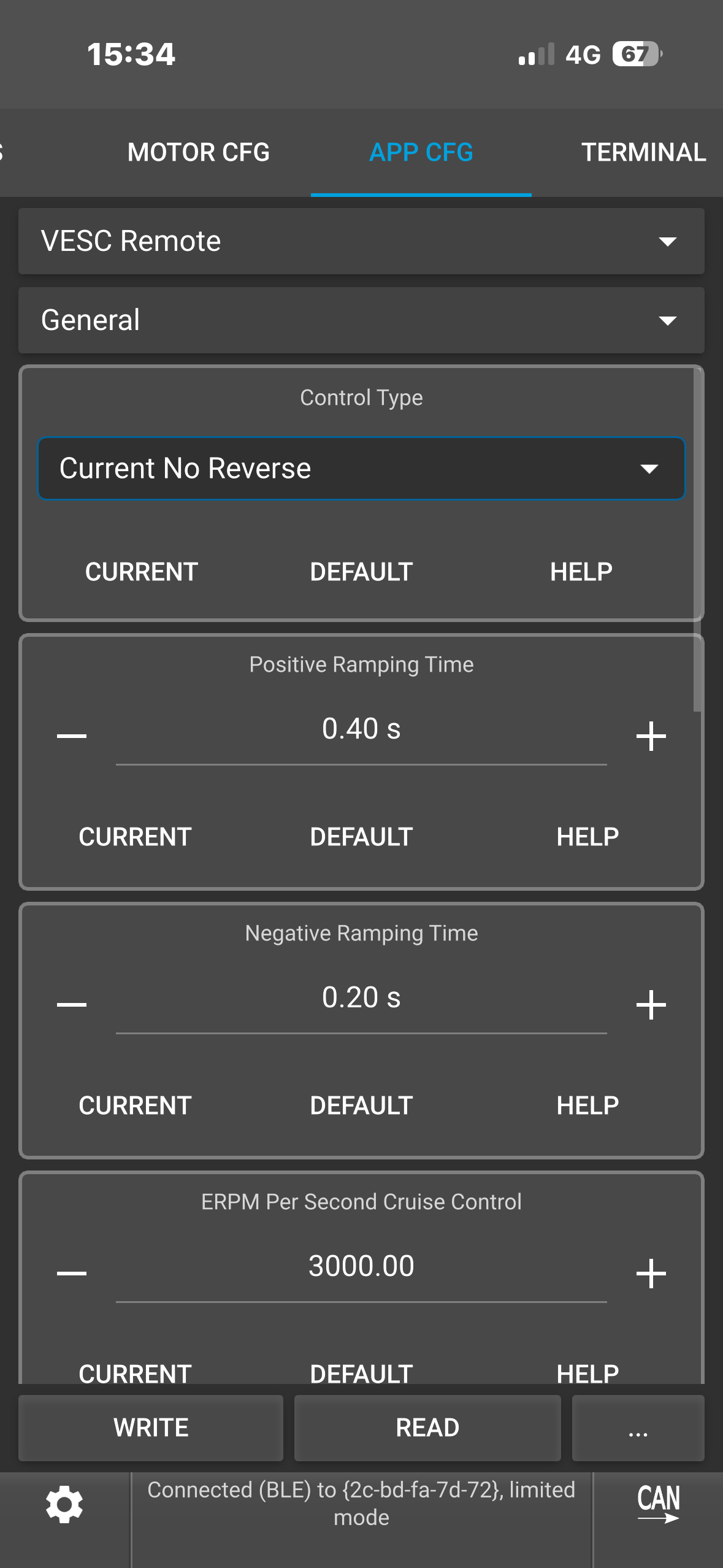

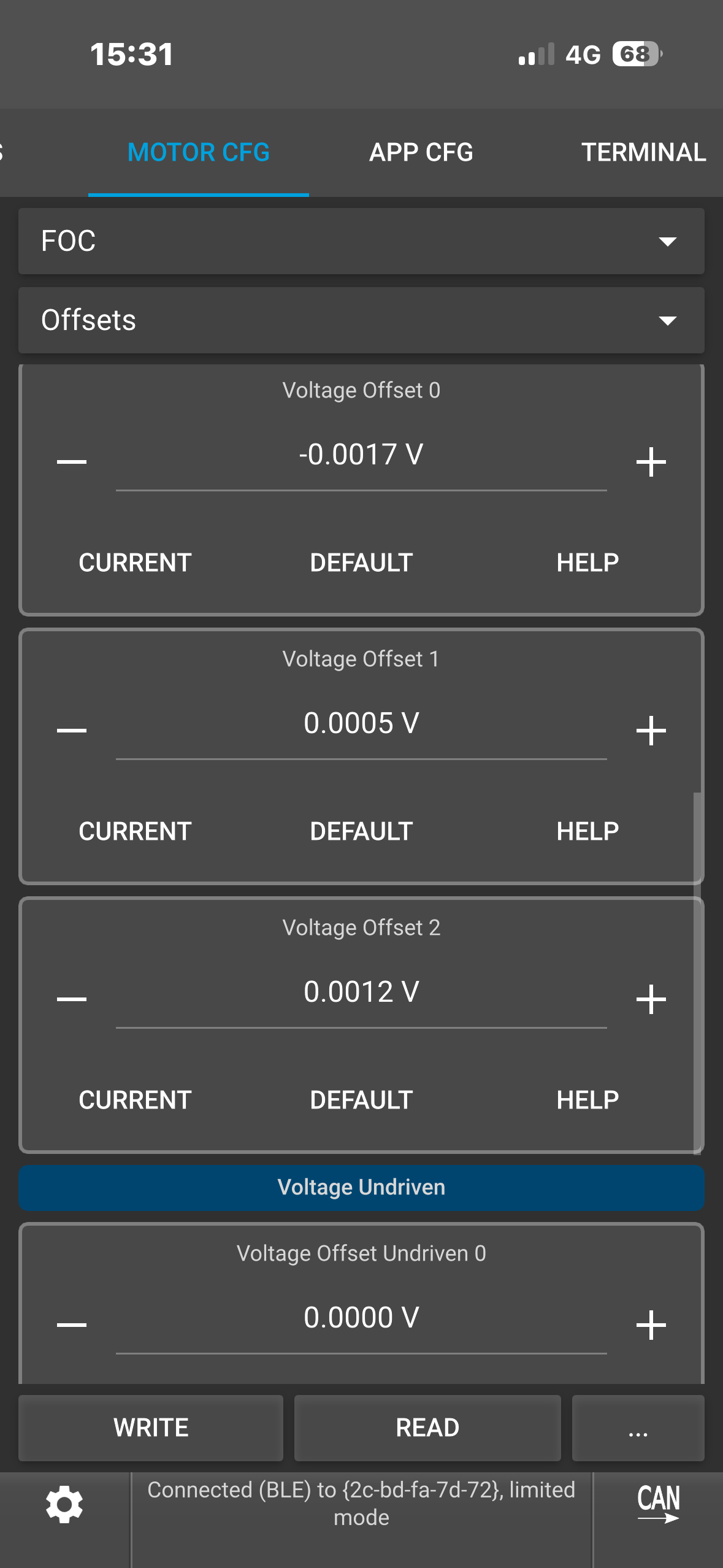

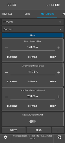

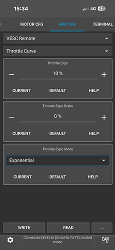

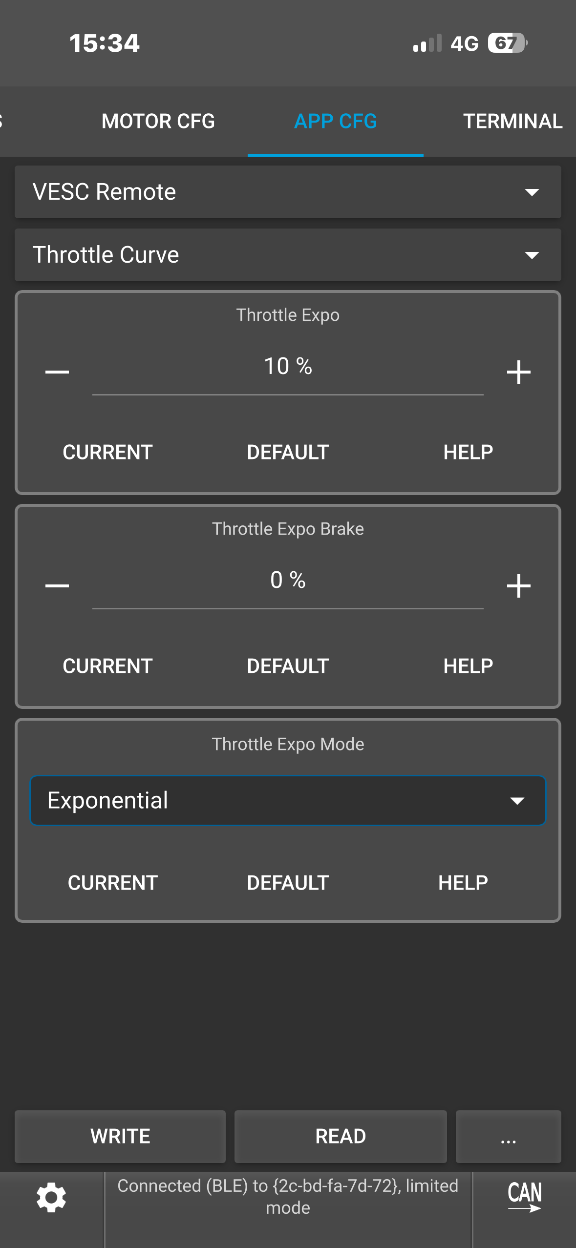

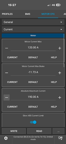

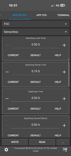

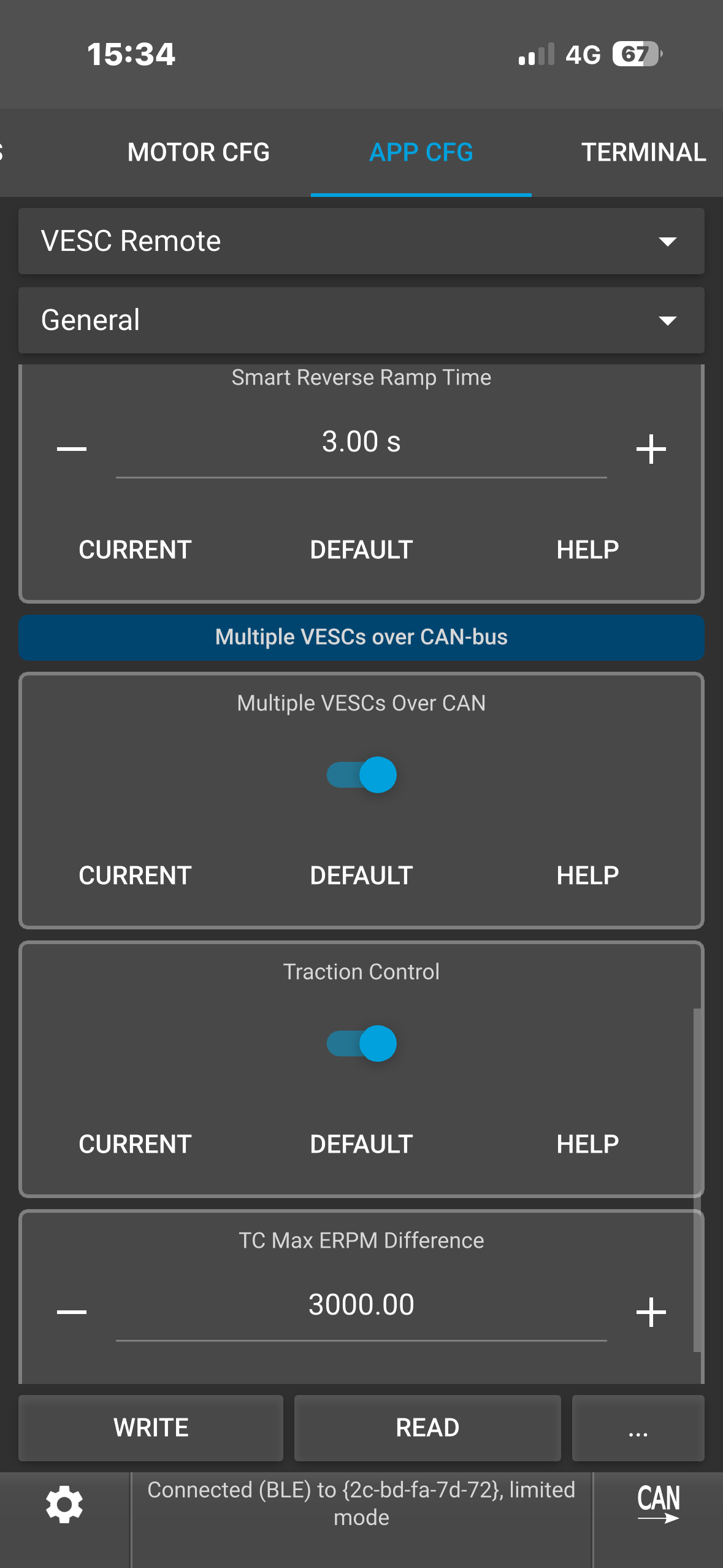

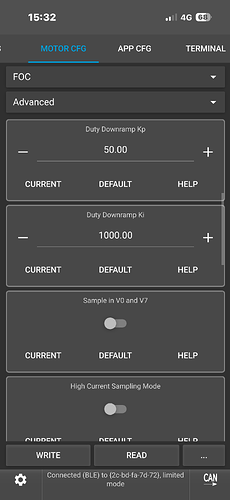

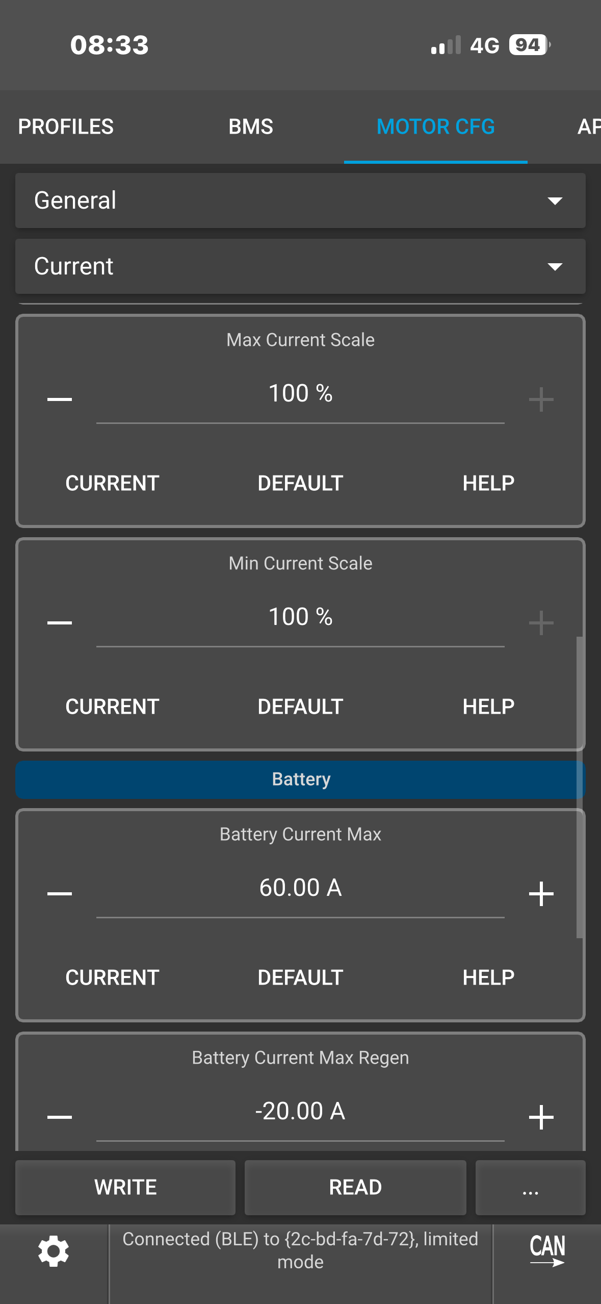

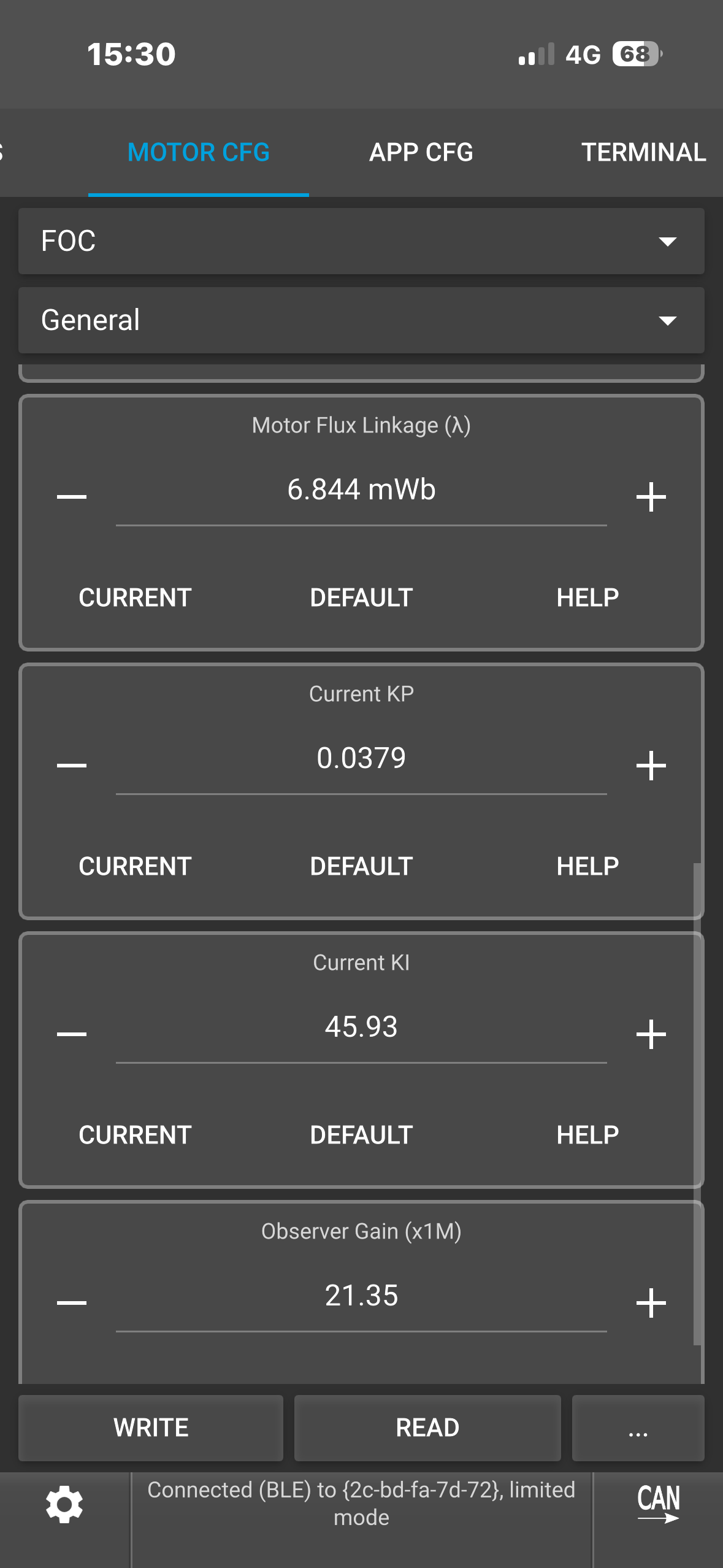

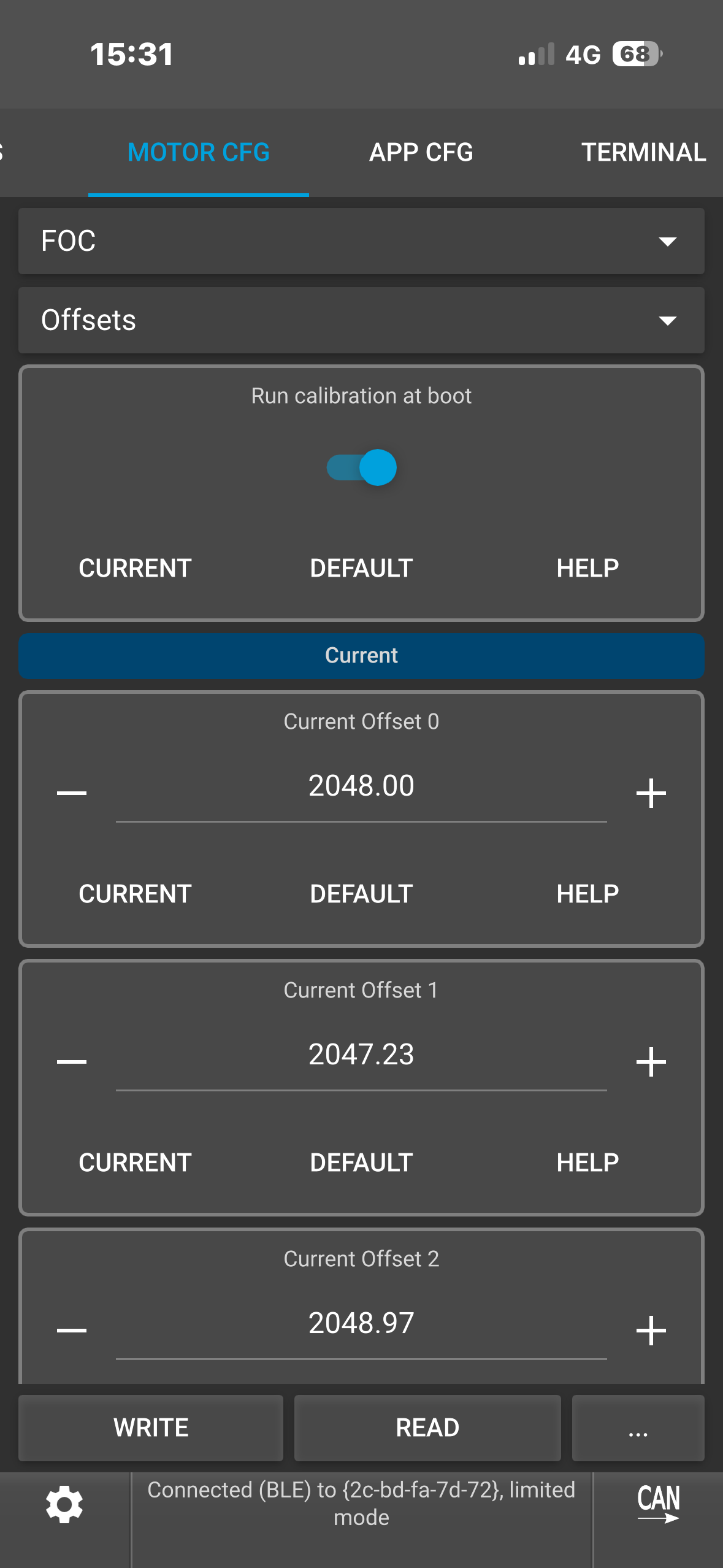

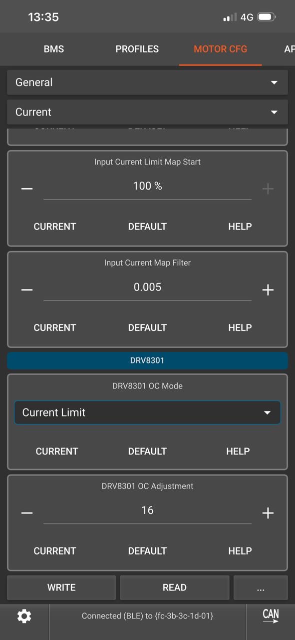

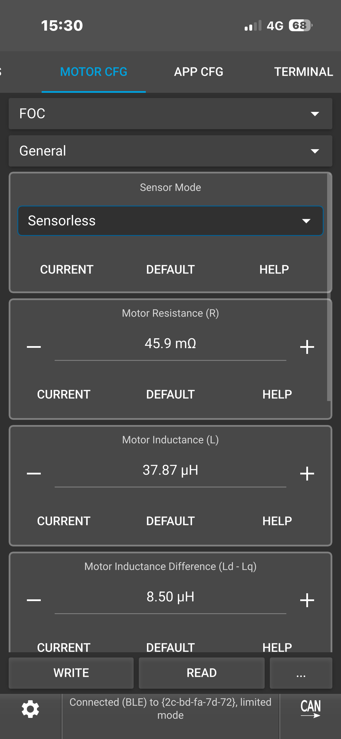

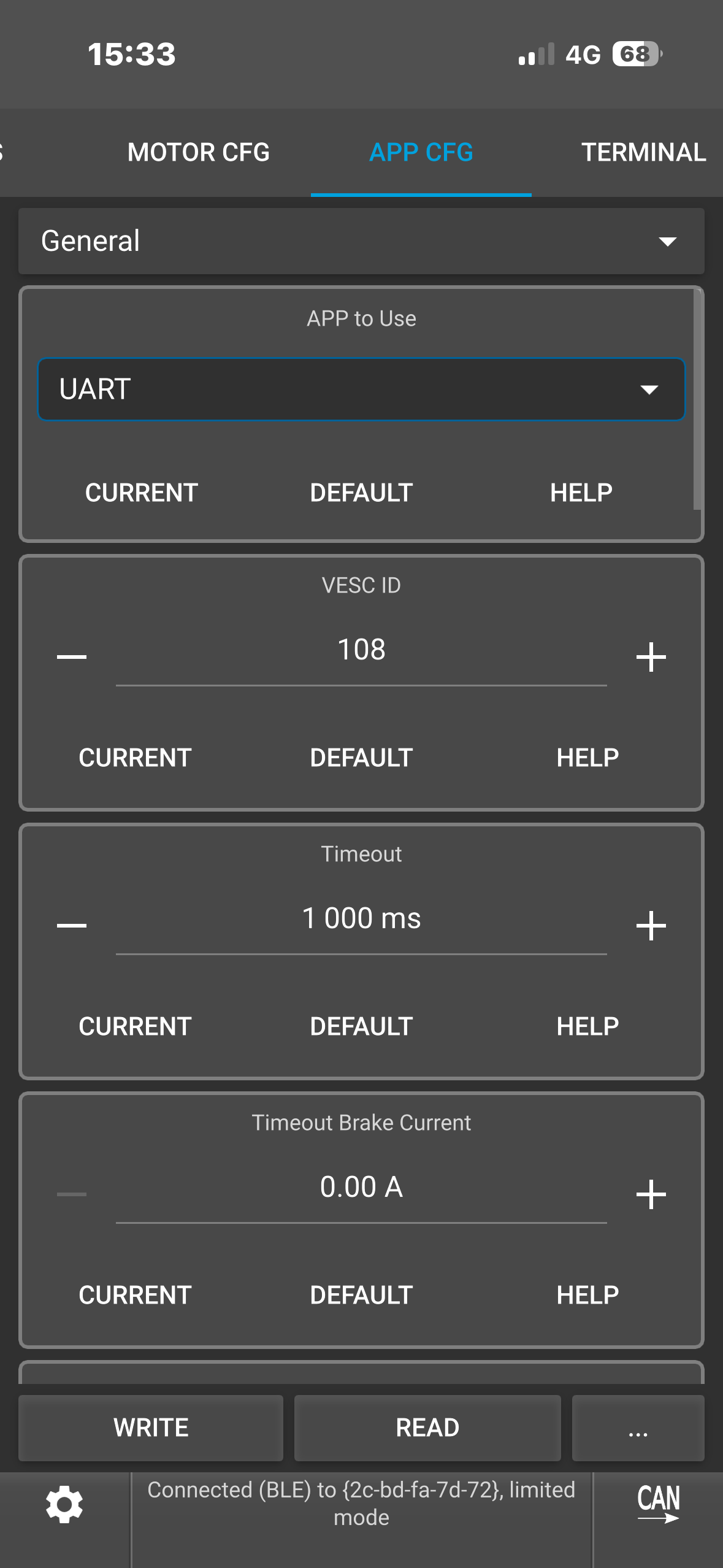

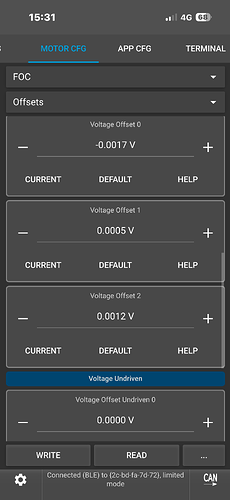

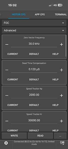

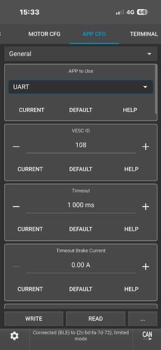

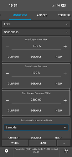

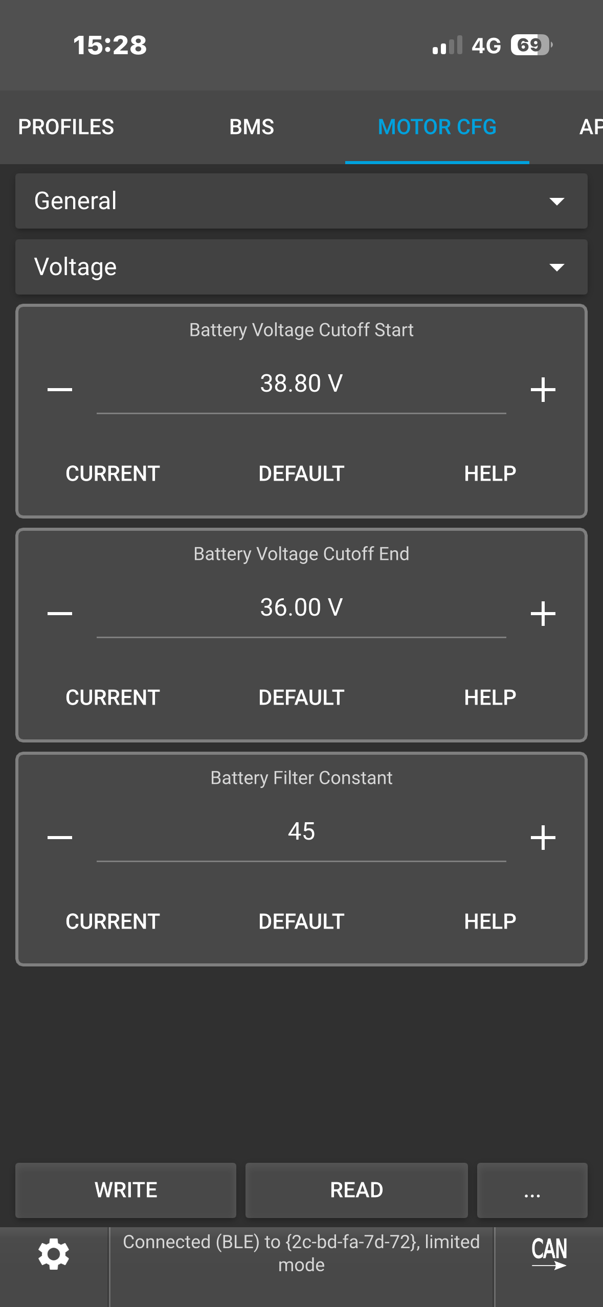

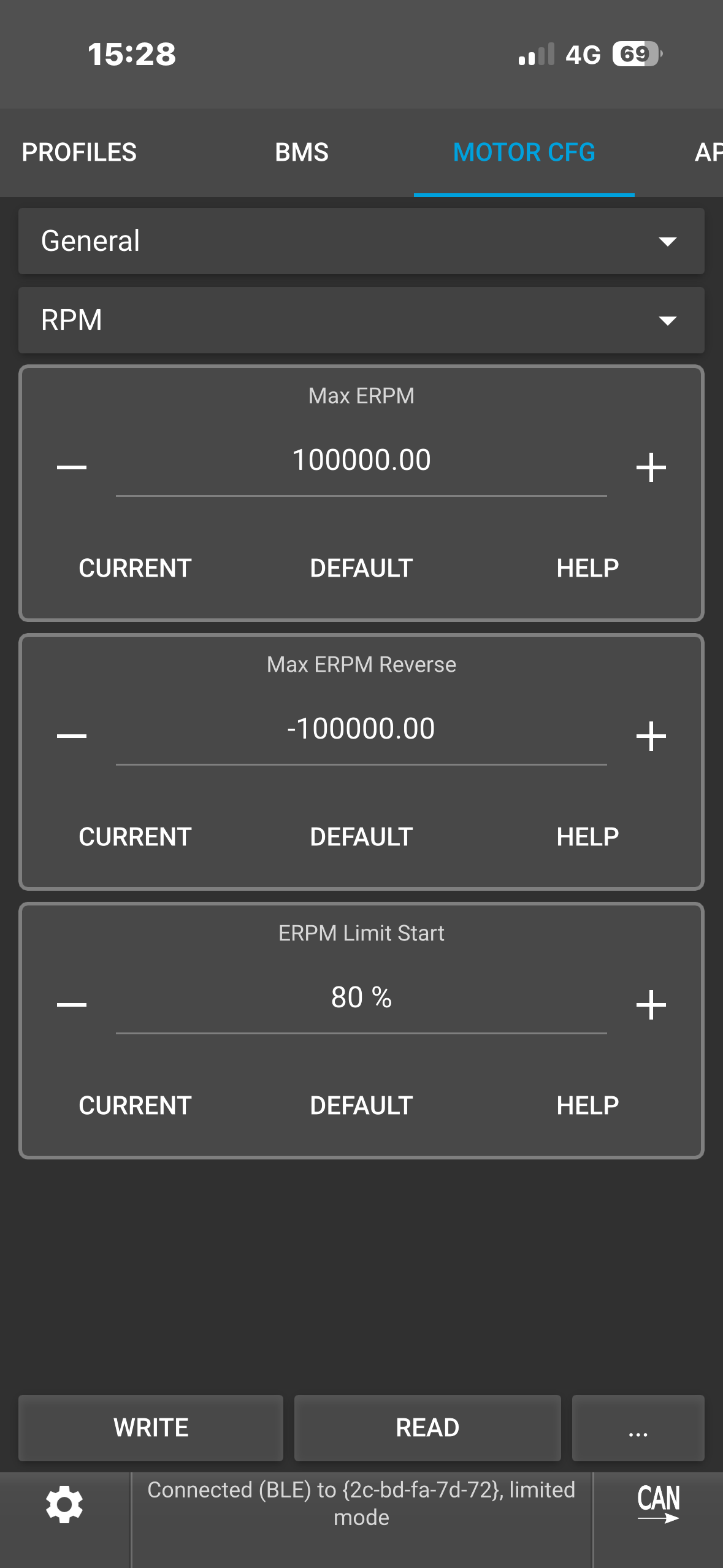

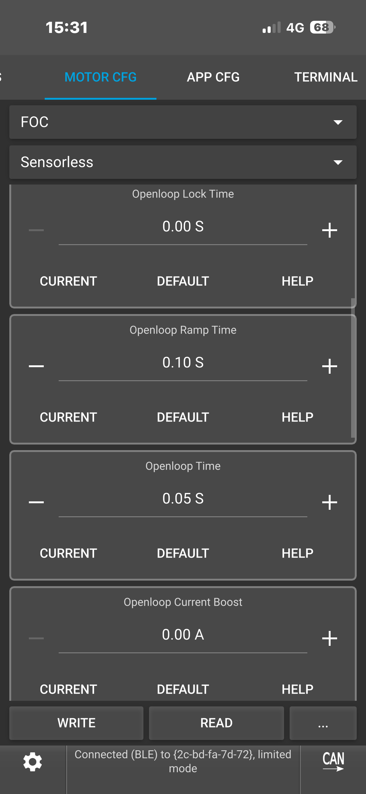

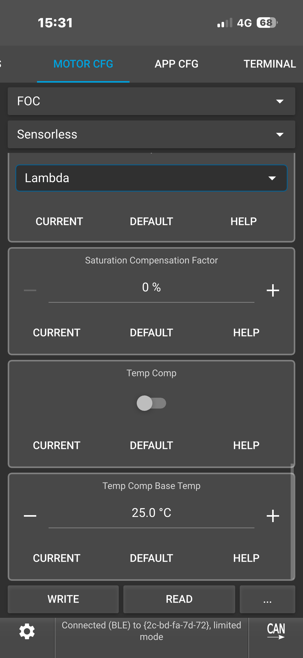

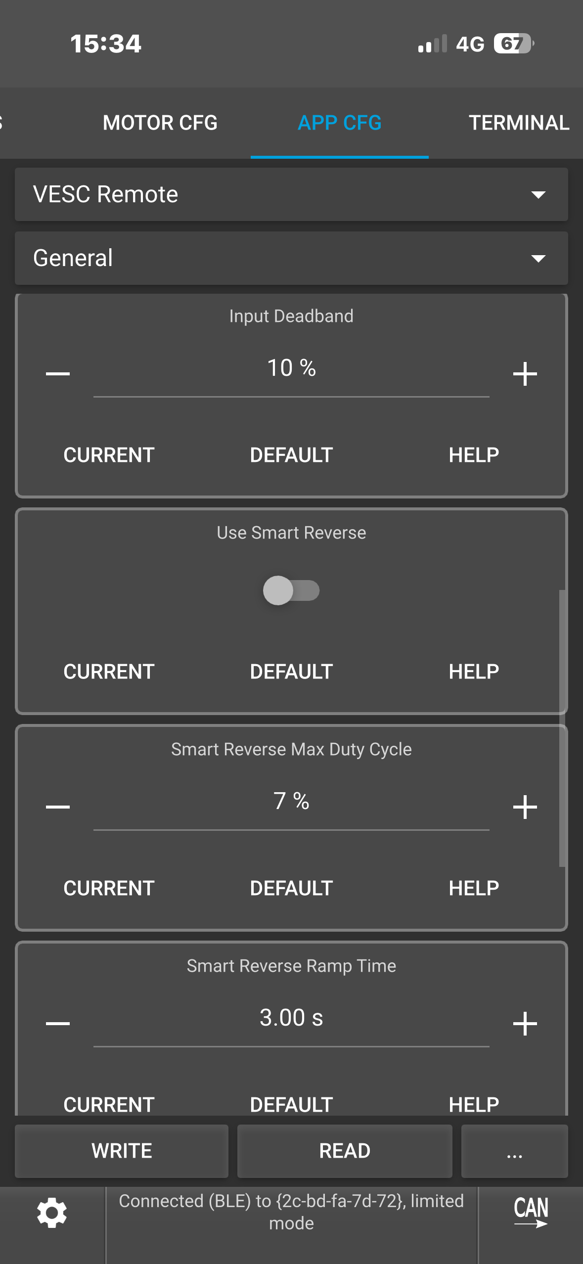

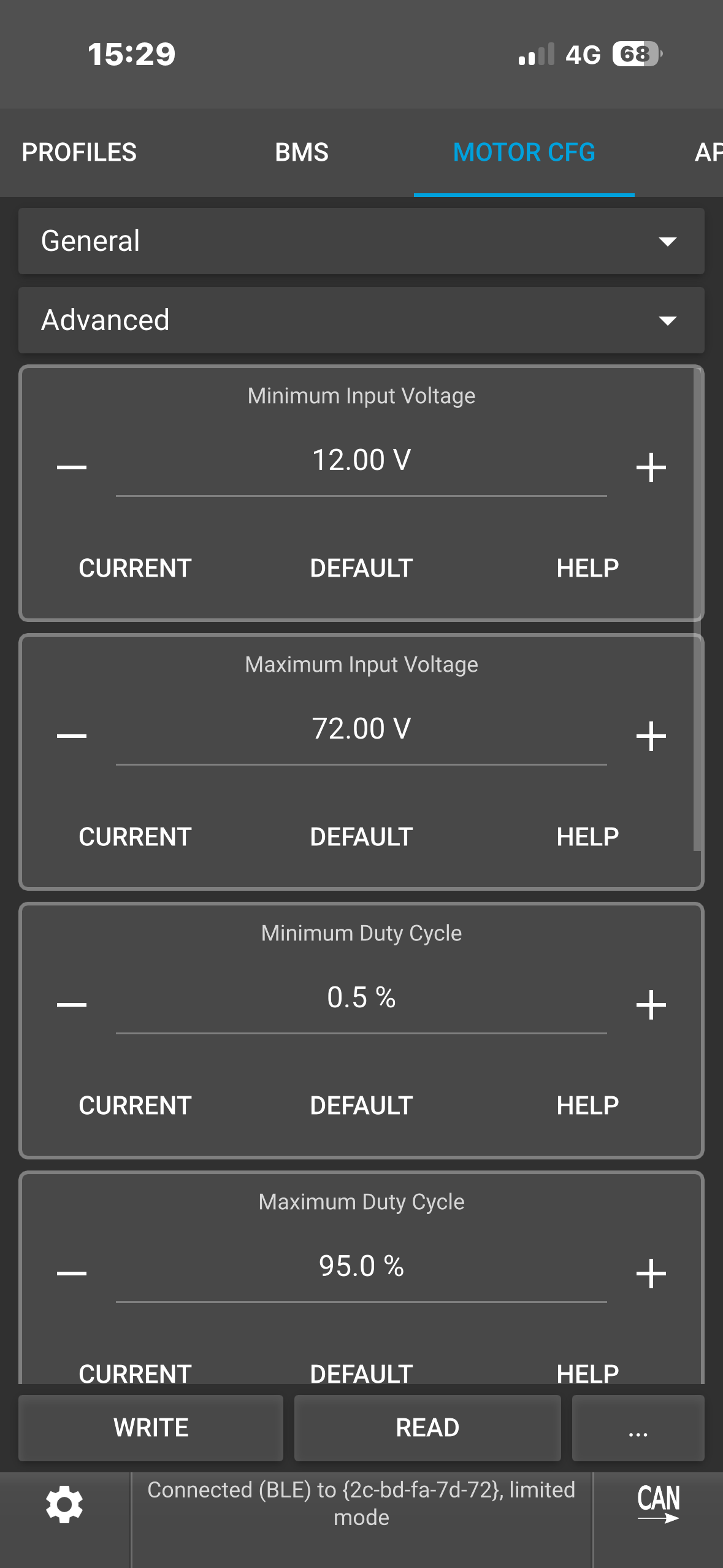

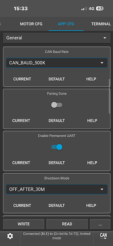

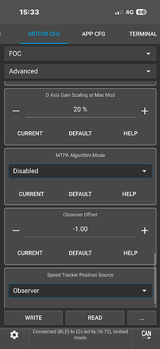

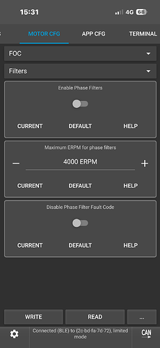

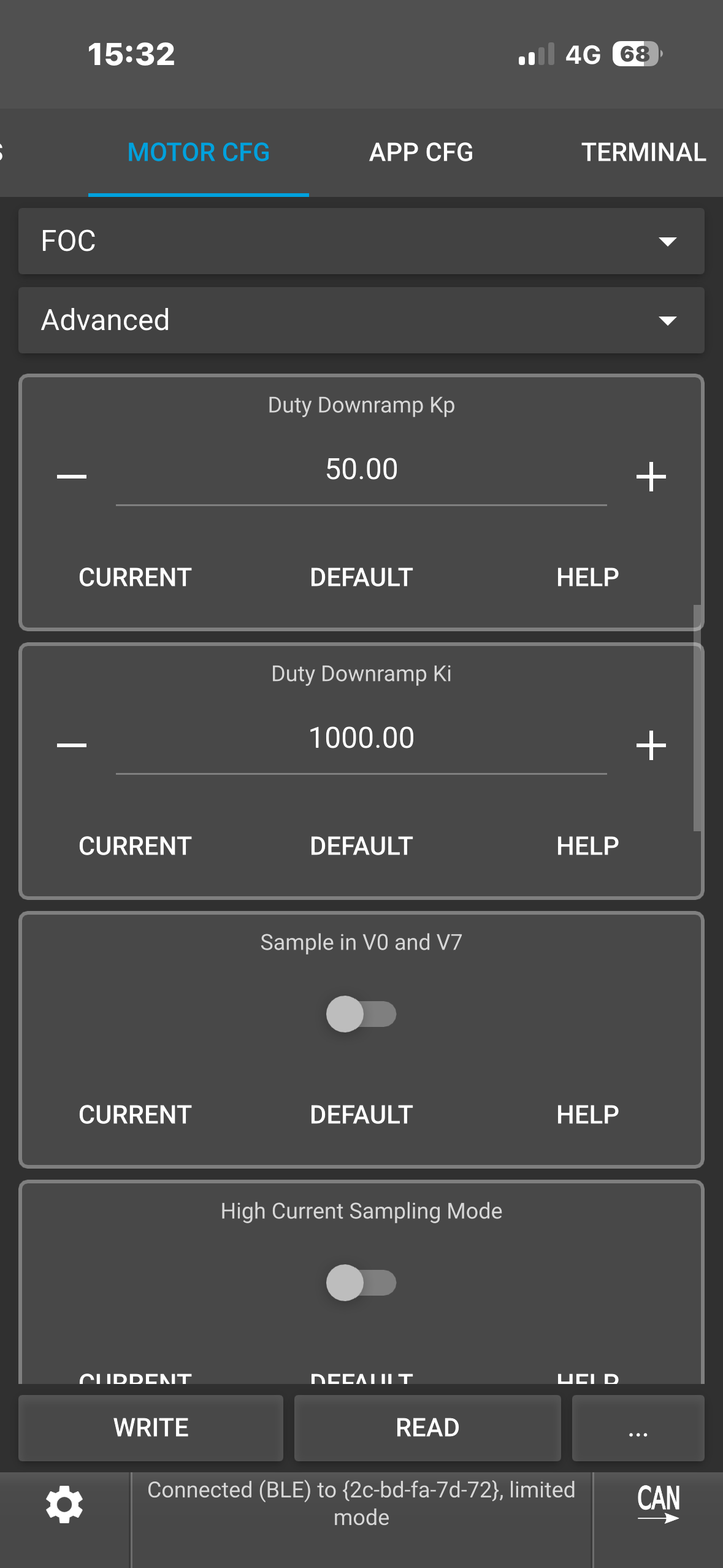

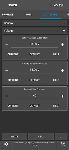

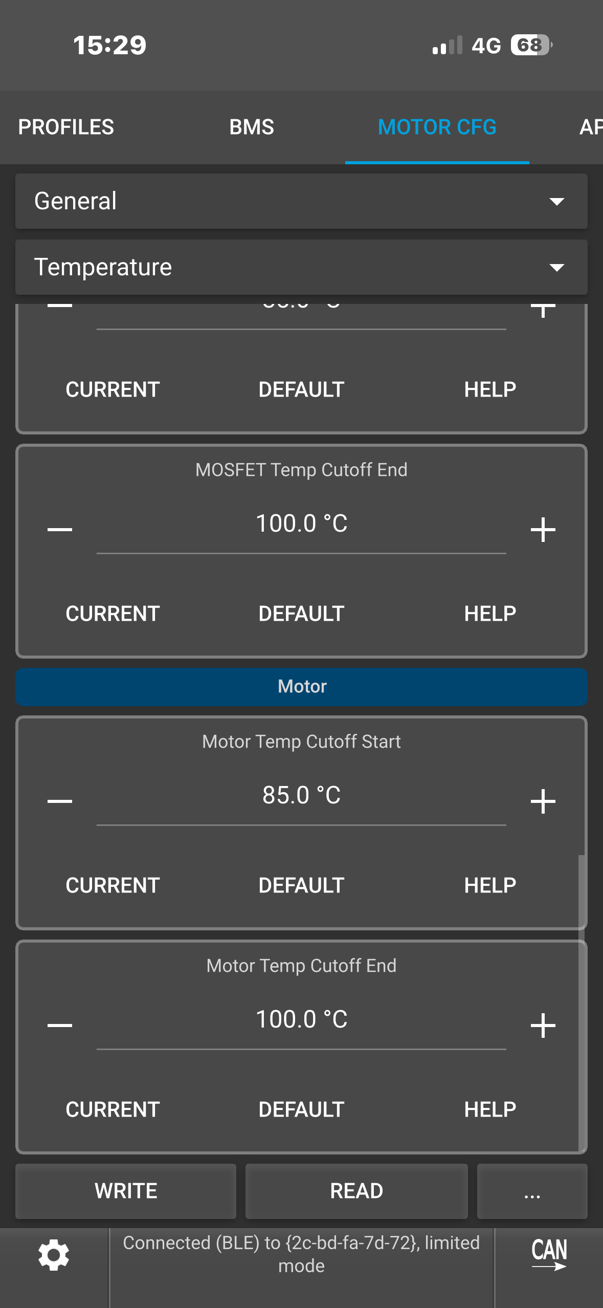

Here are my screeshots config :

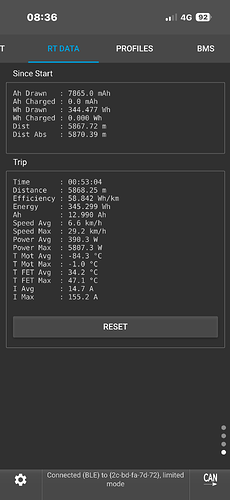

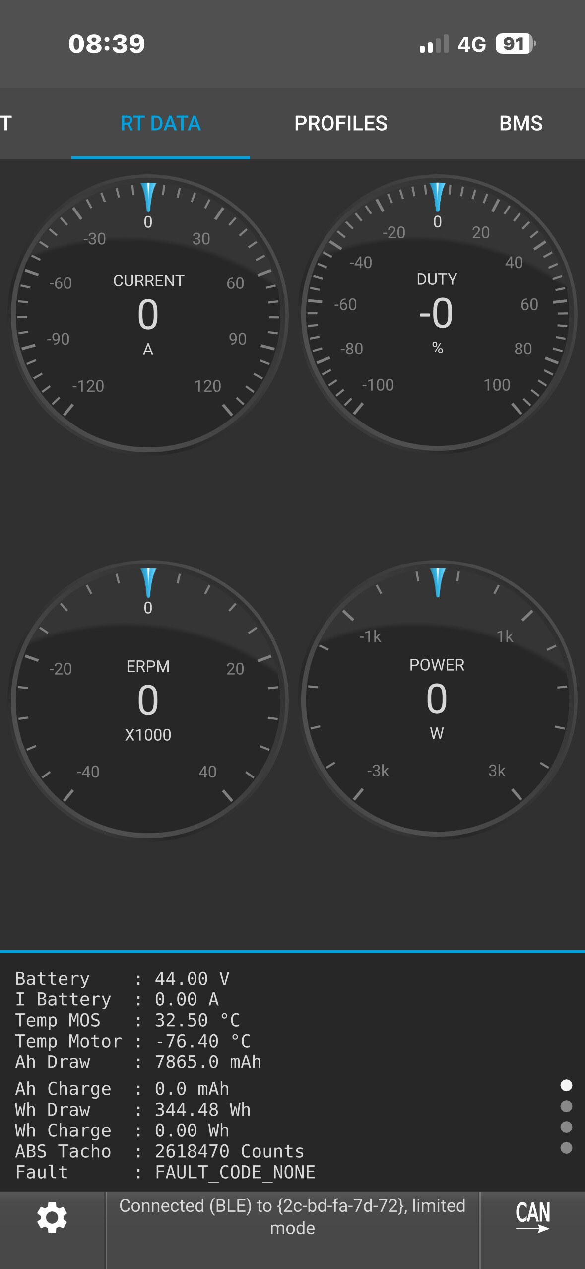

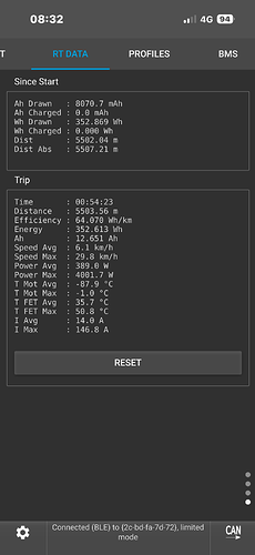

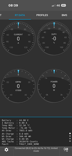

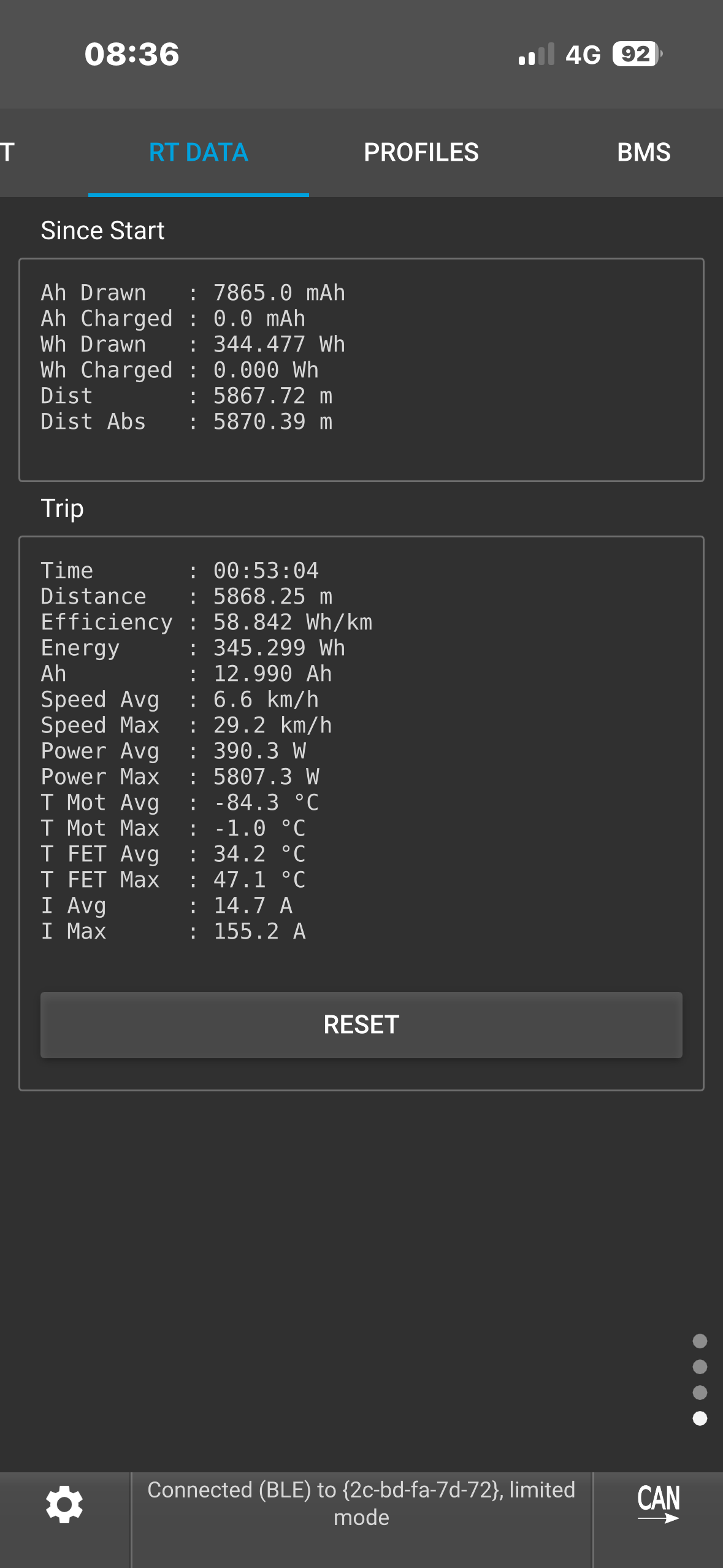

And there it is my RTdata with few cut off

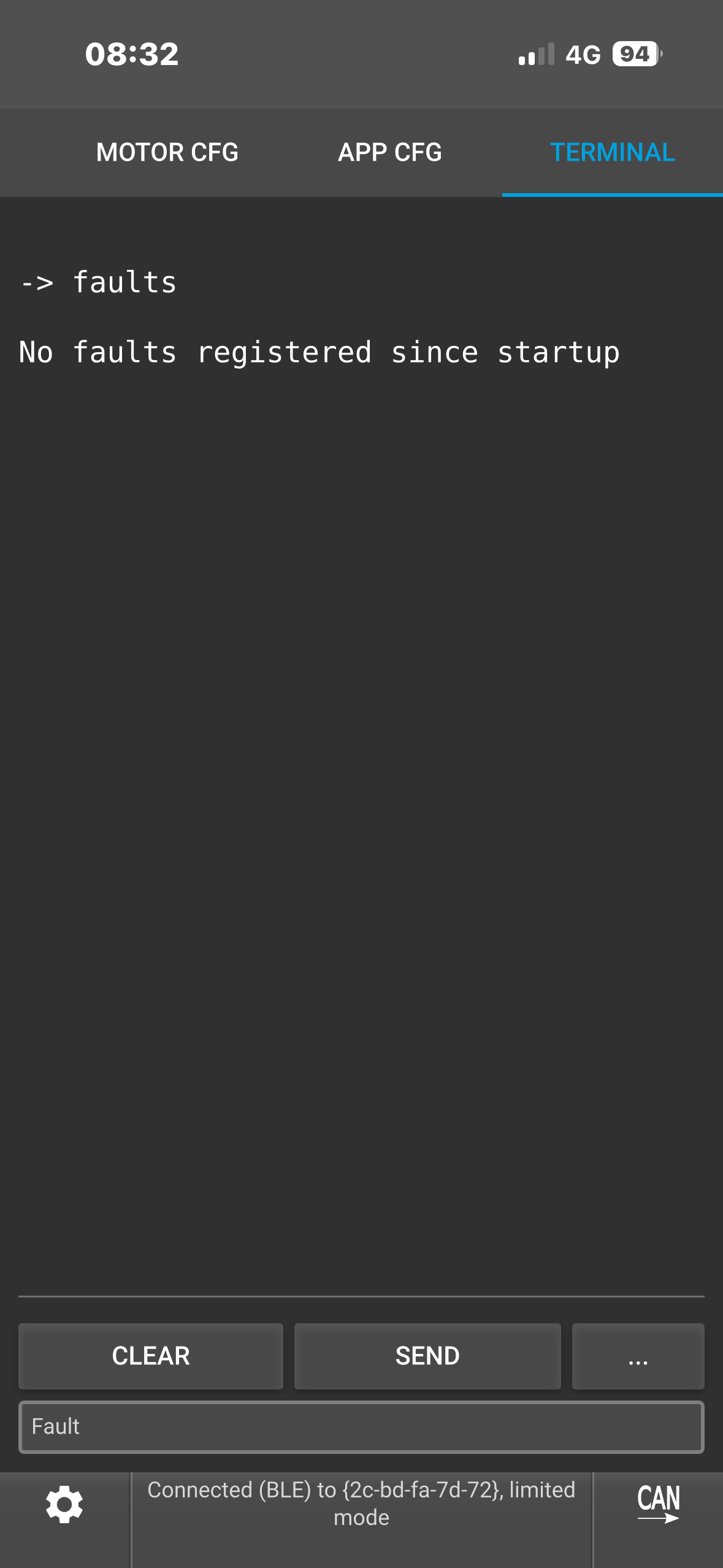

Thanks for the screenshots. This is getting a bit trickier–your RT data screens say that you had no fault code, but you say that you got cutting off in that session.
To confirm if it is throwing faults or not, can you try typing “faults” into the terminal after you have had it cutoff? This will confirm if we are actually getting any fault codes thrown.
I will do that next Time

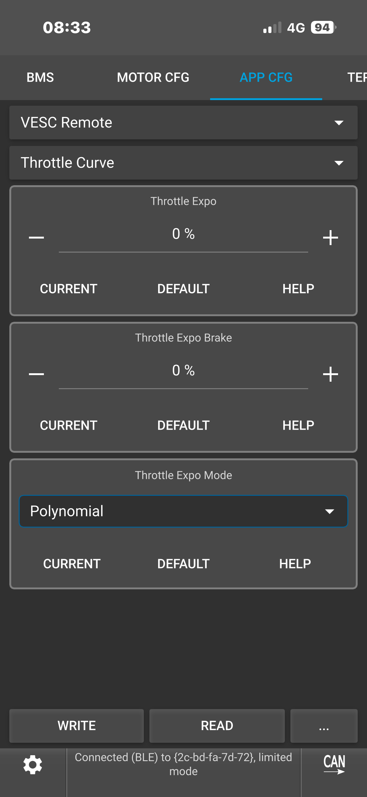

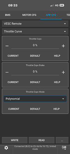

Why are you running exponential throttle? I run linear. I must dig out my vesc so I can get all the settings for you. Busy with a house move so its in a box somewhere…
With my old setup I found that I had more throttle for waterstart .
But maybe I was wrong ;

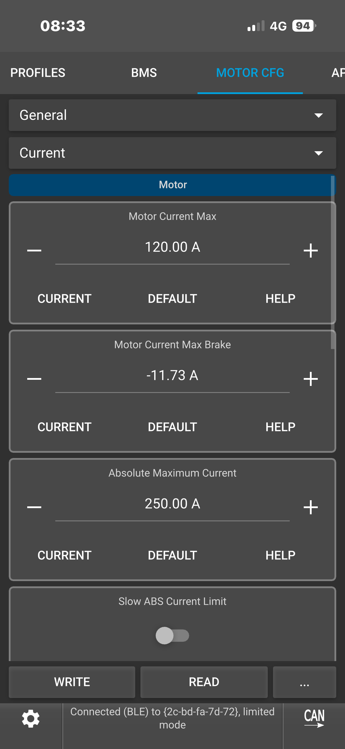

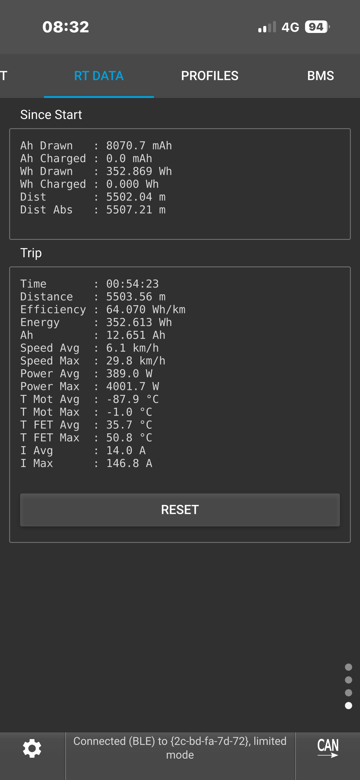

Today, I did three things. I lowered my battery current to 60 amps. I increased my absolute maximum current to 250 amps. I modified the curve of my polynomial transmitter with throttle expo at 0. In the end, there were no cutouts, and the peak current was monitored at a maximum of 146 A. I’m not entirely sure what caused it; I think it was my battery current that caused my peaks to drop below 150 A.
Is it possible that my batteries are the cause of these cutouts? I have two types of batteries: 12 S2P Molicel P42a and 12 S3P Samsung 50s.
I’d like a bit more power in flight; I’m just getting enough. What do I need to adjust in my motor current? Or do I necessarily need to increase my battery current?
