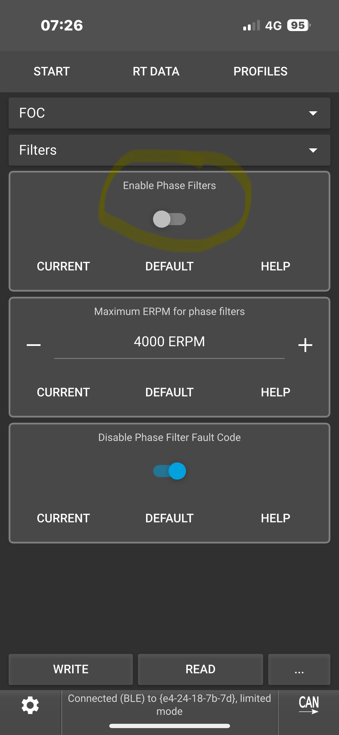

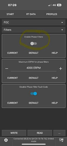

Is it this parameter that I have to turn off ?
Yes, if your HW does not have phase filters

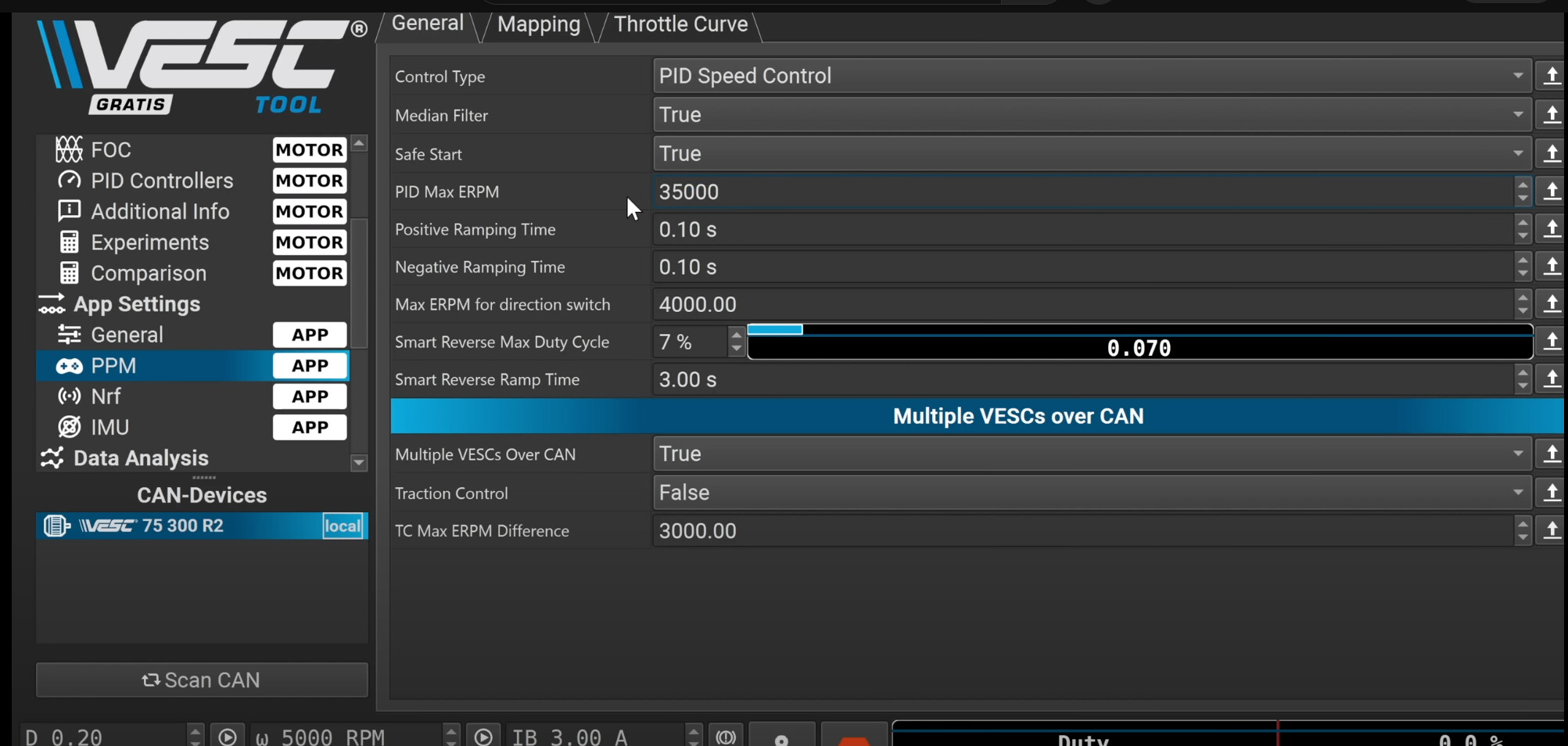

I just saw this video from RCtestflight, where changing PID Max ERPM seems to unlock the ESC for this type of use case. I have skimmed this thread, and it may not be relevant, or already mentioned, and I missed it, but just in the case that it hasn’t,
I saw this setting and thought about it, but when I had problems it was the motor ERPM that was the issue. I also read max motor watts can be a problem, but can’t confirm it was.
My setting is ‘sensorless’ so I didn’t have the filter problem listed above.
My VESC Tool and 72500 experience has been traumatic, but basically once I adjusted ERPM and maximum watts, all the other motor settings were as expected at 70 amp and everything else to 100 amp.
