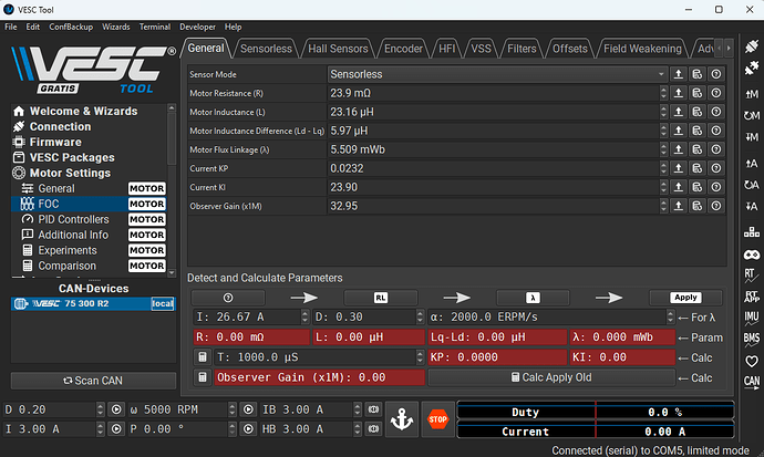

We should compare how the motor is configured and things like how many poles are used. The 6384 motor has 14 poles, I have mine set to that but may want to check that.

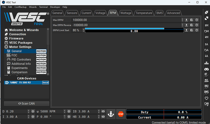

What is your setup on this screen? I feel like if these settings are wrong it will limit motor power.

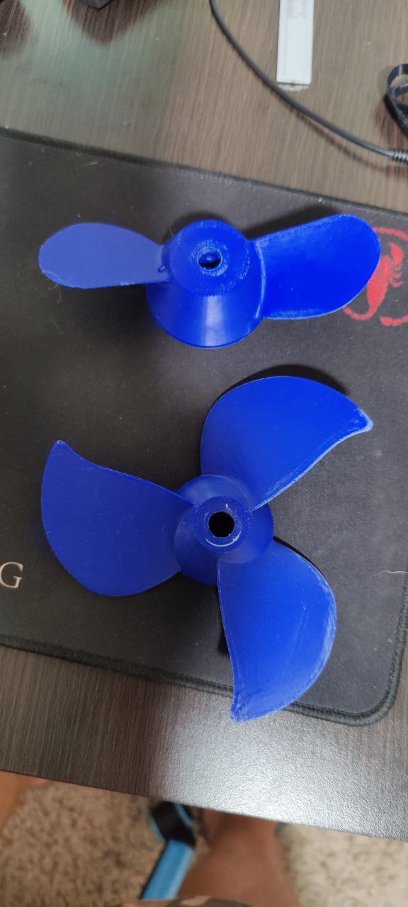

I have tested 2 props motionless in a pool.

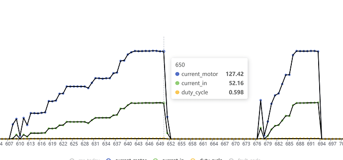

First - 3 blades, printed True Glide works OK and reaches phase 130A, battery 52A.

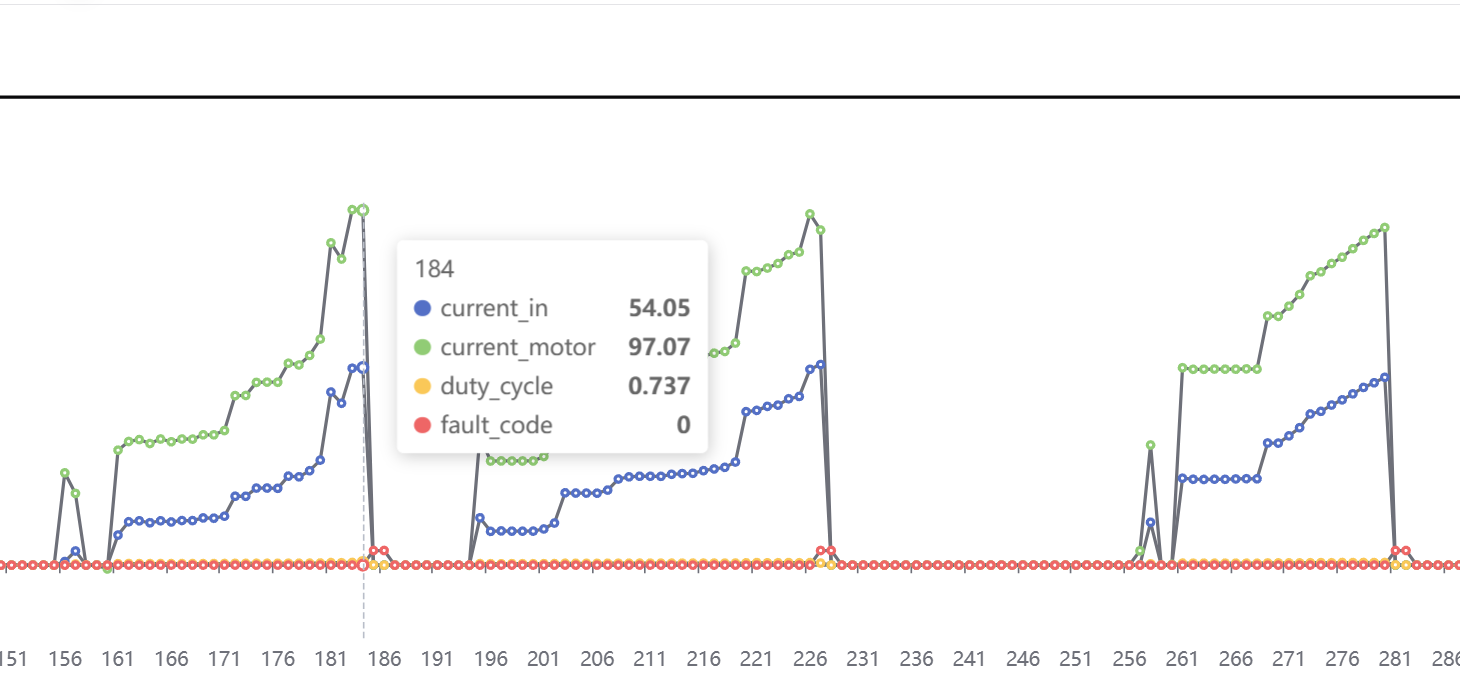

Second - 2 blades, printed V_S fails on 2/3 throttle with FAULT_CODE_ABS_OVER_CURRENT.
As we decided - it’s a firmware issue. I have installed custom https://github.com/casainho/bldc/releases/download/fix_noisy_currents-firmware_6.02/VESCs_fix_noisy_currents-firmware_6.02.zip

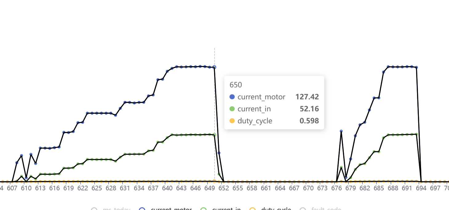

The 3 blades plot:
Downgrading to 5.03 fixed my issue. Reached 80A battery current (my limit in VESC), 3600W motor power without any problems.
