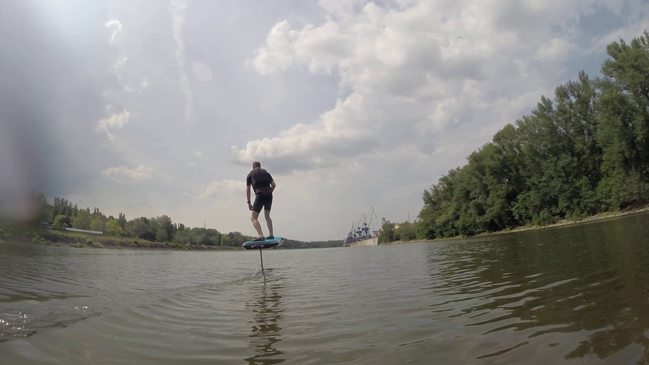

I had last week some leakage, now I have to solve this. The propguard, which you see on the picture, is a mistake. It reduces the thrust so much, that the board didn’t fly. I removed this, and the whole thong becomed a beast. Start foil on 60% throttle.
The other thing is the synclost of the ESC. I have to raise the timing to 15-20°. We will see.

Now I can say, that it works. Round hatch is everything but waterproof. Cost me this experience one switching electronic…
Timing can set to 25°, and this works. I have to mount a paddle on the front and have to buy a good safety vest becouse of the regulations in Hungary. But: last weekend I start to foil! It is a unique feeling!:grin:
My top speed was 31km/h and the battery last for a bit more than 1 hour (37Ah used).
