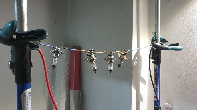

Other wise connect three 12V 50W halogen bulbs in series (36V, 150W) and set a timer. And then set another timer so you don’t over discharge the battery.

Will look into the 150W lightbulb jig. Any idea roughly how fast that would discharge a fully charged 10s pack? Ideally I would be able to use it to bring my 10s packs down to 37V and my 9s packs down to 33V. No idea what sort of time that might take.
my simplest solution
The math is is super easy,
Look for the Wh capacity of your cells, a 2170 molicel is about 15Wh.
Then 10S x 5P (if you had a 10S5P pack) x 15 = 750Wh for your whole pack.
At 150W draw it would be completely flat in 5 hours (750Wh/150W). So an hour on the discharger would be enough to get it down to 80%. 2 hours to 60%.

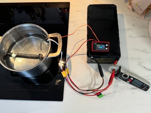

Hello everyone.
I would like to show you my simple solution for discharging my 10S or 12S batteries to storage cells 3,75V.
I got a 48V / 600W heating cartridge for this.
[https://amzn.eu/d/02L4xqY2]
[https://a.aliexpress.com/_EJOKPGx]
For the first test I set up a setup with 3L of water in a pot, a voltmeter, a current clamp and a temperature meter.
2
After everything worked very well, I got myself a small voltage display.
[https://amzn.eu/d/00GeCiWL]
The voltage display can be configured very easily. For 10s or 12s, I set the low voltage on the display. When the voltage is reached, a beeper goes on. When the discharge process starts, I set a timer.
5
