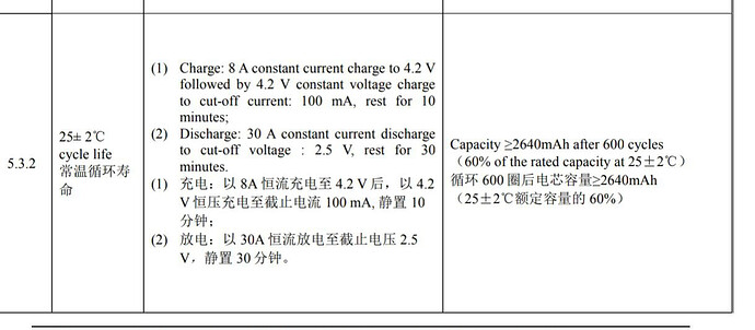

45D datasheet specifies 600 cycles up to 60% capacity when charging at 8A and discharging at 30A.
So charging 6s3p battery with M6D at 8A and foiling at max 90A will be under this rating.
Most of the time the current is probably half that, so can expect more % left at 600 cycles.
I wonder if charging at less current will help much…
