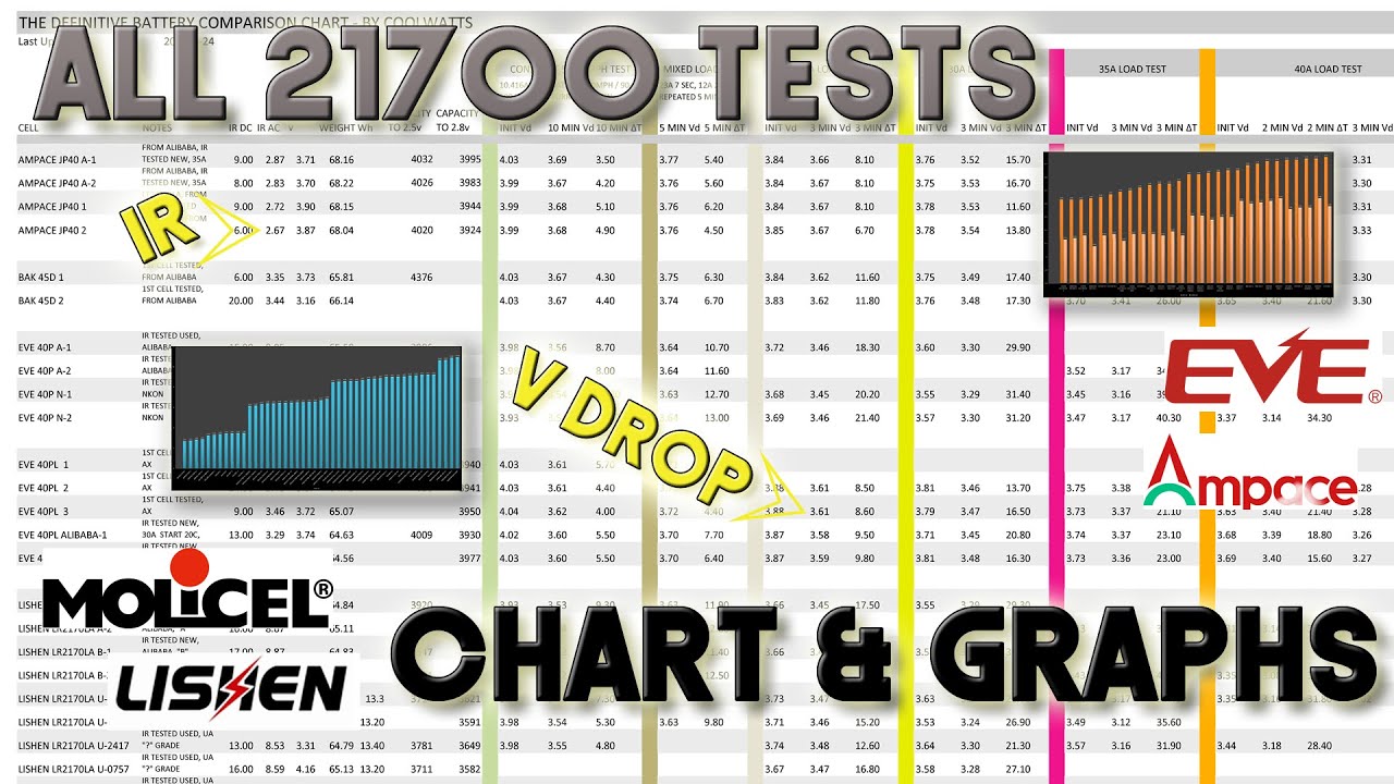

It is tabless cells, therefore the low resistance, here a video with tests and comparison of high current cells:
There is also a link with an excel of the results under the video on youtube.
wow, that is a whole lot of data…
And it varies from sample to sample…
His dc result for 45D is different from my sample.
As a matter of fact, depending on consumption of foil assist, we may search for a cell with higher capacity even at expense of resistance.
Like when using 3p or for low power conditions as in
'Foil Drive Assist, DIY - #1676 by s9tim
In the above comparison the highest capacity is 50B and 50S.
Currently BAK does not have an equivalent for 50B.
And there are higher capacity cells, but with higher resistance in the market.
