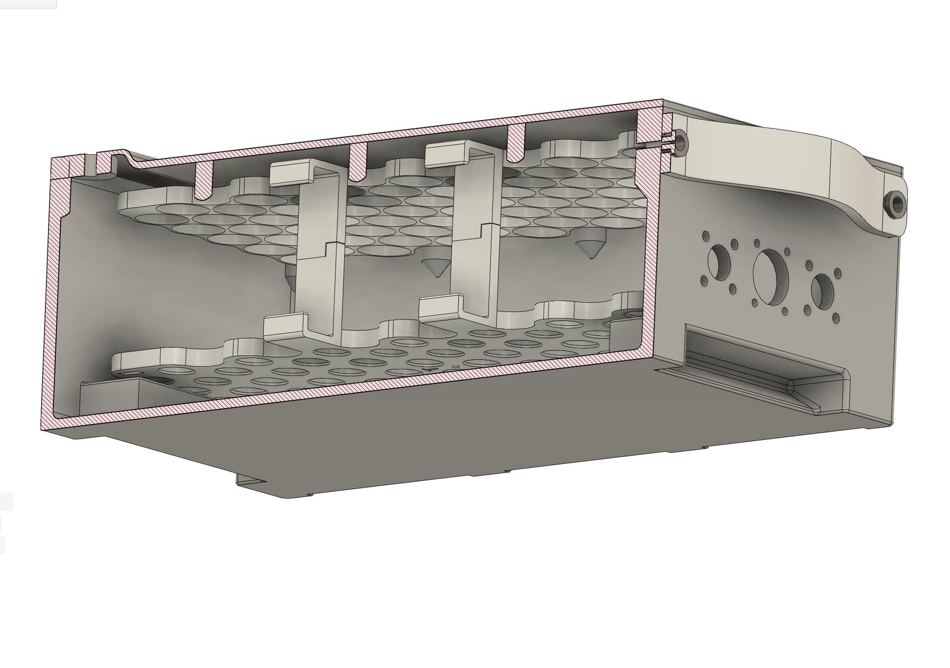

Hi, I’d like some advice on which container to use for my E-foil. I’m designing the battery (12s10p) and would like it to be as safe as possible. I only have the classic 65220 cables (2 positive and negative poles, UART, PPM, and USB) to plug into this container. Then I’d like to attach it to a thread on the rear straps that I don’t use.
I have the same motor, can you tell me more about it? Did you already test it out?

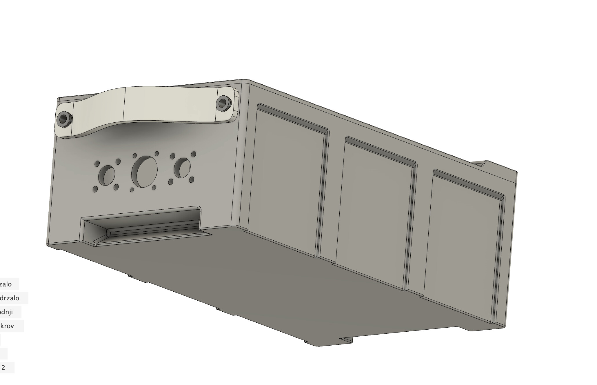

I have a 3d printed PCCF battery cases that will be done at the end of January. You need to connect just two Amphenol plugs (plus and minus) and one 9 in connector from Aliexpress. I will update with more pictures at the end January. The case should also fit up to 14S 7P and in there you should also have RX receiver and BMS and kill switch (via tubular reed-switch on off)
The case itself should be fully waterproof (polymer liquid waterproofing required) but i will keep it in the battery compartment that is also waterproof by itself.
Fantastic, my printer prints up to 250mm, I have already purchased the various connectors, and I have a standard battery configuration.
