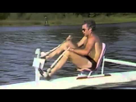

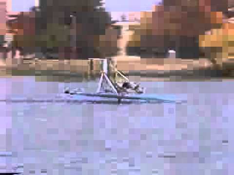

The world record for human powered water craft was a hydrofoil using an air propeller. The Decavitator was the brain child of MIT professor and aerodynamic genius Mark Drela.
Decavitator
In this report by Scientific nAmerica, the water propelled Flying Fish 2 was slightly faster than the Decavitator.
