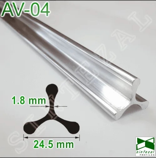

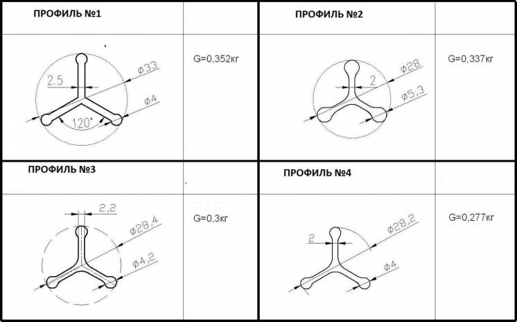

PS:
The section stifness is dependent on the moment of inertia, comparing solid 30x30 vs 36x36 3mm thick tube then tube is already stiffer than the solid profile at a third of the weight. there is a lot to be gained by a larger hollow profile (at increased drag).
But it’s been discussed regarding the interfaces from mast to fuselage and board. If this is not totally gap free then the mast stifness is secondary.
