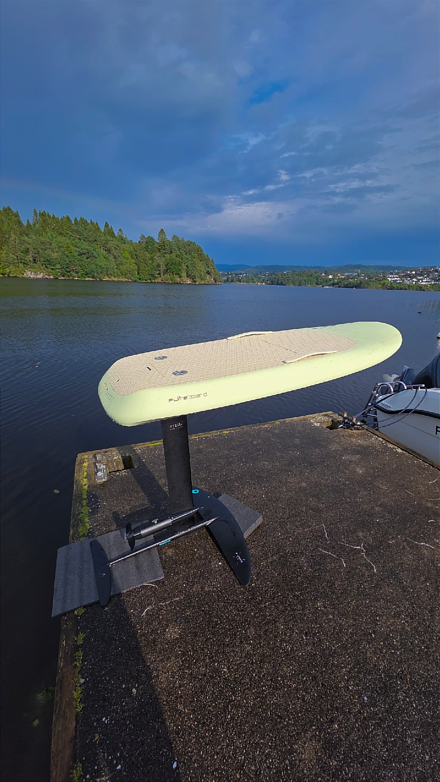

Board setup is:
Board: Fliteboard Fiberglass Series 5 Yuzu 100l
Foil: GONG | Foil X-Over V3 - Alu 85 - Aluminium / L / Black
Adapter plate: Was lucky to grab one of @Kian 's last adapter plates
Motor: Flipsky 65161 120kv
Motor mount: Self made from acetal. Based on designs found online.
Vesc: Makerbase 75200
Remote: Flipsky VX5
Battery: 14s1p LGe65b cells.
Battery case: 3D printed and laminated. Aluminium lid.
BMS: 30A from FluxMotion (Charge only)
Propeller: Fliteboard.

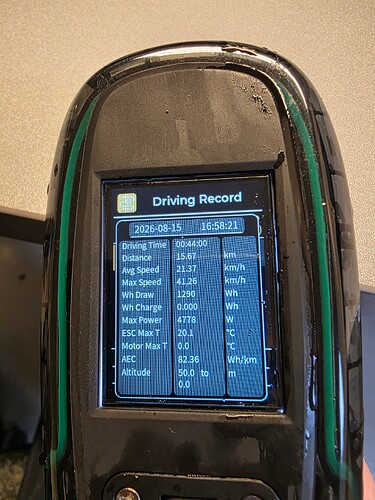

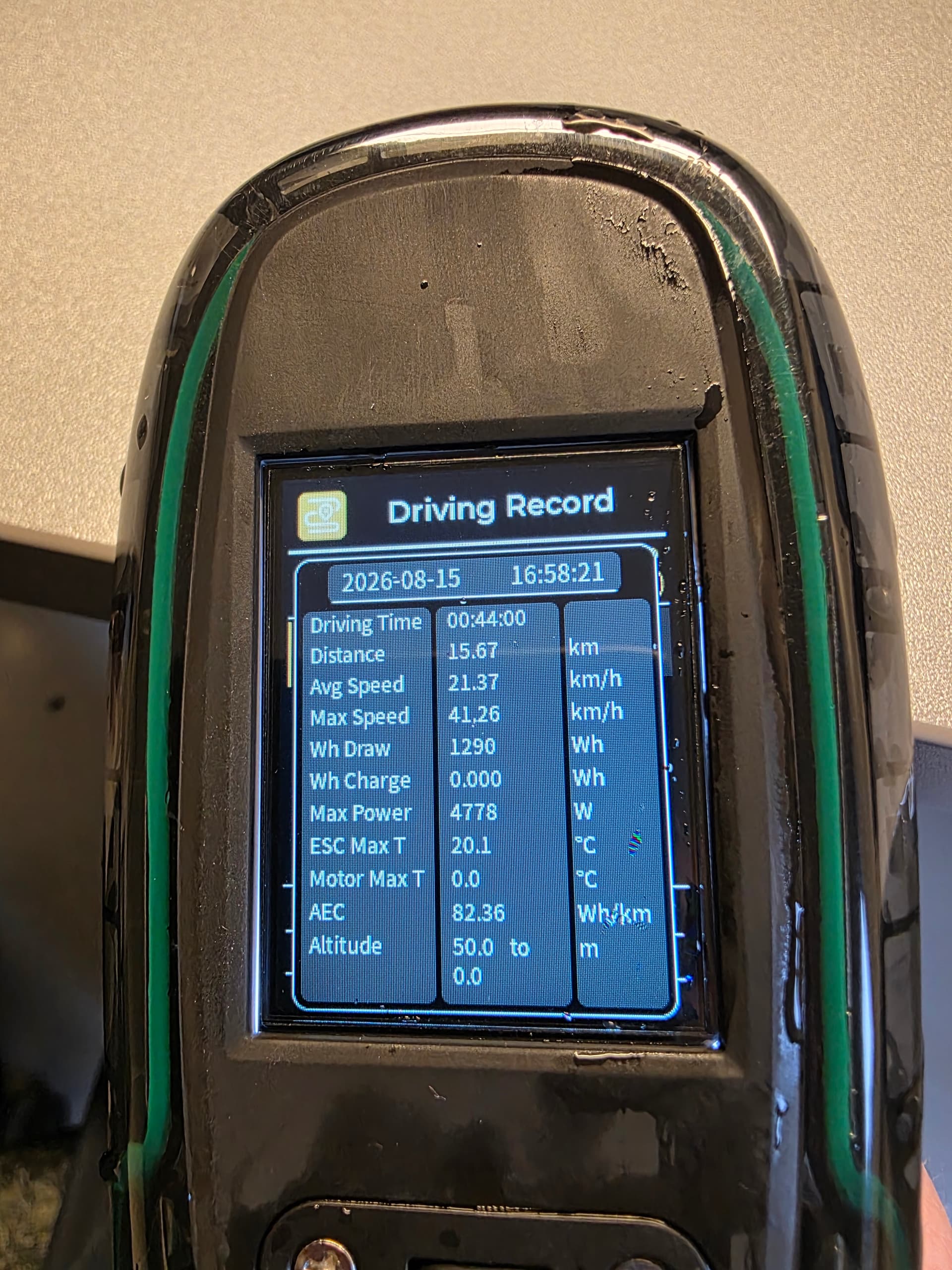

Whats the most efficient Wh/km you managed with which size front wing?

The only number I have is the 82wh/hm that my remote reports.
