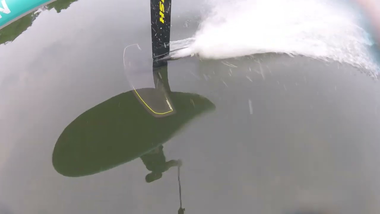

Seems your propeller is cavitating almost the entire video, which propeller is it?
I think the proximity to the surface is sucking in air until it deepens a bit (there was a point in the video where you could it it running slightly deeper).
If I remember correctly he’s using a Flite prop.
Don’t think so, checked more thoroughly and it starts at the mast so probably needs some smoothing at the motor mount
This is a Flite propeller, but it’s not cavitating. Previously, it would draw air through the mast and the small gap between the nose cone and the mast. To fix this, I sealed the nose cone with a hot glue gun, and now there’s no more air reaching the propeller.
So this video was before you fixed it i guess.
It’s not really a good example to show propeller air suction when you are sucking air through the mast at the same time.
Absolutely, you got it.
This is an example that breaching isn’t so bad.
Here’s the vid after I fixed it up. Dropped this one today.
