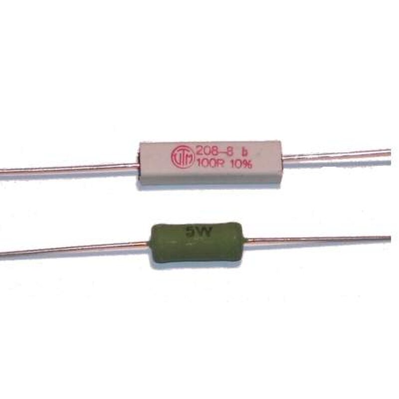

I would use a 10 Ohm resistor, at least rated for 3W

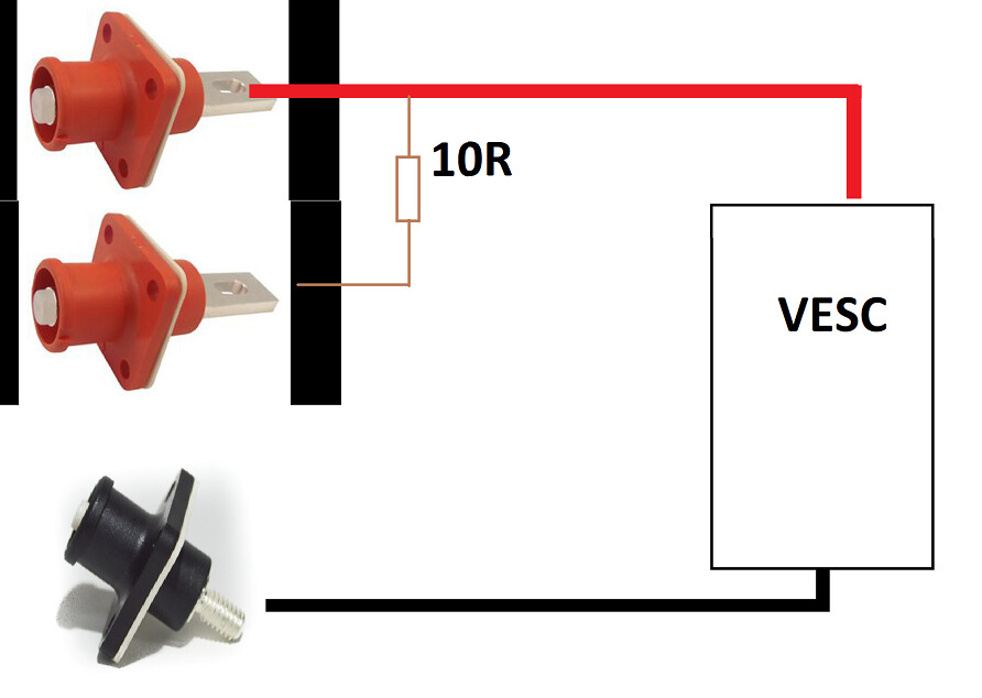

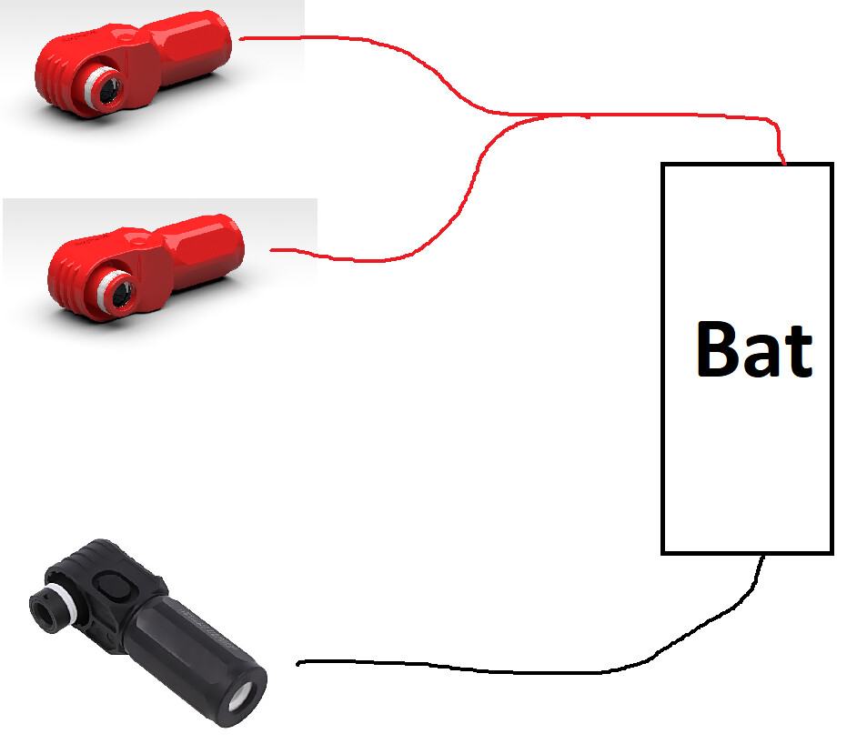

So using the 3rd surlok plug method, you basically have 3 mated plugs in total (one neg, two pos), where one neg and one pos are connected to the battery, and another pos is just connected to a 10 Ohm resistor?
When connecting the battery, you first connect the neg, then the ‘false’ pos with the resistor, and then a couple seconds later disconnect and plug into the ‘real’ pos? Do you have a picture as to how attach the resistor to the surlok (or of your setup)?
Thanks in advance, just trying to better understand how this works.
You just keep the false pos plugged and additionaly plug the pos
No need to unplug the false pos at any time (except when you want to turn off / take the battery out of course :smiley: )
I don’t use surlok anymore, but I basically just solder(screw) the resistor between the false pos and pos terminal…
(You can of course swap the male and female parts)
I see, makes total sense now - appreciate the drawings Ludwig!
