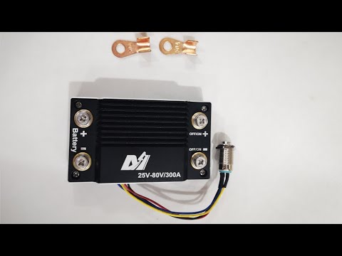

Anyone using this, it’s new in from flipsky I think.
Yes I’ve been using this for a few months now. It works well.
The little button is far too small, need your pinky to activate it. I recently ordered a few more of them but had them add a 22mm button instead. I should get them early next week.

I also ordered something like this and want replace the switch with a magnet switch. So you can attach a leash to your ankle
@louis apparently cutting power to the ESC under load can damage it. It may be worth further research before setting your switch up like this.
This switch is NOT waterproof. I had leaking into my ESC box from this switch!
I tried to buy it from Amazon and they sent me the wrong one (lower voltage)… twice! Instead of goofing around with it, I epoxied a dual pole rocker switch into the battery box and encased the back side in epoxy, wiring it directly to the power switch on the 75/300. It came out great, fully waterproof, but is very permanent.
Looking forward to the 75/300 feature enhancement for the dead man’s switch.
The switch in your link is rated 20A, have you tried it?
Sorry, this switch is not in-line with the power from the battery. It is connected to the power switch on the Trampa 75/300, so there is no current going through it.
Ah ok, that makes sense.
Did you have any problem with the button leaking and do you know what voltage the switches are ?
