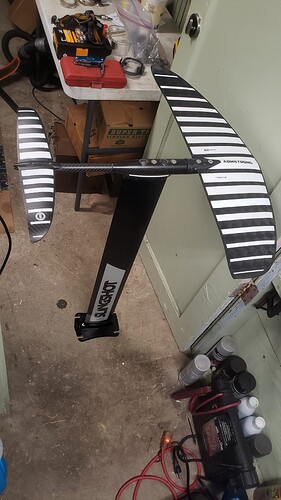

I used a unifoil hyper 190 on my Axis 19 mast this weekend, but the adapter took 1h to make as it is just a wedge, not as much to brag about.
The hyper 190 is really to big for E-foiling, but it’s my most efficient foil yet.
Trying to get down to 60wh/km, but it seems tought with my 100kg+ and the 200L board.

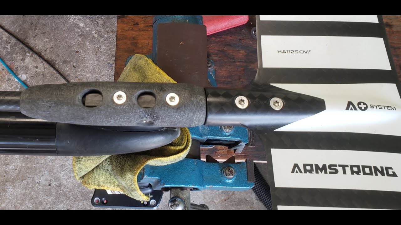

I finished a rough cut of my armstrong to slingshot adapter. So far so good!
Hope to test it soon.
looks awsome. cant wait to hear how it works. Will have to be on the hunt for broken armstrong mast.

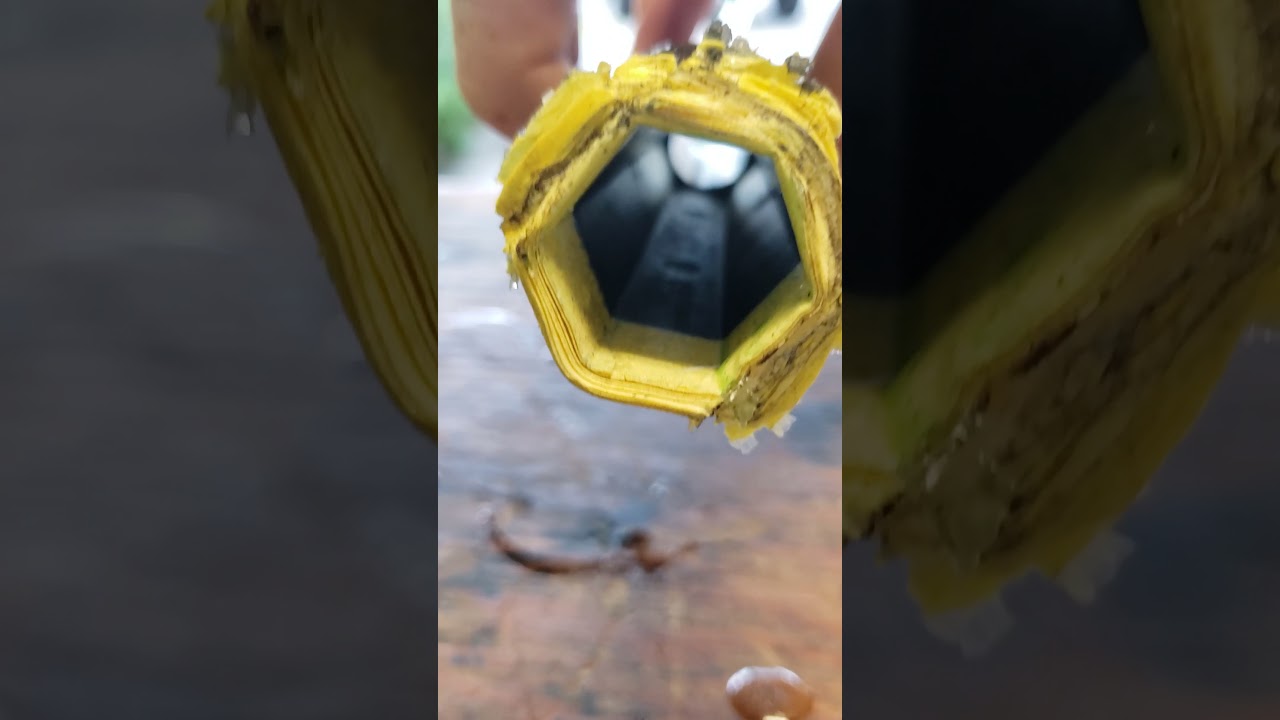

After a few rides my adapter broke.
I tried to take the easy route making this adapter. And it was a $300 failure. But, it did work as a proof of concept.
